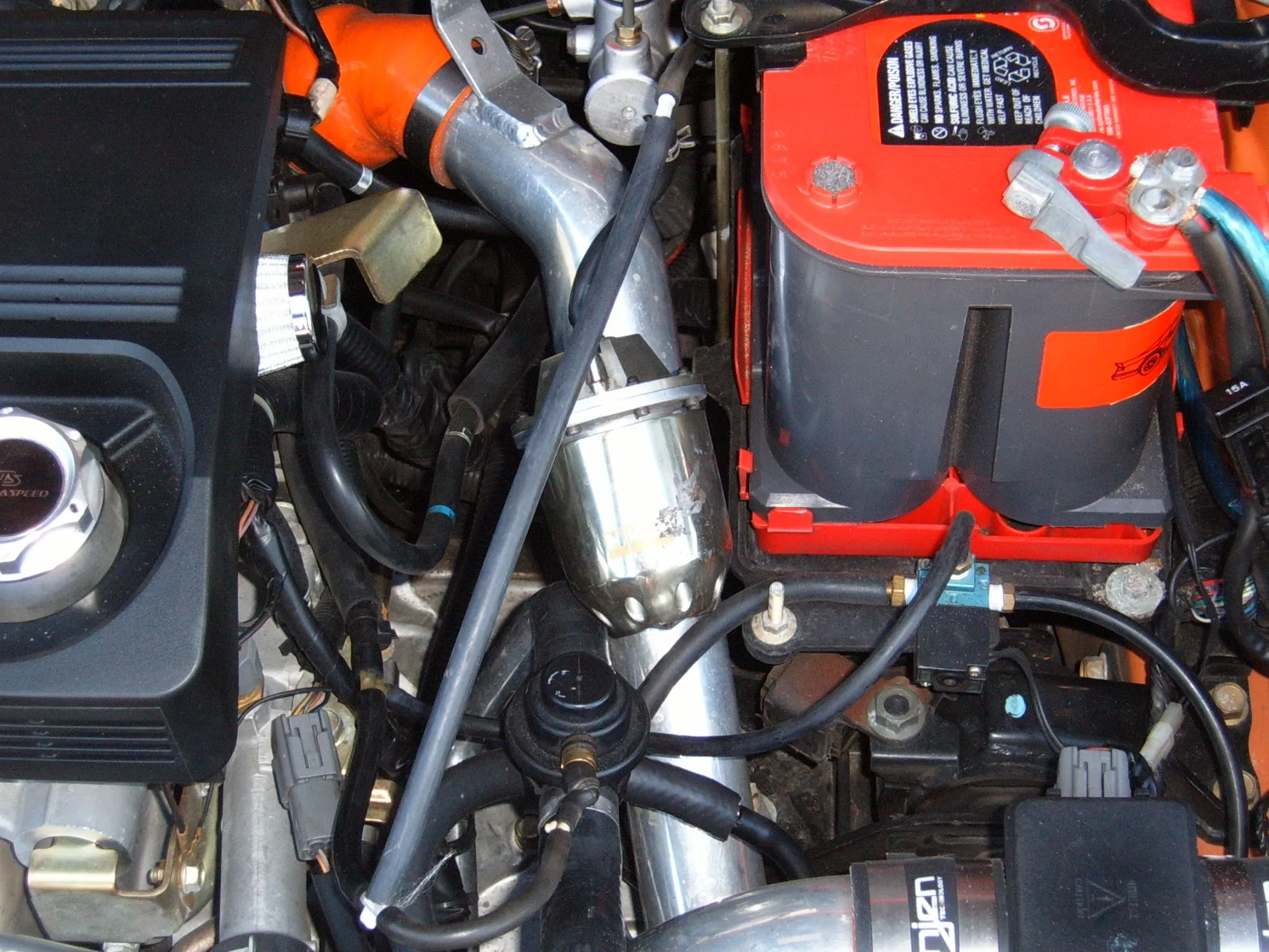

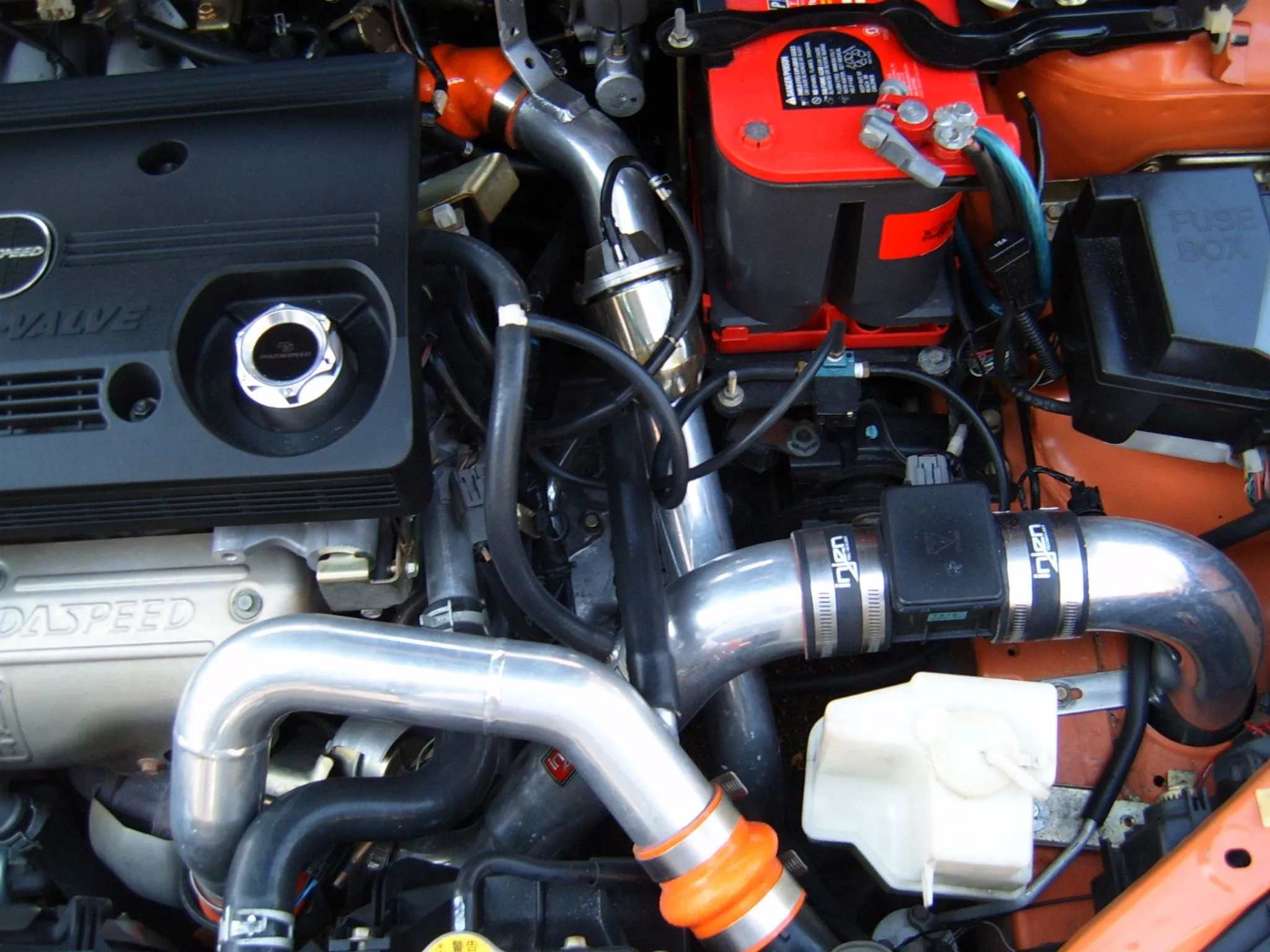

I Reinstalled My Stock Bypass Valve And All Vac Lines, But When I Go To Give It Gas My Boost Gauge Goes Pass 15psi And It Jerks Real Bad And Wants To Shut Off. I Cant Post Pics Cause It Says That There Is Problem With The Forum. So Anyway Of Fixing This A Right Way? Oh And I Have Turned Off My Unichip Boost And It Still Boosts Up Dangerously High. FIRST PIC IS MY OLD SETUP AND THE SECOND ONE THE NEW ONE.

Look at the vacuum line going to your wastegate and see if it is cracked, missing, or broken.
IF your wastegate isn't opening at the right boost level because of a leak, or being absent altogether, you will overboost. 15 psi on a stock engine is not good, it is cutting fuel which is why it feels like it wants to shut off.
Well In Another Thread I Was Told It Would Be A Good Idea And Not Make My Car Run Like s***. And It Did Make It Run Better, But Way Too Much Boost!!
