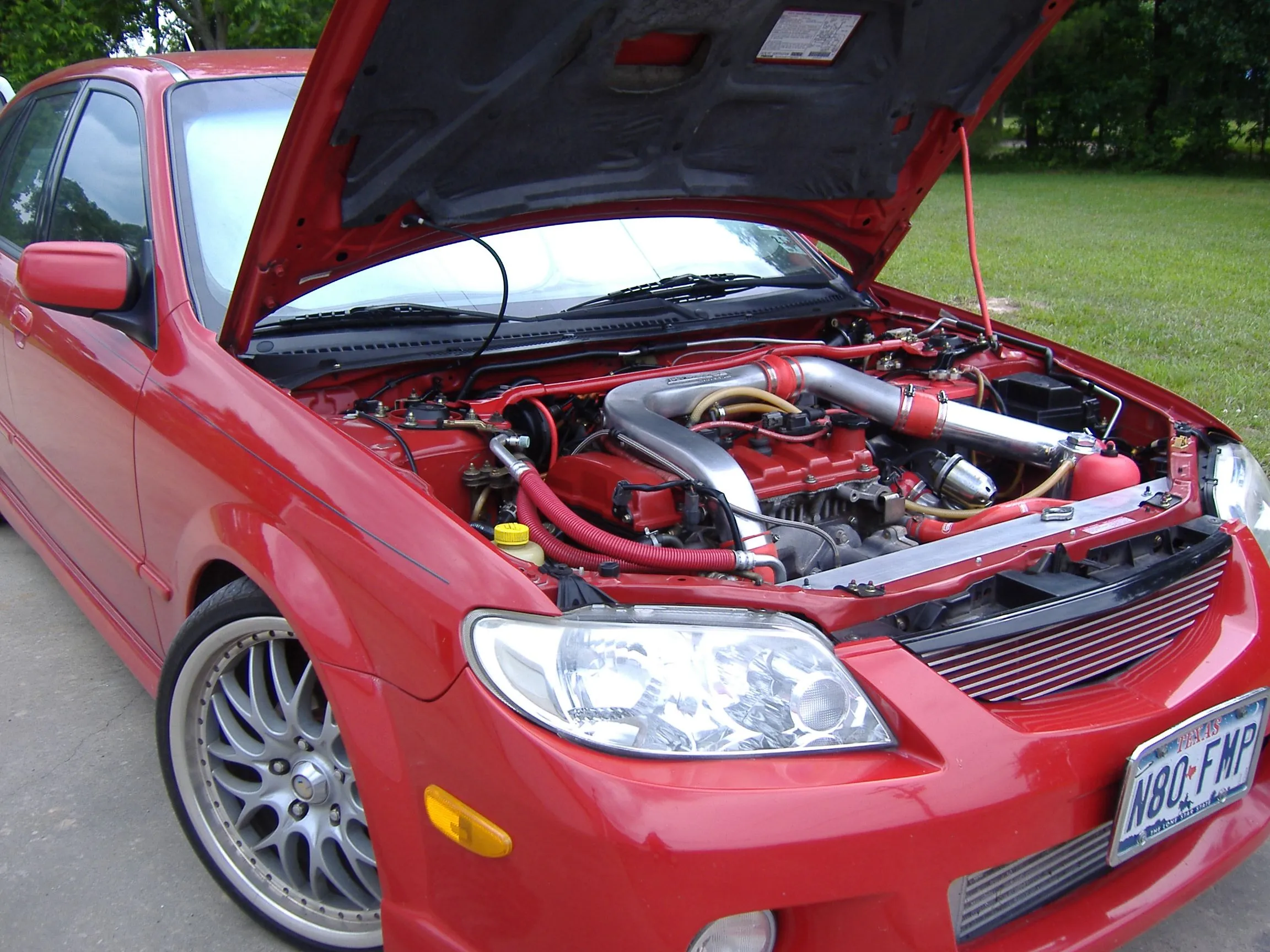

Turbo is the only real power adder for these motors!!
Hiboost FTW 260+/- torque
(burnout)

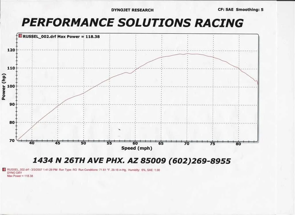

I have a INJEN CAI, NOLOGY plug wires, Ractive header that has been ceramic coated by jet-hot, MAM highflow catted midpipe, Magnaflow cat back exhaust, Fidanza light weight flywheel, light weight 5ZIGEN rims and a MP3 ECU.
With all that I'm at 118.38 wheel horse power.
118
-95
____
23 WHP gain.
Any math majors on here?
If 95 WHP = 130 crank HP. What is the crank HP of 118.38?

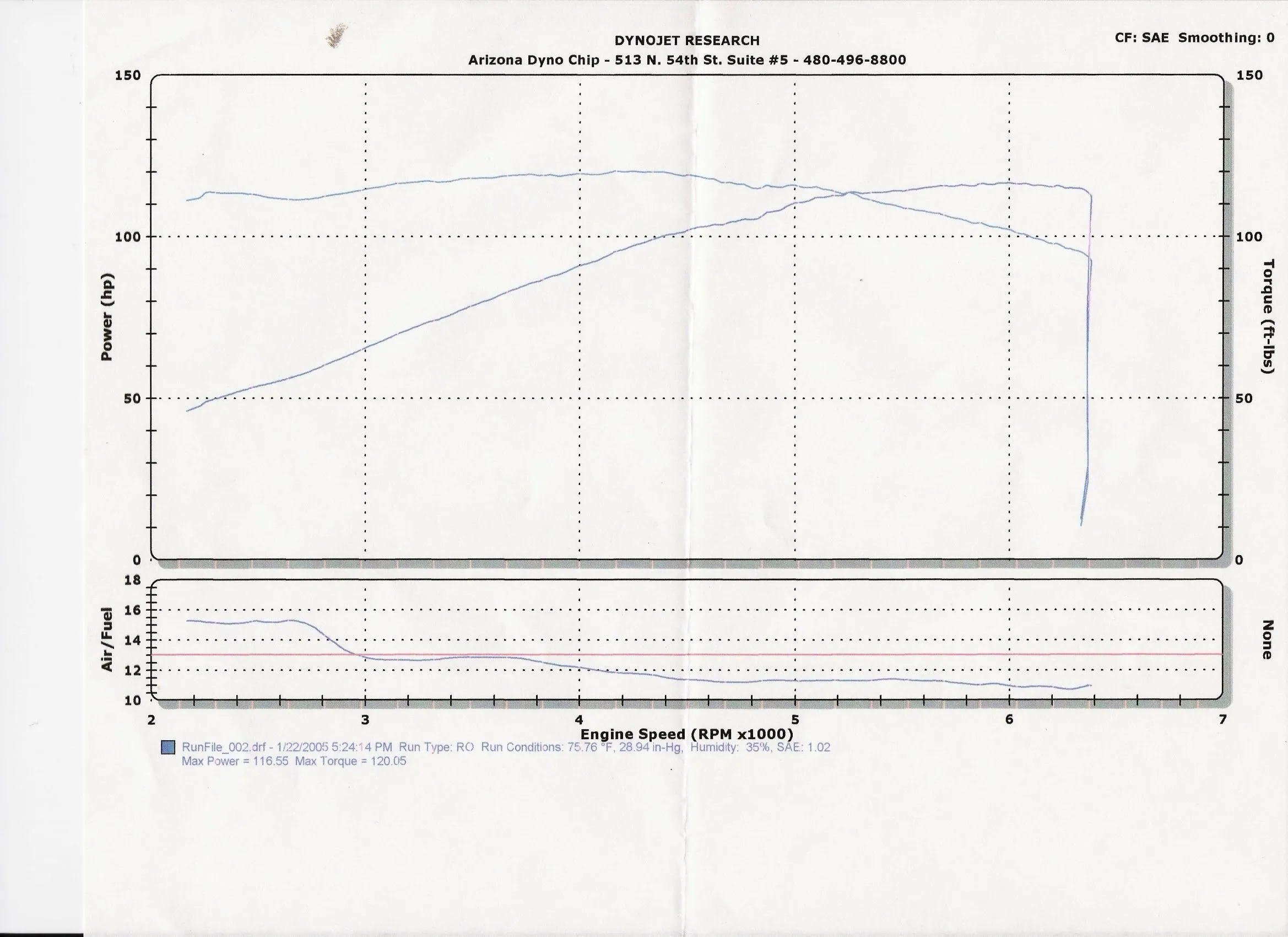

all my mods are in my sig...116whp/120tq
I haven't dyno'd with cam gears set to -3 and the new axle back.
161.99 crank horsepower by my math. (not a math major though, figure it's just ratios)
95 118.38
130 = x
95x = 15389.4
x= 161.99
never bragged about my math though...
