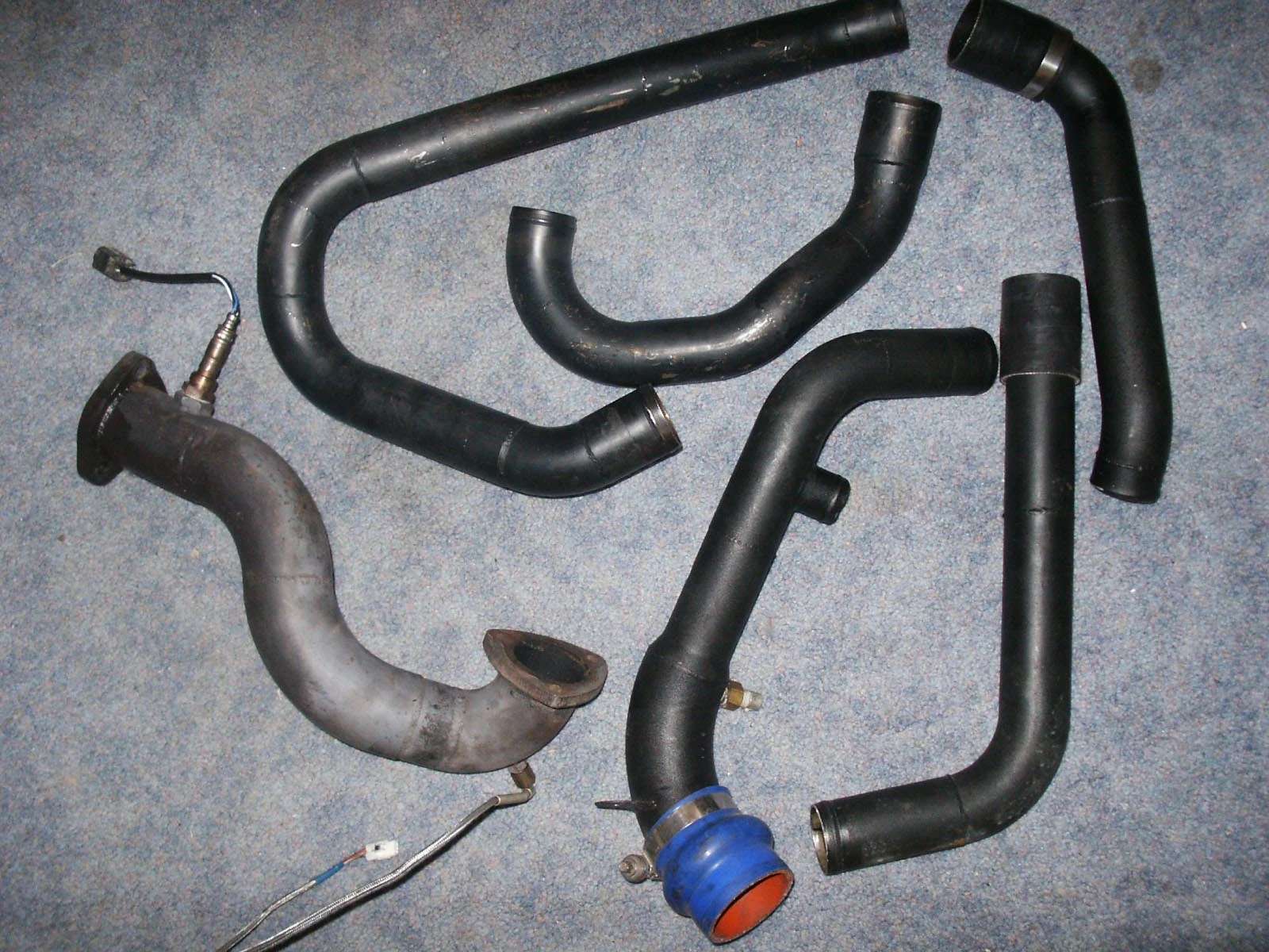

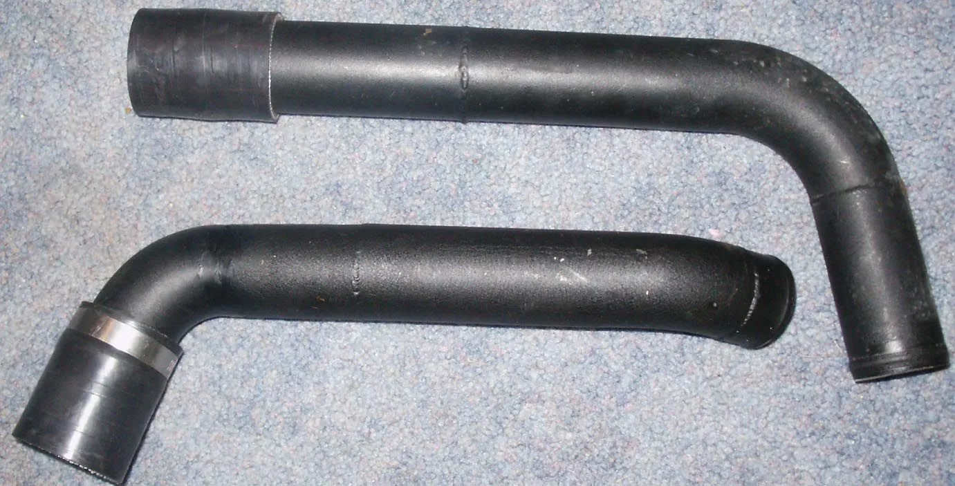

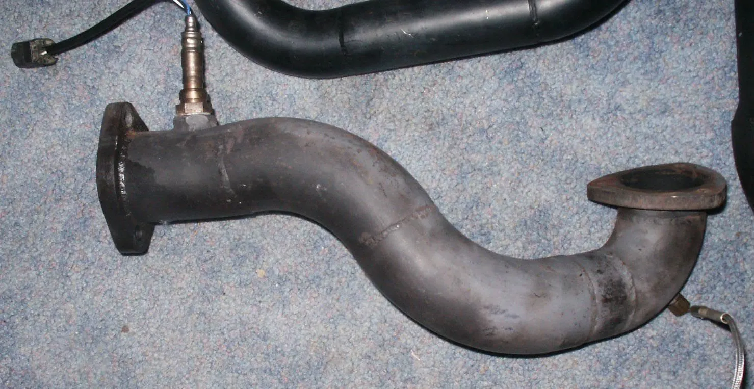

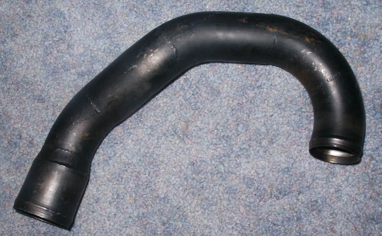

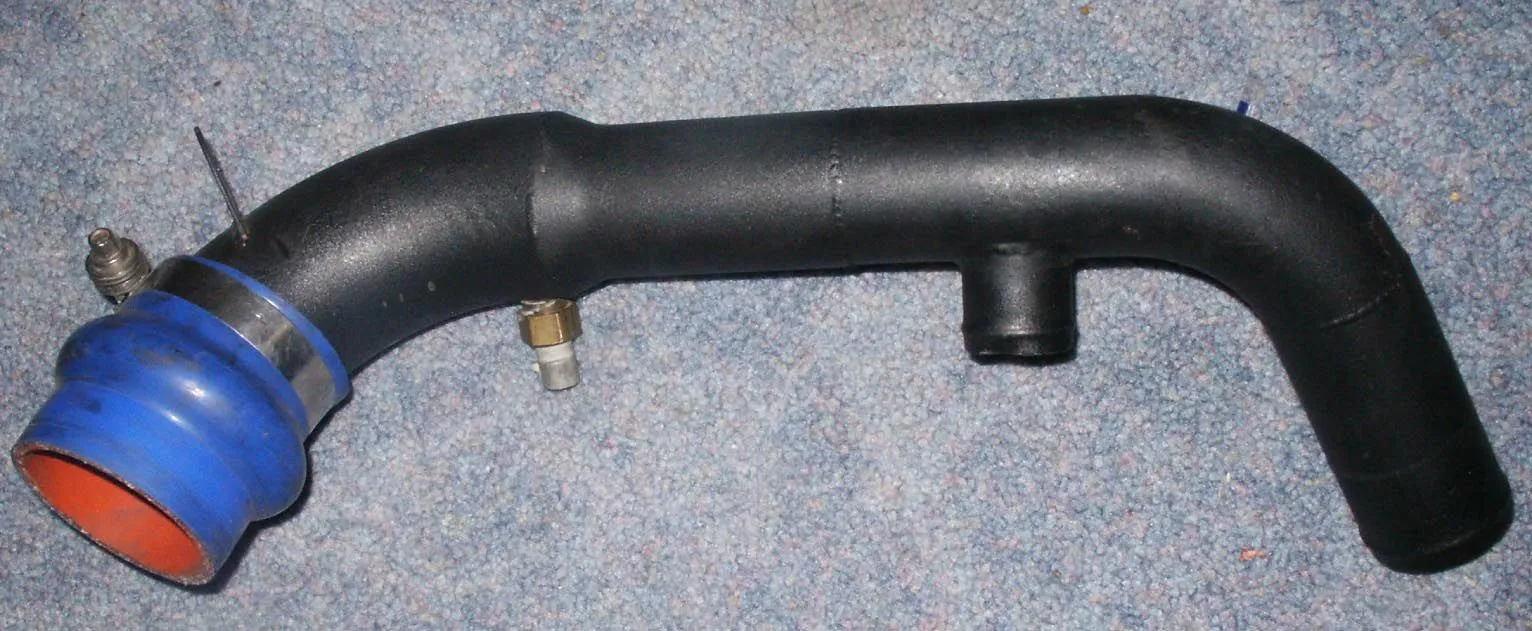

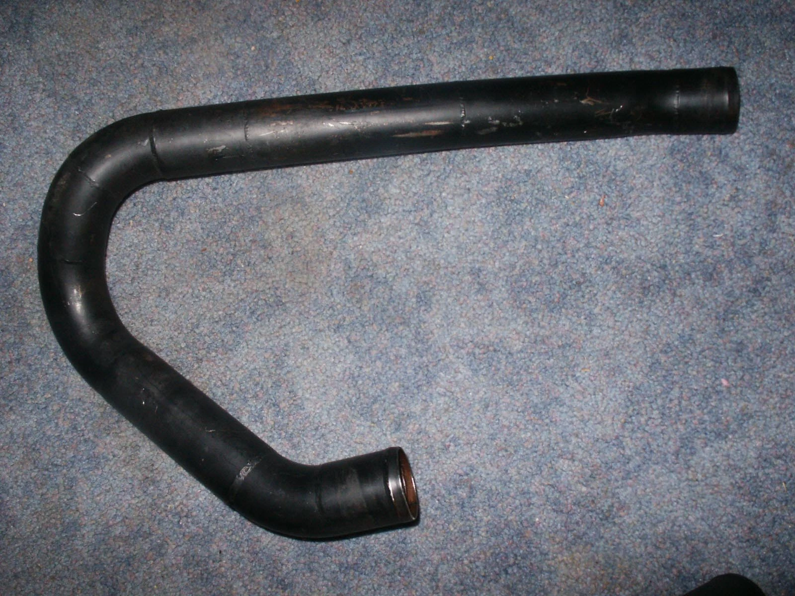

Here are the pipes that I recieved with my turbo. Let me know if you recognize any of them. They are all different than the ones I have seen in pictures for this kit.

starting from the left, 2nd pic in;
1) downpipe from turbo exhaust outlet to j-pipe
2) intercooler pipe, turbo to intercooler
3) throttle body inlet pipe, flange for bypass valve
4) intercooler pipes, intercooler to throttle body pipe
was there a small one with a neck on it? thats needed for the MAF sensor, bypass valve recirculaton and turbo intake side.
nope no pipe with a neck, those are all the pipes that were with it. Except the rubber radiator hose.
