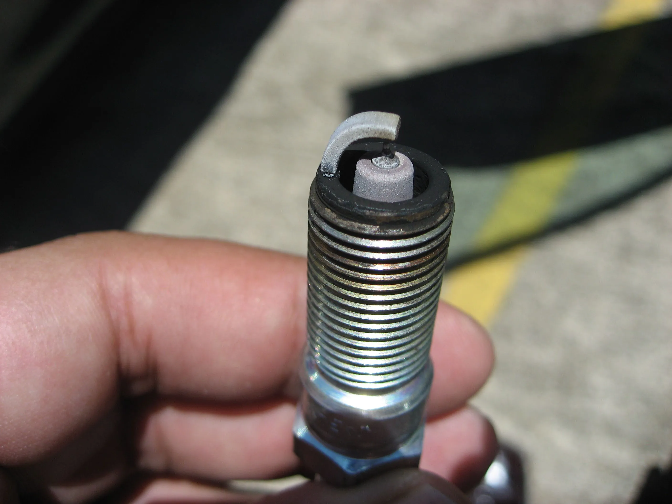

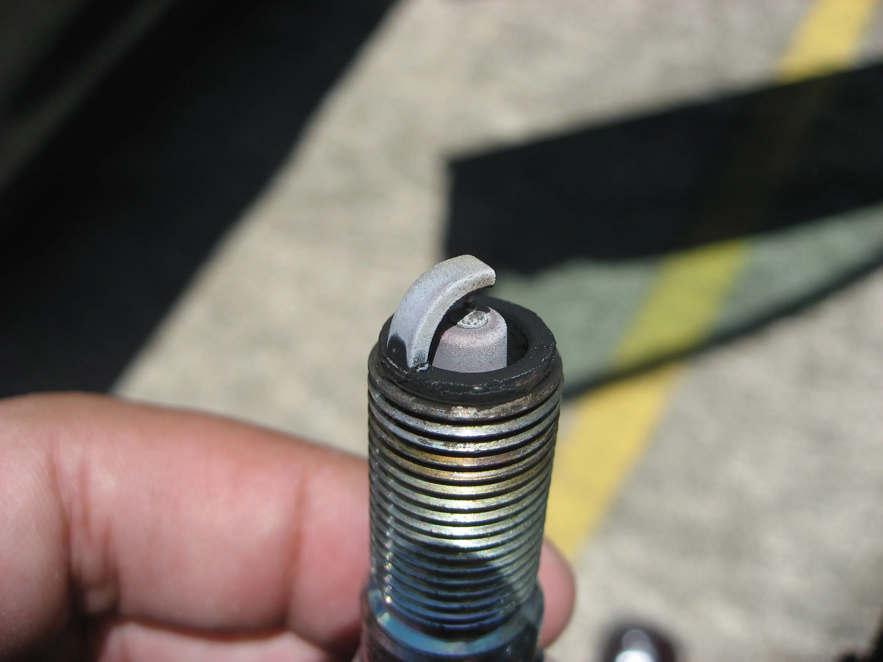

Well here is a pic of one of my plugs. All four of them looked like this. These are what was in the car before I cahnged them and they are NGK's. I checked the gap and it's at .30
I only have 29k miles on the car right now

The pictures you posted are representative of a plug with 15-20k miles of normal use and no neglect. You could probably get another 15-20k miles of normal use out of those relatively easily.
