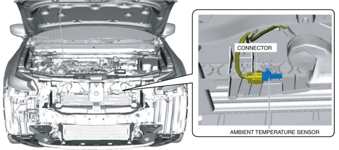

Question: Does anyone know where the external car temperature probe is located on the car?

Most temp sensors in cars are located behind front bumper, lower down. Often it picks up road heat, which causes it to be higher then the ambient air temp, not from the car itself. Re: the radar, I would think it would be tested to operate within the the norms of cold areas and hot.

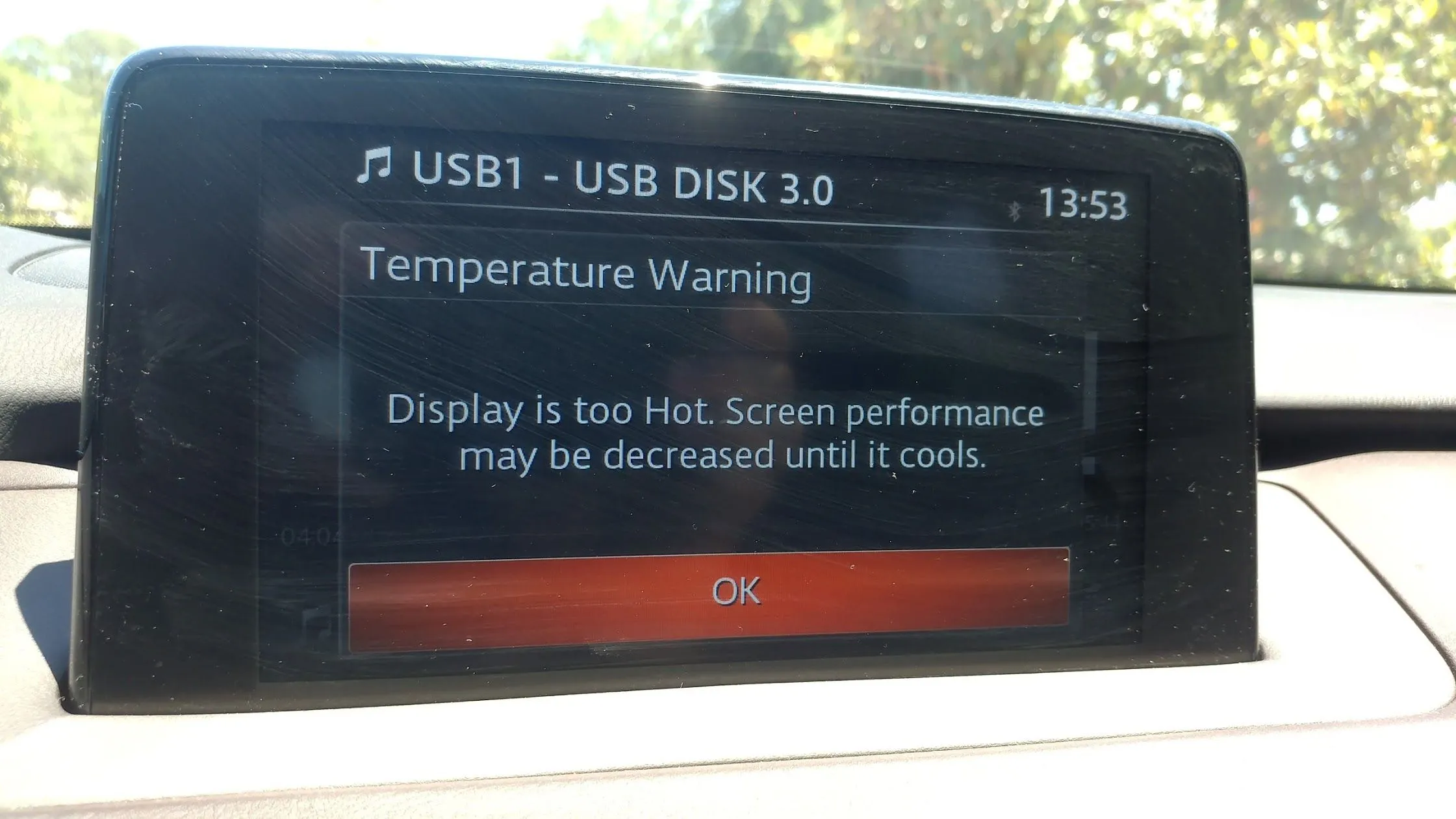

Only had the car since November, but the display seems to be failing at higher temps ... will have to see what happens in the summer.
I saw when I first purchased my vehicle. Hadn't seen since I tinted the windshield. I know you shouldn't have to do that but, it has been said on the forums before, the windshield draws in lots of heat.

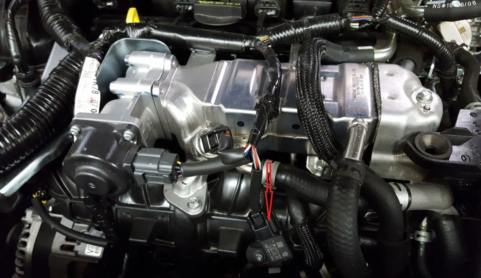

Where did tou get this pic?!
Can you locate the intake air temperature sensor ?!
Is it on the manifold or in the MAF
Hi Ali,
The 2016 CX-9 has 2 IAT sensors. One is called "MASS AIR FLOW (MAF) SENSOR/INTAKE AIR TEMPERATURE (IAT) SENSOR" which is located at the air cleaner cover. The other one is called "MANIFOLD ABSOLUTE PRESSURE (MAP) SENSOR/INTAKE AIR TEMPERATURE (IAT) SENSOR". This one is located on the manifold. Both seem to be easy to access.
