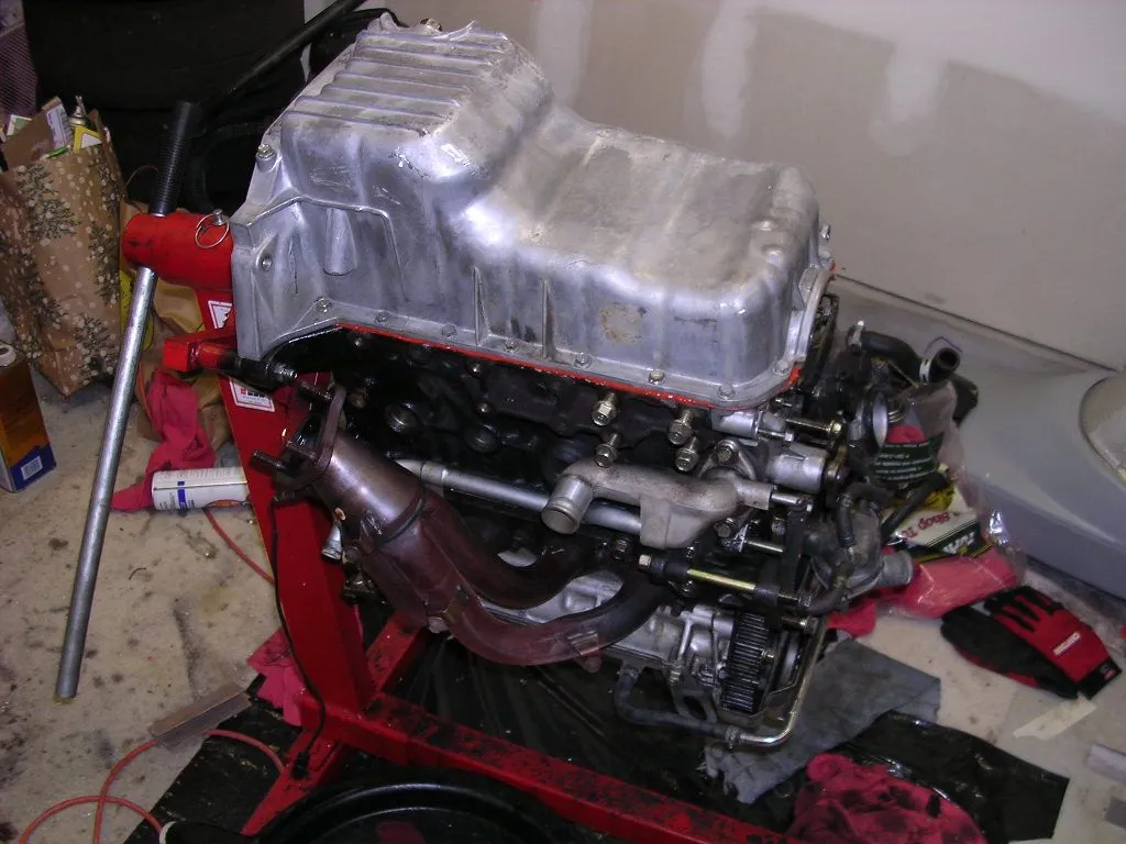

If you're not looking for performance, the stocker might work for you. It is a tubular header in a 4-1 configuration. The collector is a bit small, but it shouldn't matter if you're not looking for performance. I have several lying around if you need one.
Through a quick search, the only short Miata headers that I could find were for turbo applications. However, that may provide a quick and dirty way of making something work for you in tight spaces.
Attached are a few images of a stocker.
