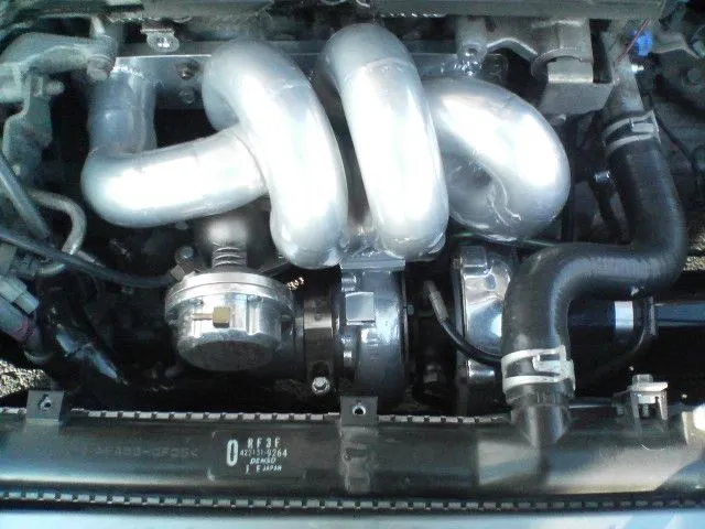

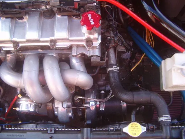

I had no issues. It is tight in there though. Not a whole lot of room to work with.
Nice.
Did you have any problems with making yours fit? Mine is basically a hair from having the compressor housing hitting the clutch bleeder screw :p
