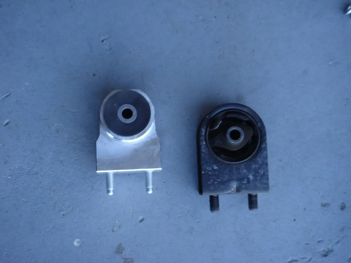

I just changed out my front motor mount with SU mm. Man it makes a lot of difference. The clutch action is much more linear, wheel hop/clutch shudder is much less severe, but still present. A little quicker throttle response. Much less drive train lash. Smoother power output. Feels like more hp but I think that's placebo. All good but one bad thing the vibration.
but thats still bearable with one new mount. Hopefully it will settle down after awhile, but I don't know if it will ever get to a point of not vibrate the dash.

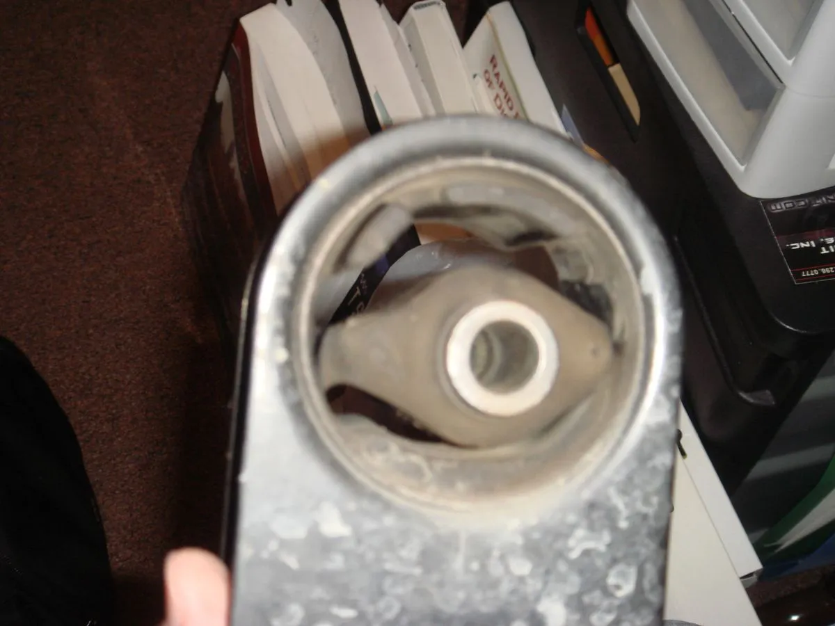

It drives so much better, but bear one thing in mind that my OEM mounts had served 90k. They look terrible, I saw one side mount is totally ripped too. The new SU side mounts are back ordered and hopefully it will get here soon.
