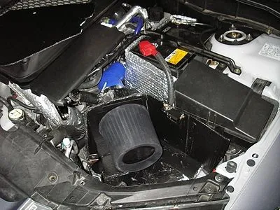

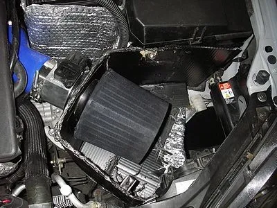

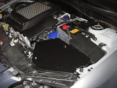

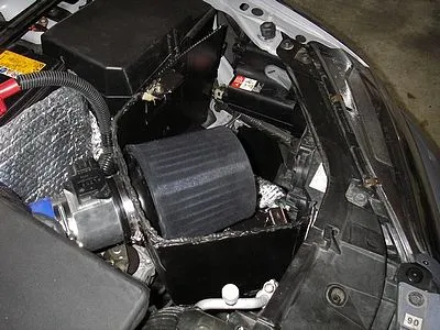

Summers coming so i fabbed up a box for my CS sri. Not the prettiest thing but it will work.(rlaugh)

what did you make it out of?? Looks like a good idea. Does it help?
Its made of that white plastic cardboard you can buy at home depot. And it isnt melting its just silicone i used to make a seal (probably should of used some stick on foam but didnt have any around) Used spray on bedliner for the black color.
After the engine is warmed up after a drive, and idling, the engine bay is hot while the interior of the box is cooler, so it works for me.
