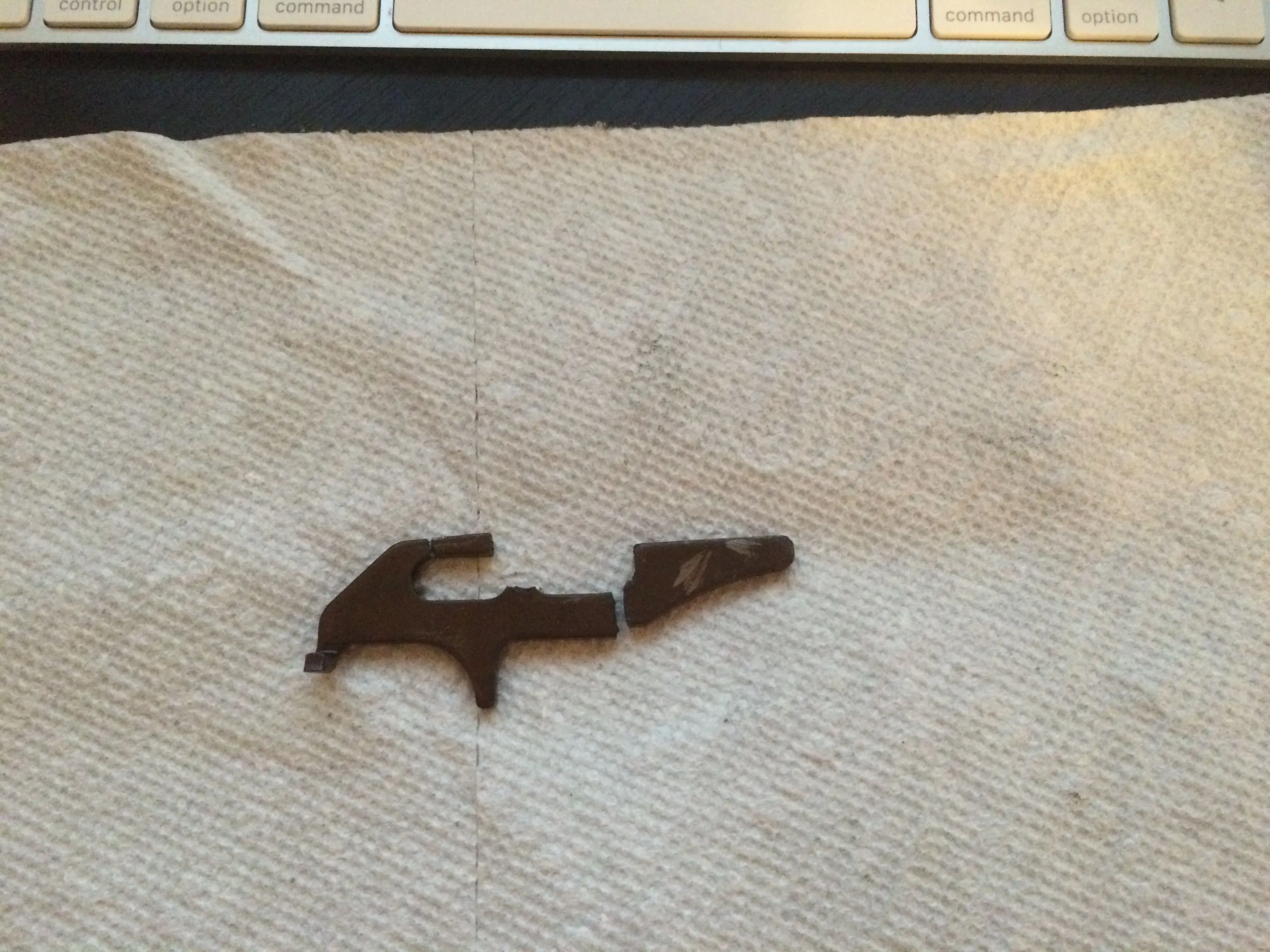

Does anyone know what part this is, or even better what part number? Came out of a G15M-R that has a bent Shift Control Arm and this part was under the LSD and right below the guide plate. Thanks for any help in advance.
After partially reassembling it with the guide plate, I came to that conclusion that it is the reverse lockout. Now next question, if I was to order a guide plate from Mazda would this be attached to it?
h ttp://crossover auto . com/crossovershop/index.php?main_page=product_info&products_id=691&zenid=d8304ed6d95b7648adac0a68ad613796
Answering my own question for future reference, it looks like its attached and not expensive at all thank god
