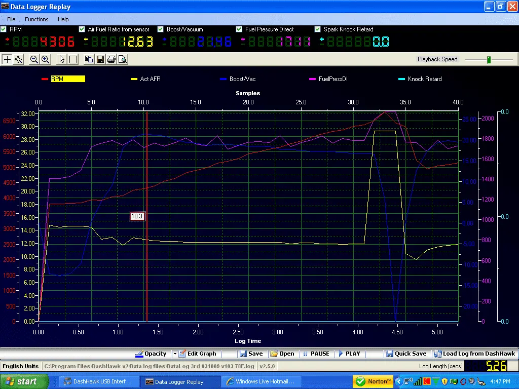

If you have stage 2 mods and are cutting try stage 1 as it will boost a tad lower. Make sure you test with a DH.
