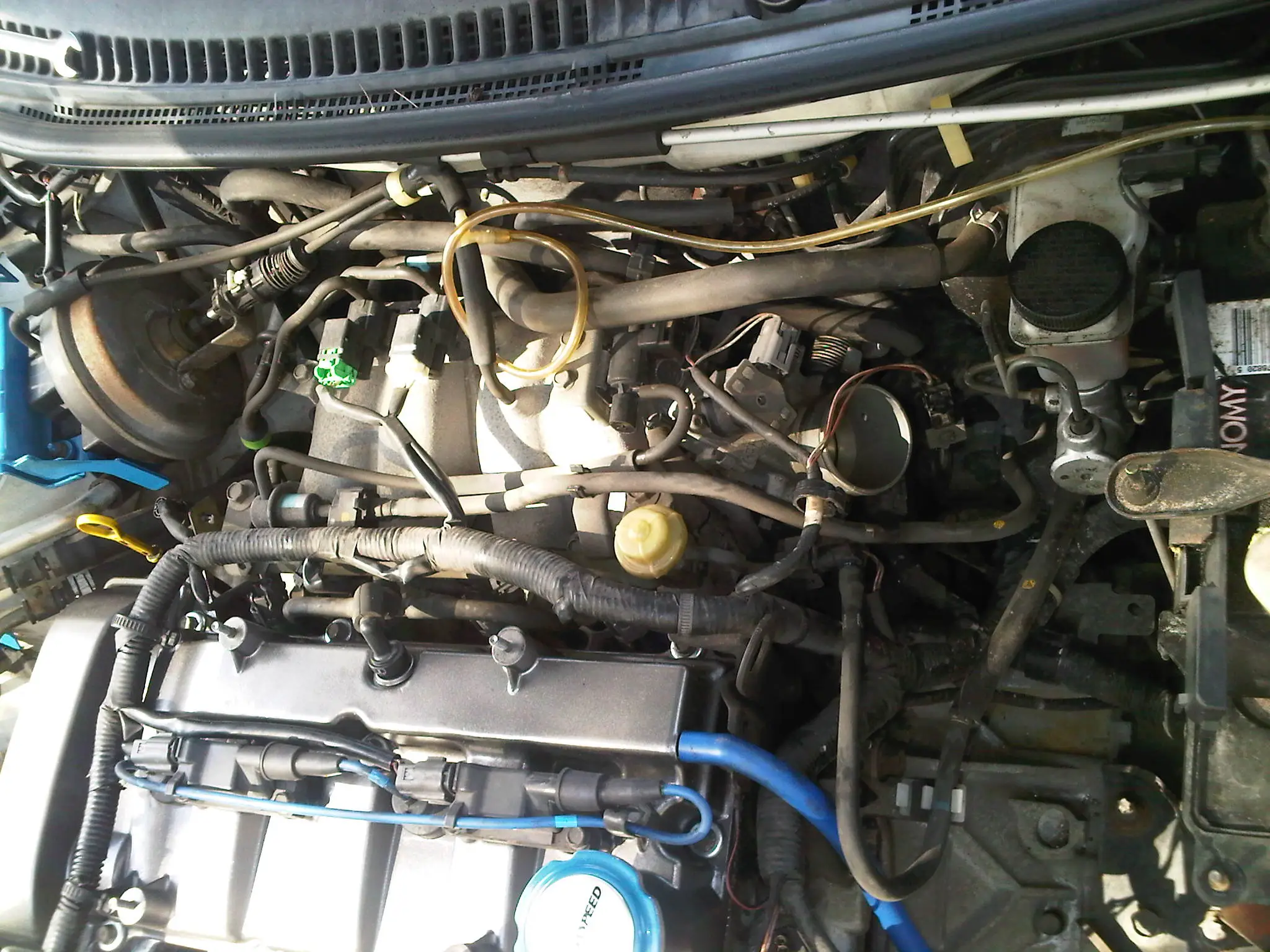

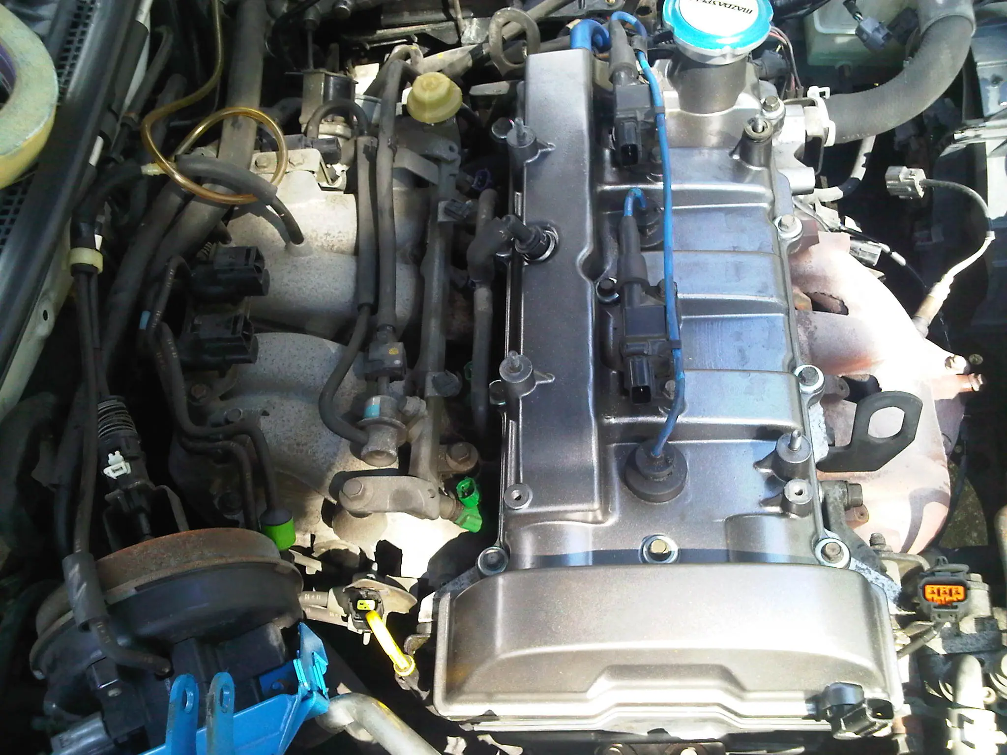

ok....let's begin with removing the batt, air pipe, and the strut bar. you should see this when you look from the driver's side fender into your engine...

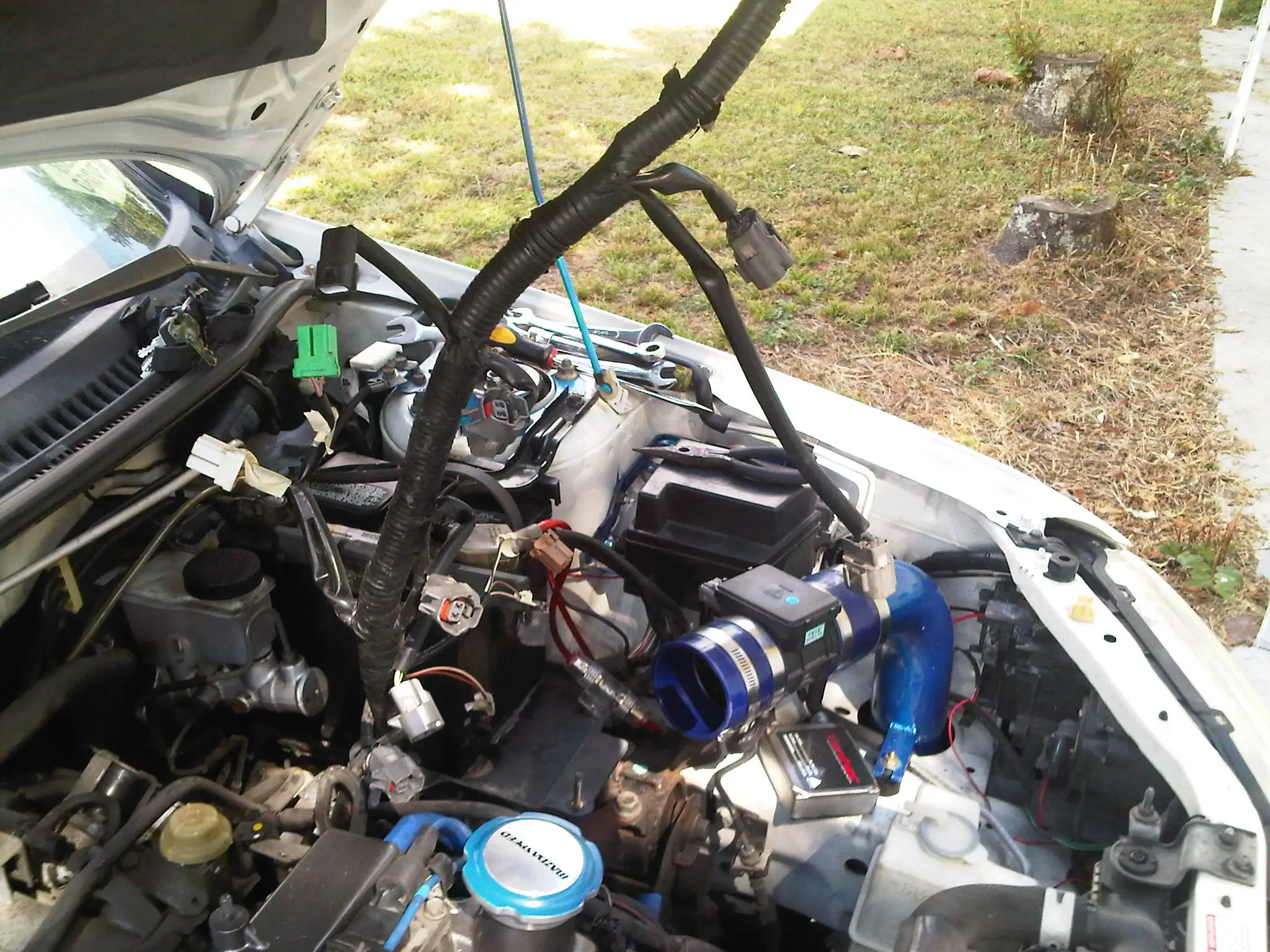

next, you need to remove all the wiring that goes around the intake mani.
start with the a/c, ps, then crank and cam sensors, then coils, then a pesky lil one right above the alty, on to the 2 on top of the intake mani (control virs and vtcs), then the fuel press regulator solenoid, then the iac, then the tps. should look like this...

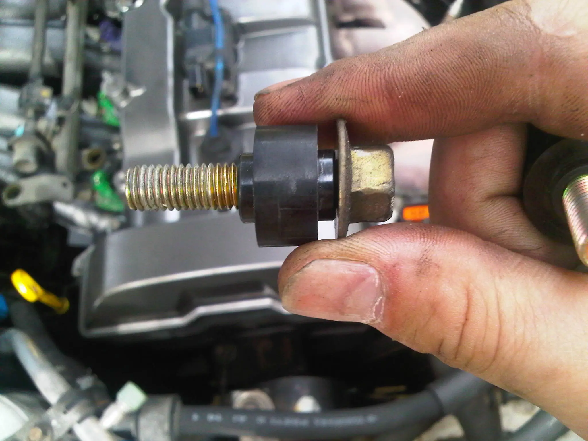

next, we'll remove the fuel rail. you'll need the 12mm socket for the 4 bolts that hold it into place. BE BERRY CAREFUL, there are 4 plastic spacers that go right under the rail, and if you lose them, you're sol...they are black, and hide in places you'd never believe. i spent 3 days waiting on a replacement for one when i dropped it only to find it right under the cv joint...this was a very long time ago, so i learned from that.

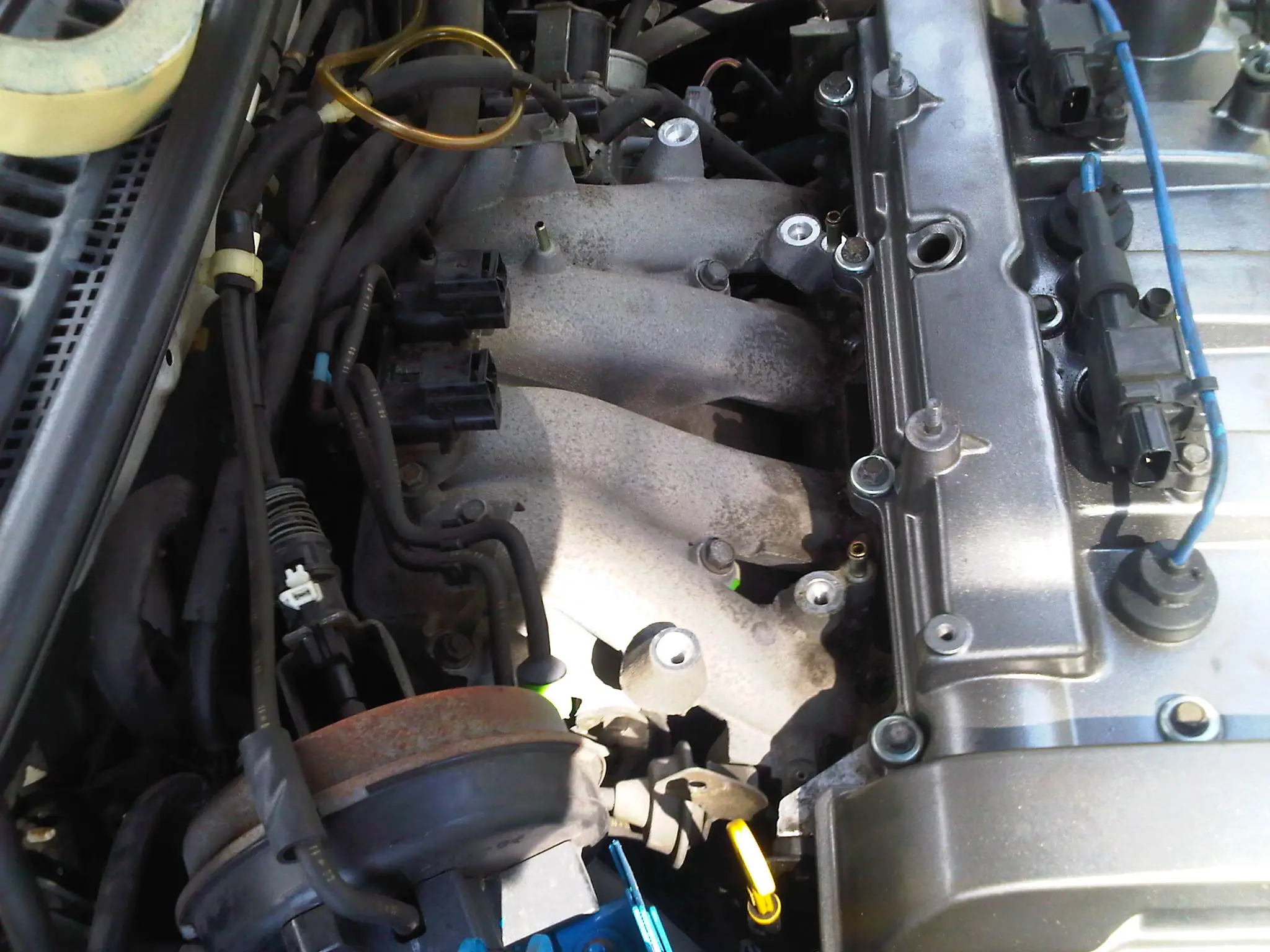

here's the intake mani without the FR...
and here's the plastic doo-dah i was talking about....

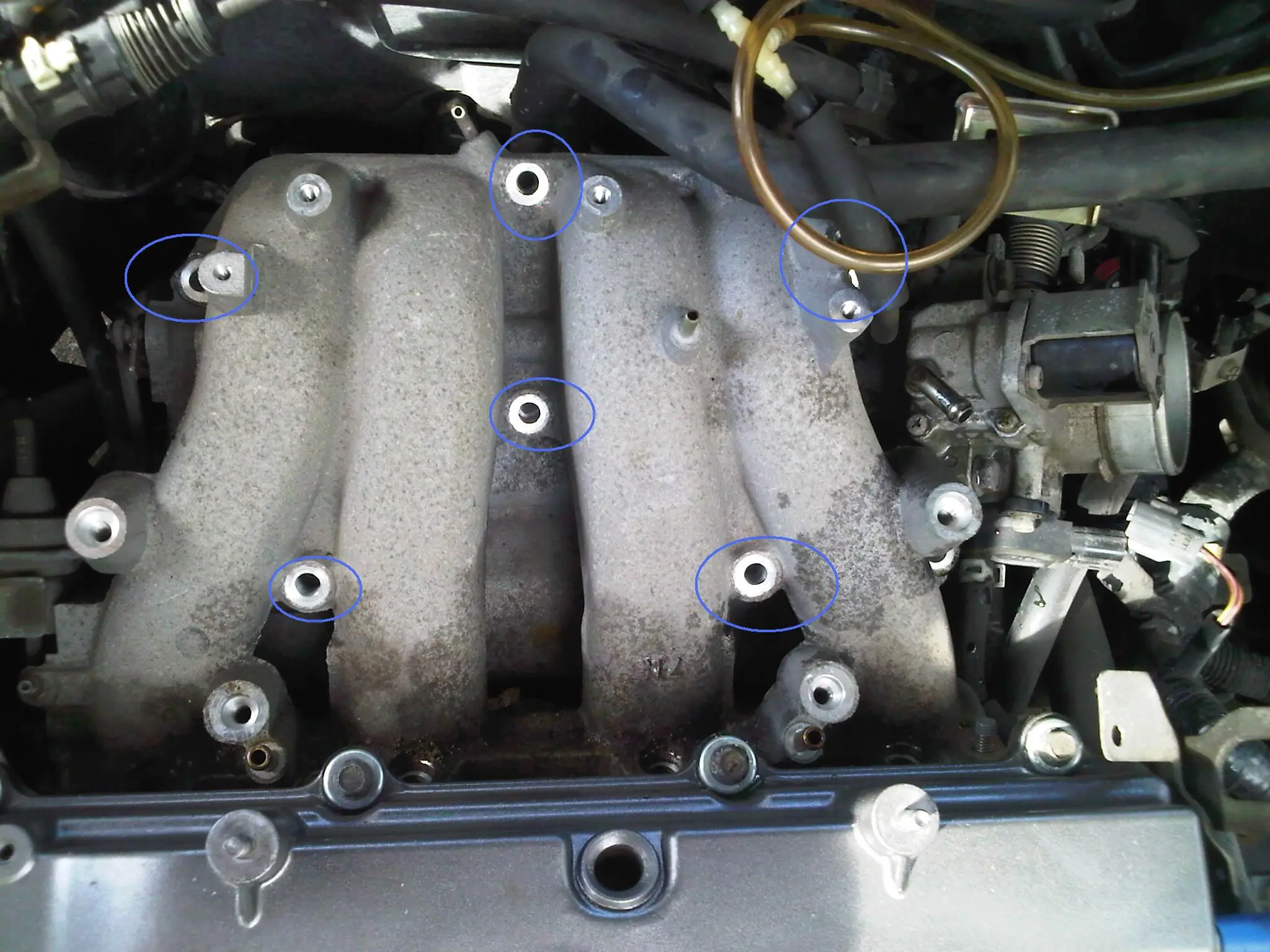

you'll need the 12mm and remove 4 bolts and 2 nuts. they go: 2 nuts on the upper edges, 2 bolts vertical, and 2 extra-long bolts on the lower edges. i circled them on the pics so you guys have an idea as to where they go. i had to 3ple check to make sure...

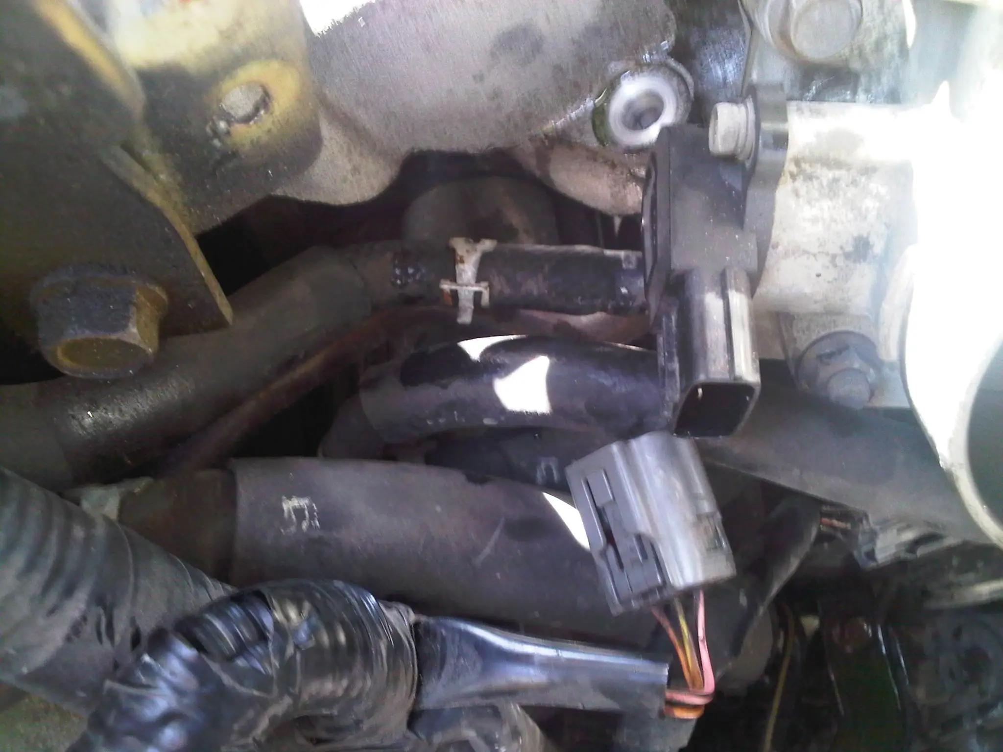

take the toolant hoses going to the TB off, one on top, one on bottom. here's the bottom one...
next, use your 12mm wrench. there is a bolt there, trust me. you've gotta come at it at an odd angle. you can use your finger between cyl 3 and 4 to help you guide it in...break it loose....then swap to your wratcheting wrench. you can use the regular wrench...if you have a week to do this...lol. if not, then this is the only way. it gets tricky, but it can be done.

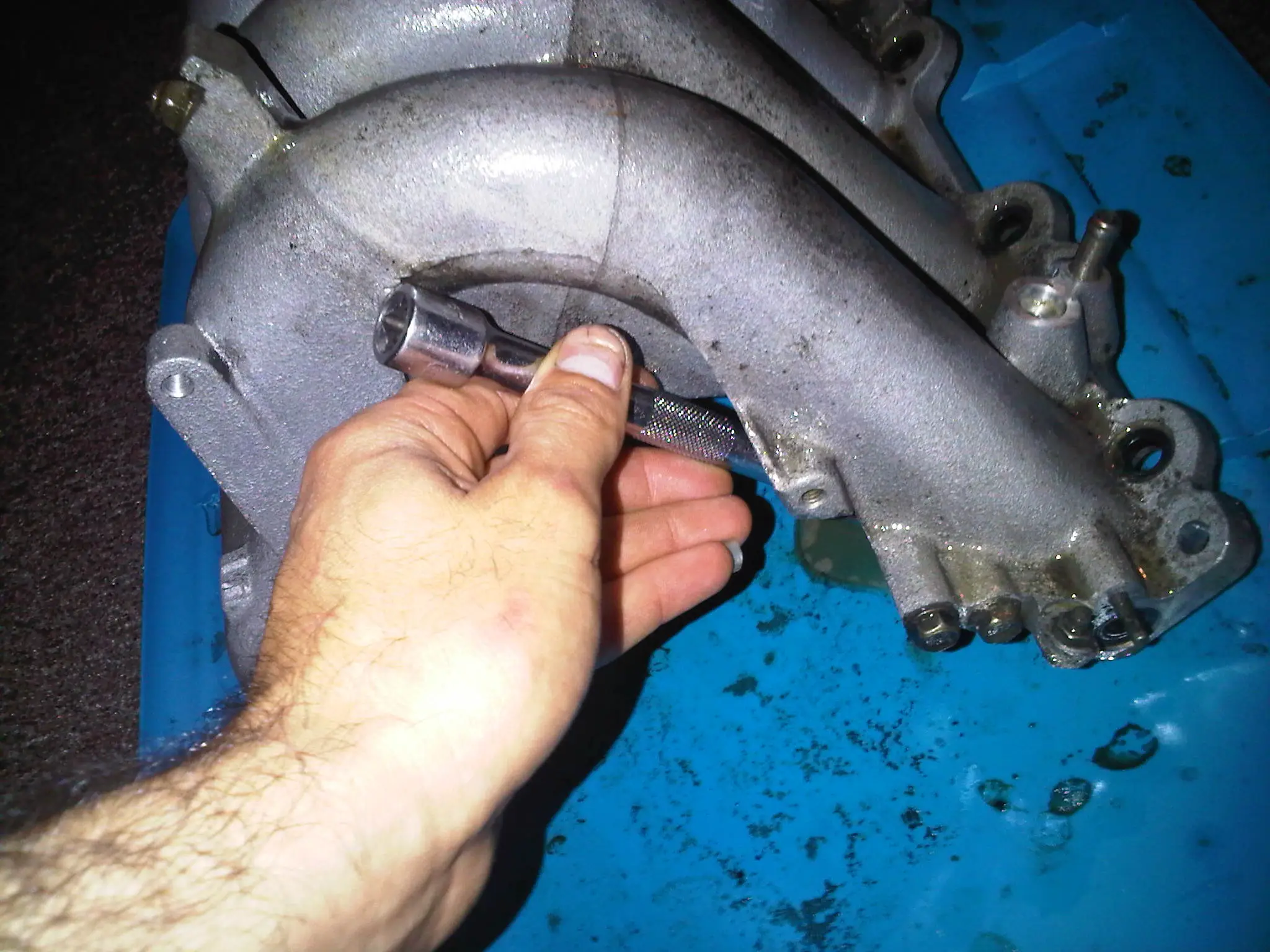

next, the pass side...this is a bit easier. a 6" extension on your 12mm socket tackles this easily. insert it in this way....
Inverness-20121025-00769.webp sorry, this is a diff mani....if it confuses anyone, i'll take a diff pic. i just thought this way everyone could see the angle of attack. :)

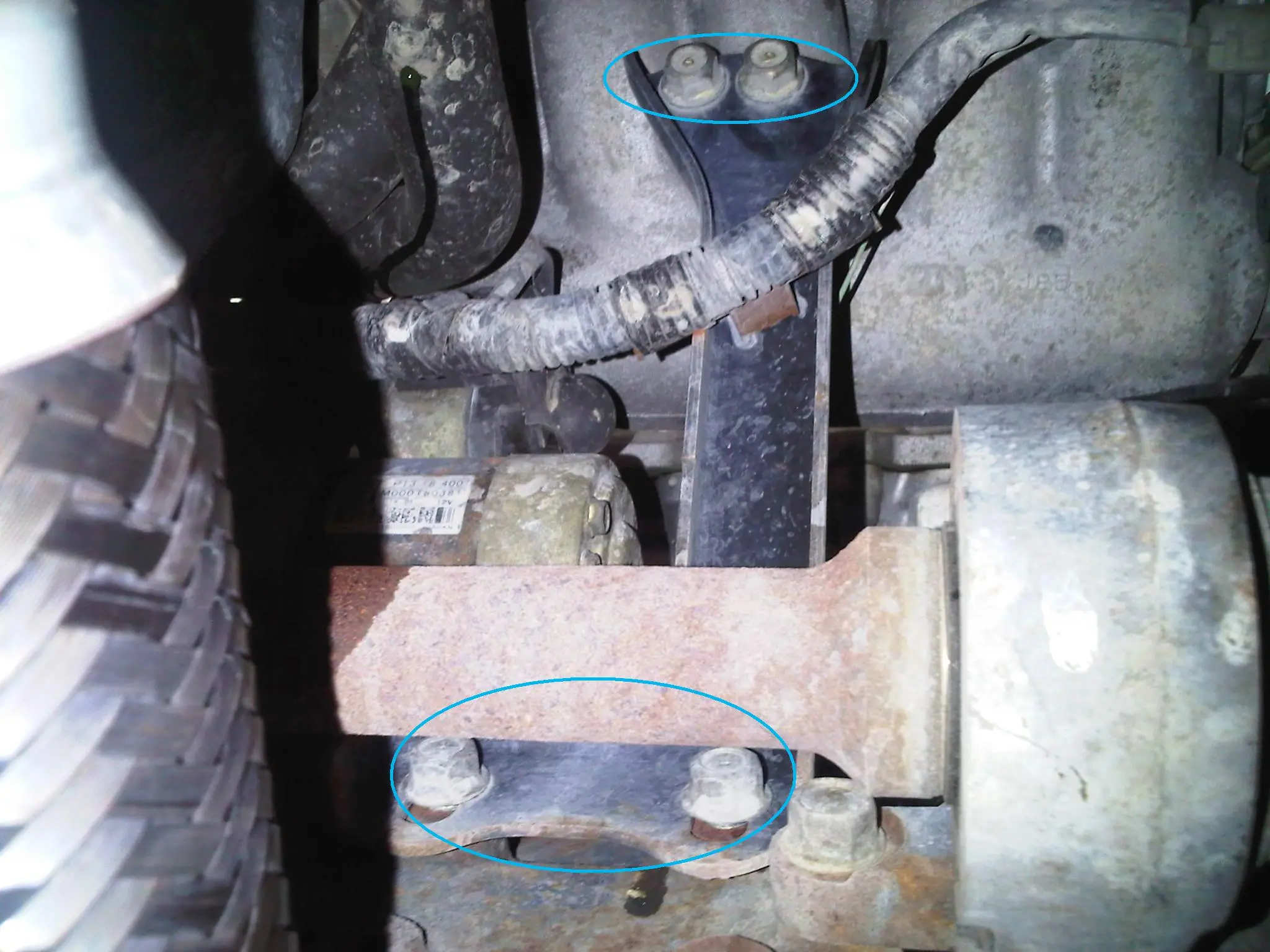

ok, now jack your car up, and take your 14mm, looooooong extension, breaker bar, swivel, and tell your kids to walk away....we tackle...the brace.
4 14mm bolts are all that stand in your way...
