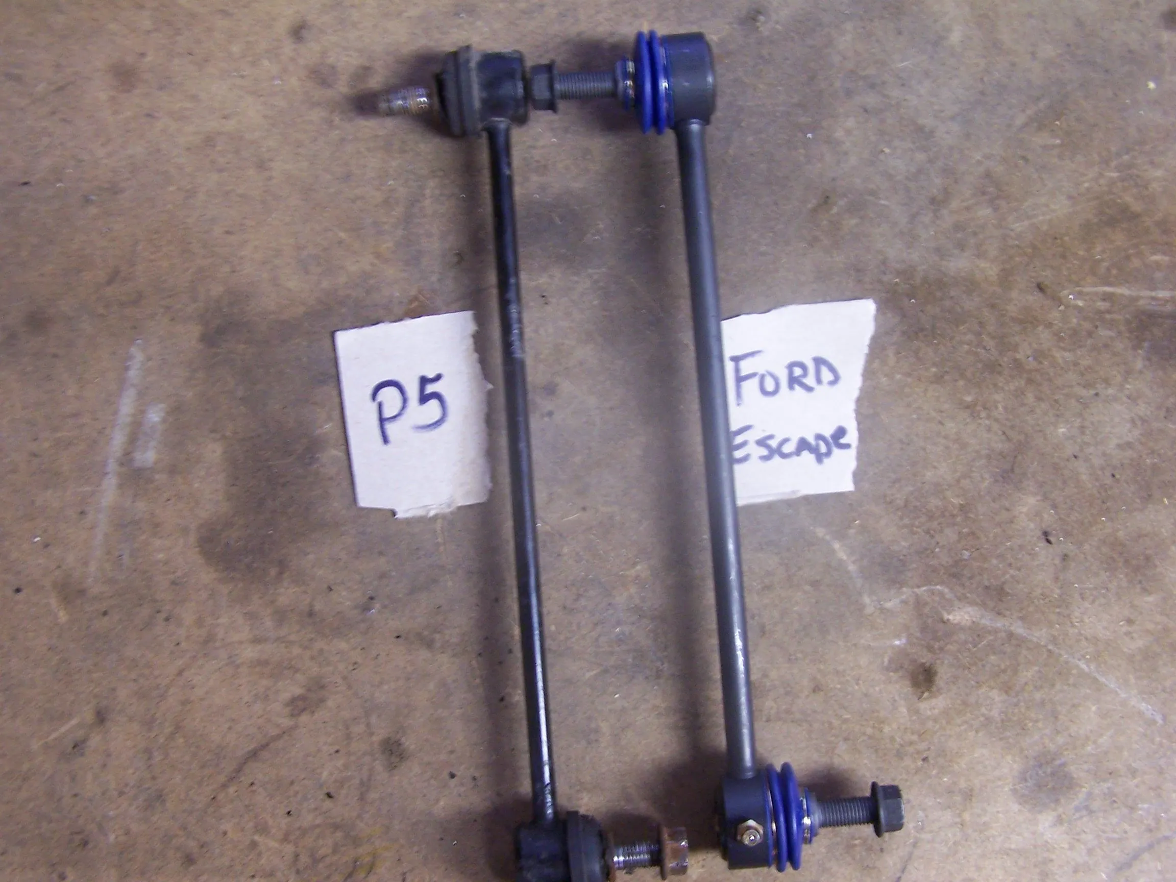

So hows the handling with the ford links? What year escape did you get your links from? A pic of the stock Mazda links and the ford links side by side would be sweet if you have one.
JT
end links mazda 1.webp2002 Ford Escape AWD V6 is what I told them.
I only had time to drive a few miles tonight but it feels "tighter" and ,of course, it doesn't clunk over every little bump.

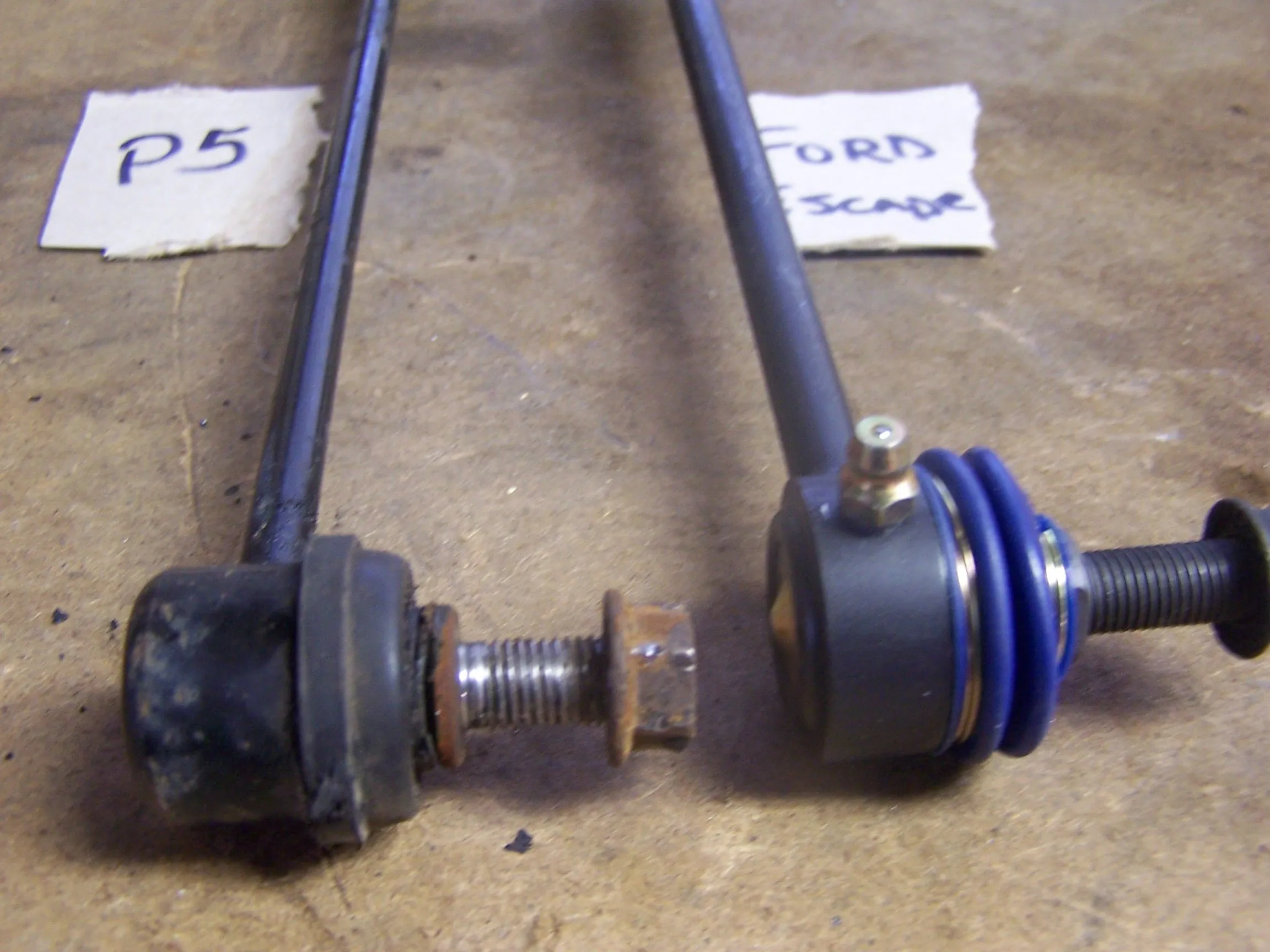

Here's another pic. Not only is the rod beefier, the ball sockets are larger and greasable.

Cool, and I'm lovin the grease zerk included. Is the length an exact match and how do these price out?
Length is exact and they cost $35.15 total at my local CarQuest. I believe I paid around $25 each for the stock Moog parts.
The instructions say that they are greased from the factory so you don't even need to do that.
Are those for the front or rear? I notice the Escape one are a tad smaller...any effect on the handling?
Front only. They fit perfectly. The ends are extremely tight so you may have to work a little to get them to fit. I turned my front wheel a bit to get more more room. i didn't notice any improvement in handling this morning on the way to the office but the front end feels "tighter".
