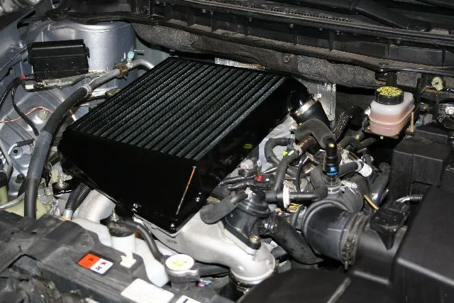

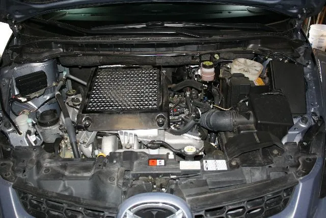

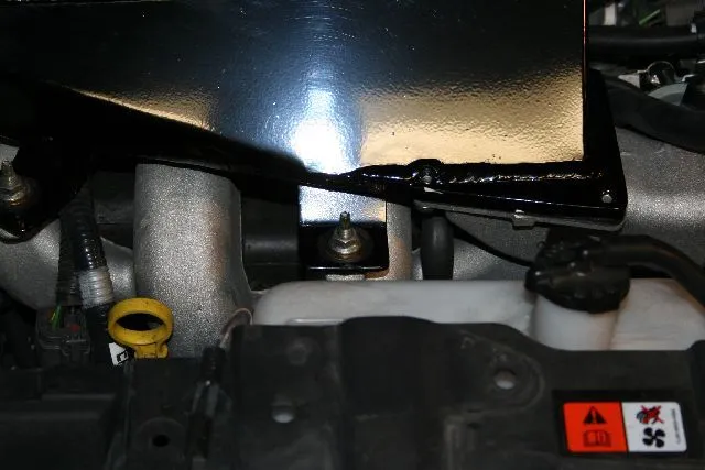

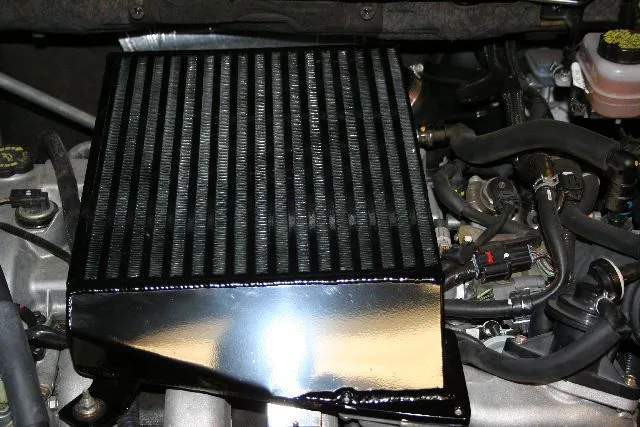

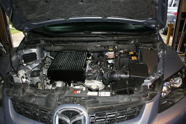

I jut got my black powder coated ETS TMIC installed.
All was fine except they manufactured it with the front mounting tab bent through the middle of the hole for the grommet up at a 45 degree angle. (jerkit)
I do not know why but it is so bad the nut cannot start nor will the metal insert go through the grommet. If you get one of these expect to have to bend this tab down parallel to the bottom of the intercooler.
I mounted the other two and then using an oversize socket and a large washer over the stud beat it down until flush with mounting stud base. Then installed grommet and metal insert and all was fine except a slight ding on my powder coating on the tab.

I have no dyno so no hard numbers.
I can say I hit it merging yesterday and it had noticeably more pull than before. My son even commented that it never pulled like that before.
No NOS hit but a definite improvement.(thumb)
Now I need to get the CPE intake... (drive2)
When I contacted ETS on the bent front tab, they responded back the next day offering to fix and re-powder coat it at no charge to insure I was happy. Since I have fixed it already I declined. Very supportive email. So if yours arrives bent and you cannot fix it, contact them as they seem to stand behind their stuff as all of it is done in house. (drinks)

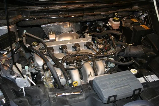

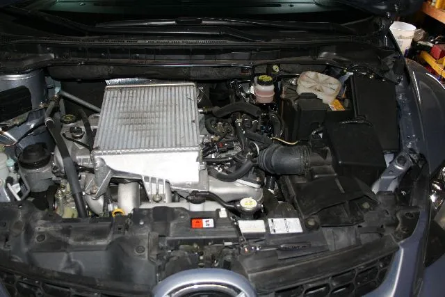

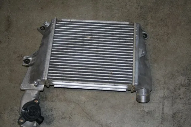

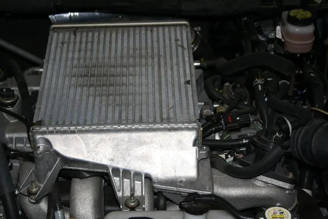

Stock before pictures below for comparison

Very nice....been wanting this particular piece for quite awhile. Time to persuade the wife.
Correct me if I'm wrong you should never paint the fins on the intercooler it reduces it's efficiency. This have been seen on some people painting names on front of the intercooler.
PS: looks awesome, this will be my first performance part for mine, I'm just waiting my tax return :D
Light coats do not affect the effieciency.
If you actually could get close and looked you would notice the fins inside are still bare metal.
It is not painted it is black powder coated. Only the outside is powder coated.

Regarding the bent up tab on the front it appears the ETS jig was set wrong.
They are taking steps to fix this so no future ones will have this and they will take care of anyone who has one bent up and needs it bent down and repowder coated.
Darryl,
It appears upon further inspection of the tab in your pictures compared to recent units that have come out of our jig for the CX-7 that the one tab angle does need to be modified. We will be correcting our jig to prevent this from happening on any future intercoolers. Again my apologies for the inconvenience this caused on your end and on others having experienced the same issue. I appreciate your post on the forum as we will support our product 100% in any case, and especially in this instance. If you have any friends wanting theirs corrected we will of course get that done as expeditiously as possible and at no charge for the repair or any shipping. Thanks very much for your feedback; its crucial to us continuing to perfect our products!
___________
Tom Hughes
Nice to see a manufacture be both honest and stand behind their products 100%
