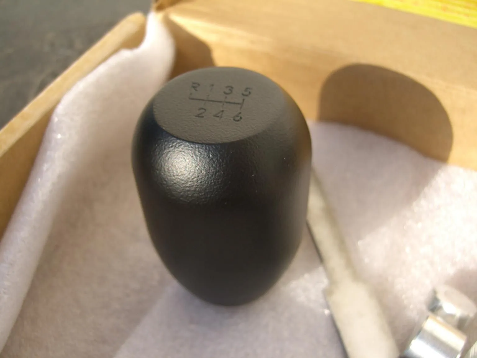

Well I purchased a black powdercoated and engraved heavyweight shift knob from E4 Performance HERE
It took about a month to receive the knob because of quality control issues. Basically, the first powdercoater f'ed up the job and Scott @ E4 didn't want to sell them because they didn't meet his standards. I was fine with that - quality takes time.
So I got my knob a couple weeks ago, and I can tell you, it was worth the wait!

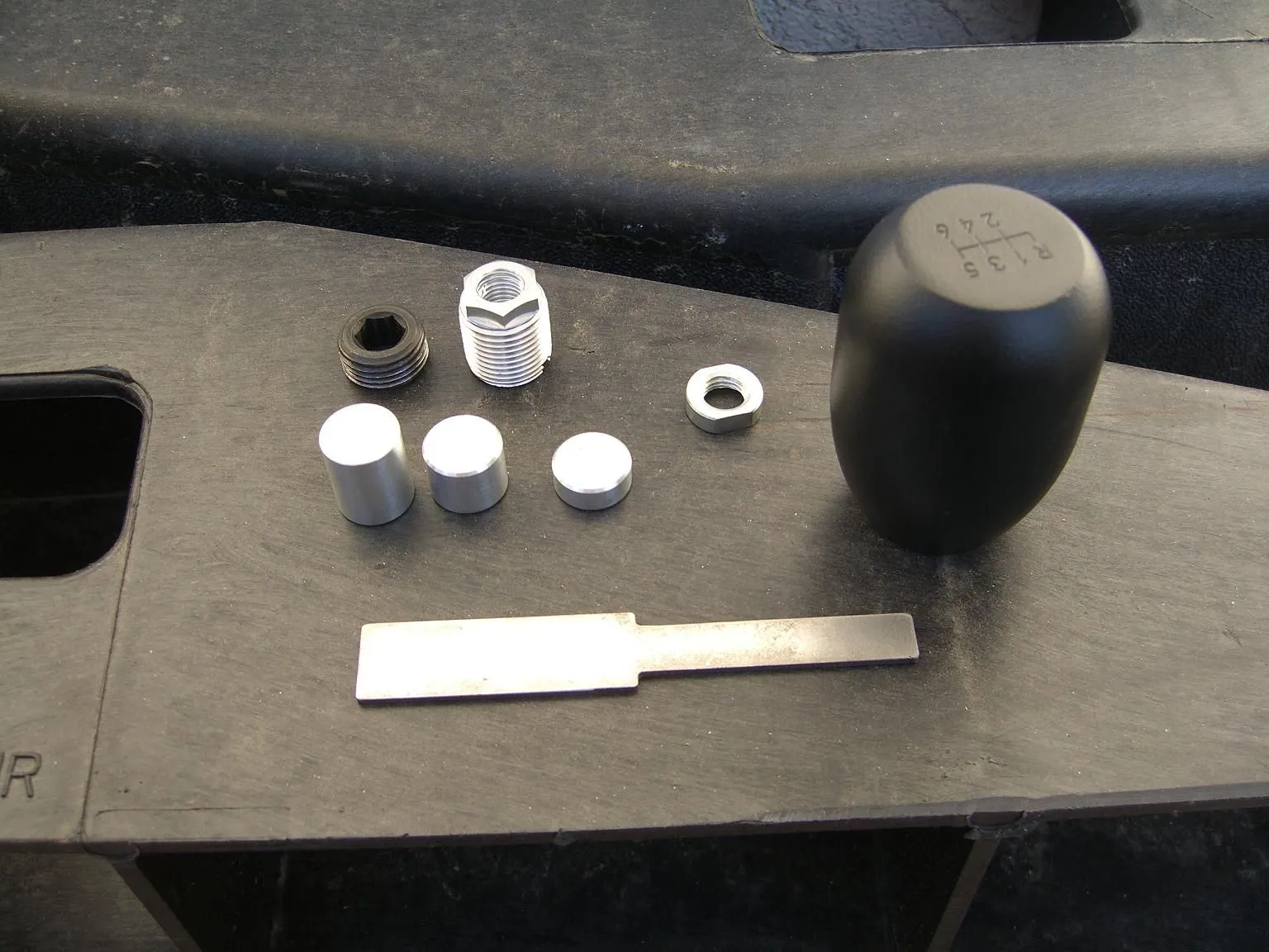

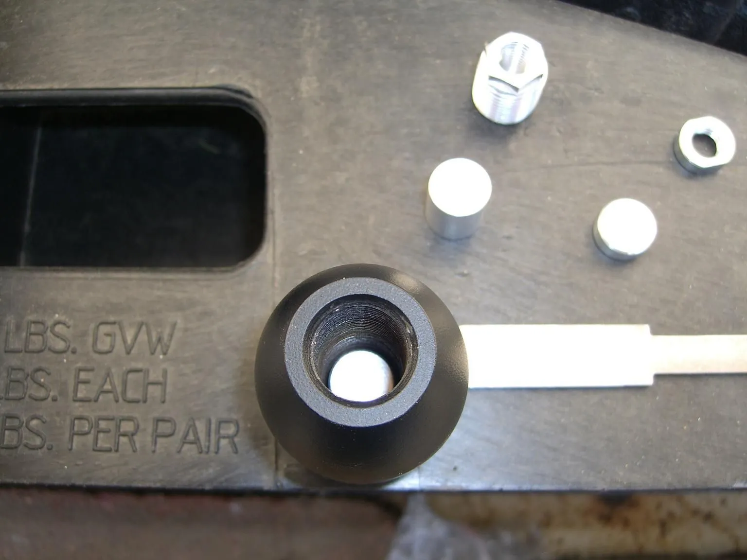

Pic 1: What comes in the box

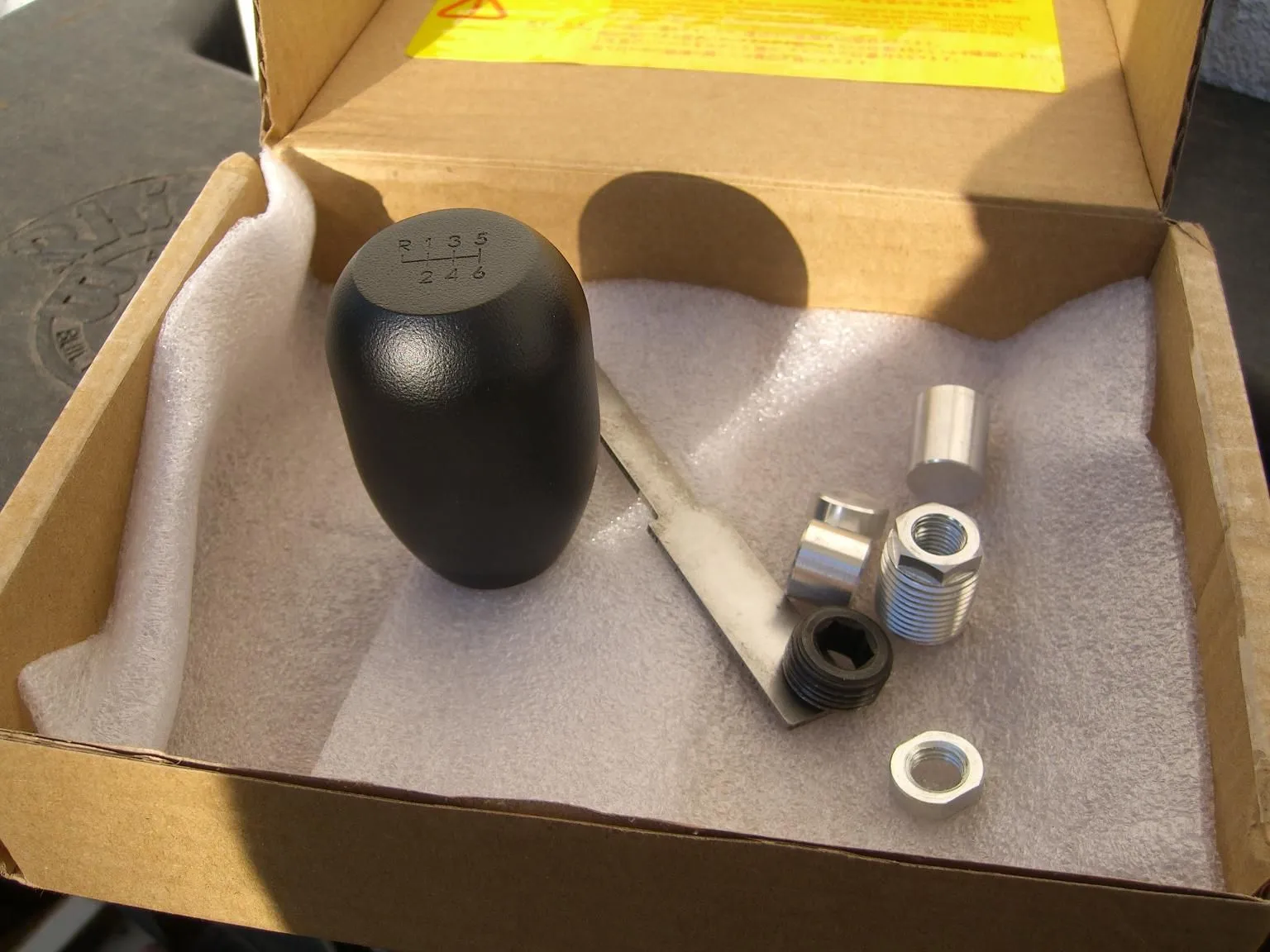

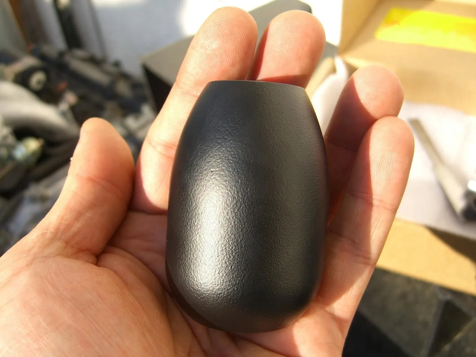

Pic 2: View of engraving on knob

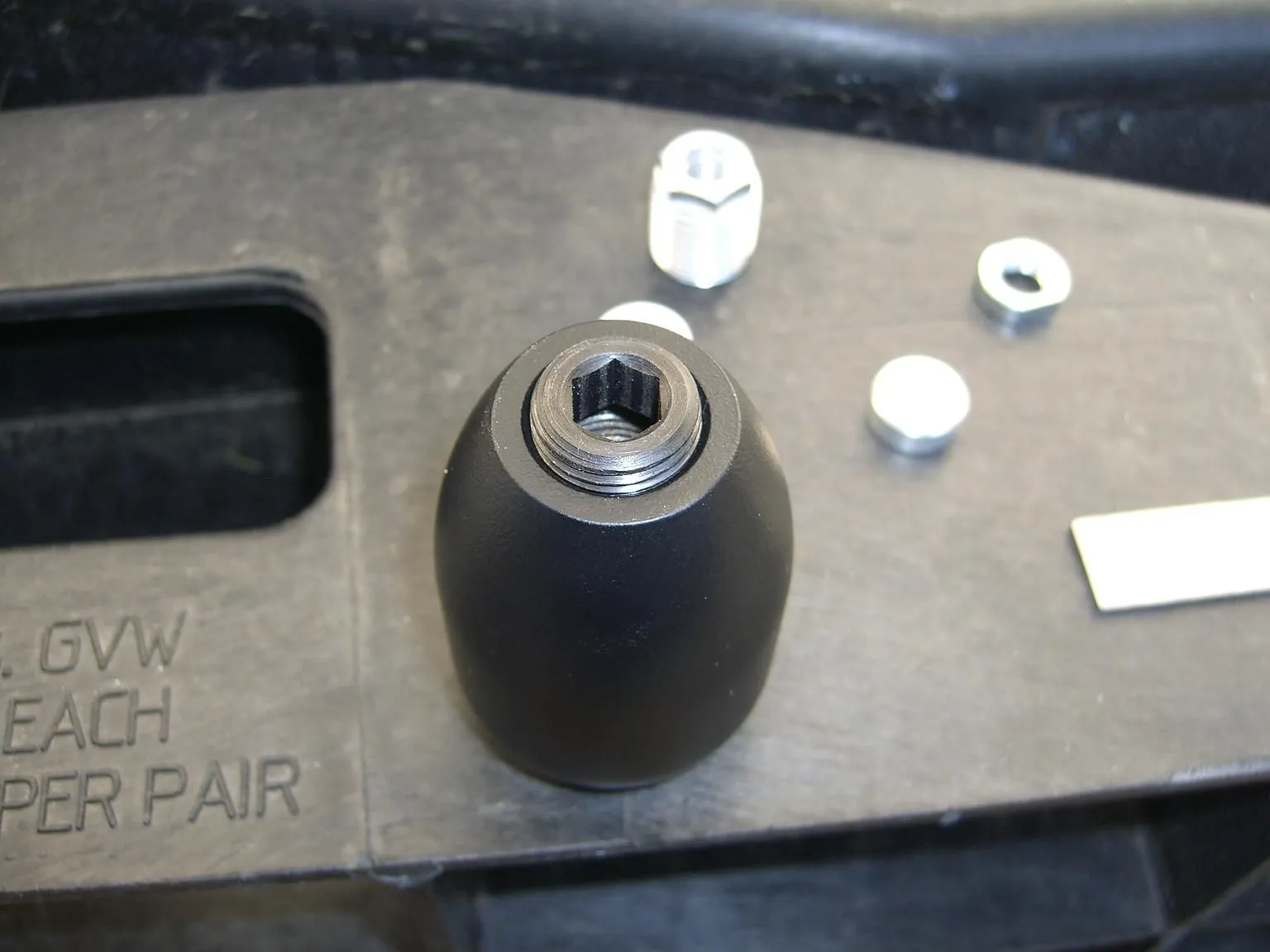

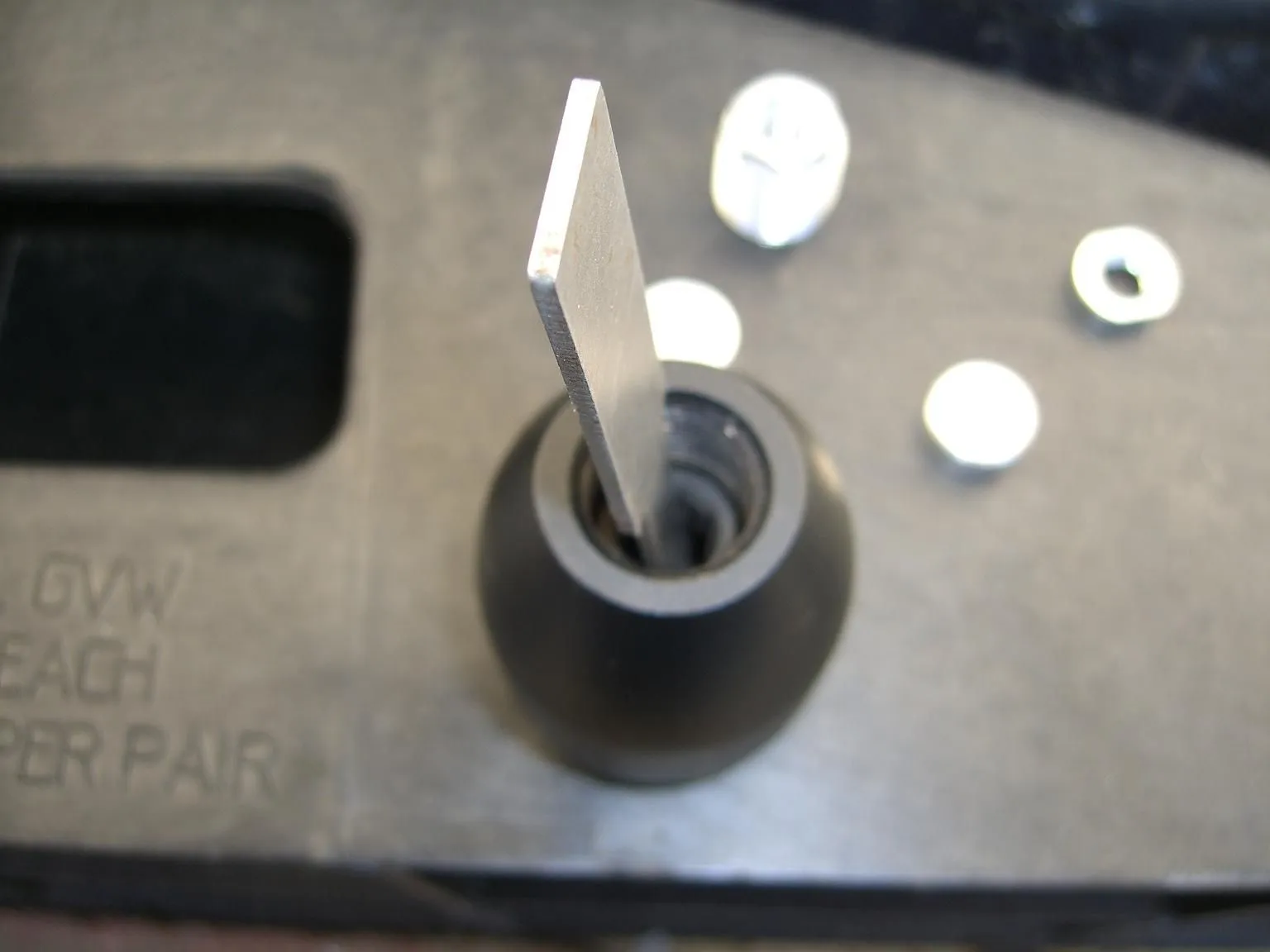

Pic 3: You can see the very fine "wrinkle" powercoat on the knob. Flawless.

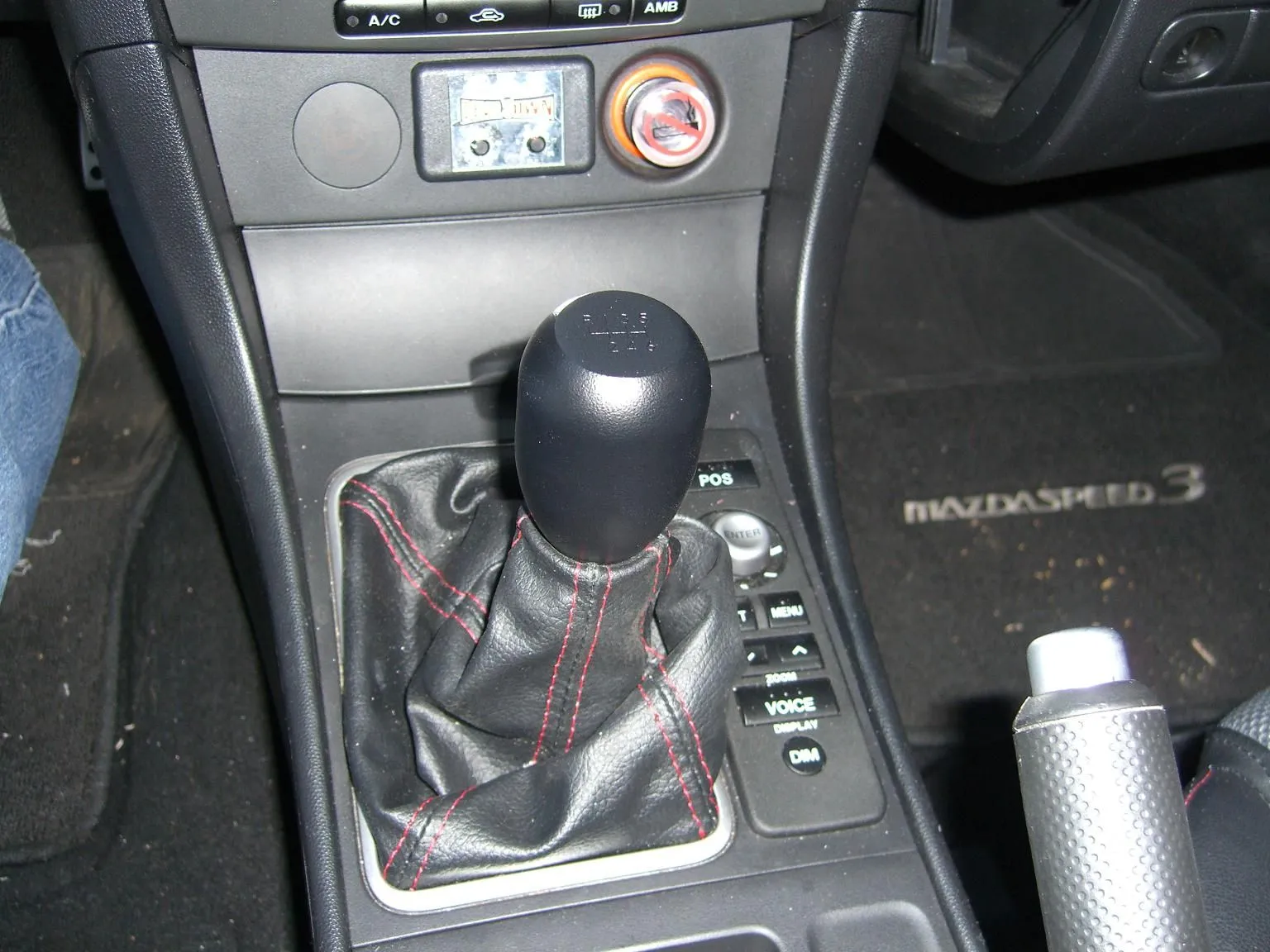

Pic 4: All parts.

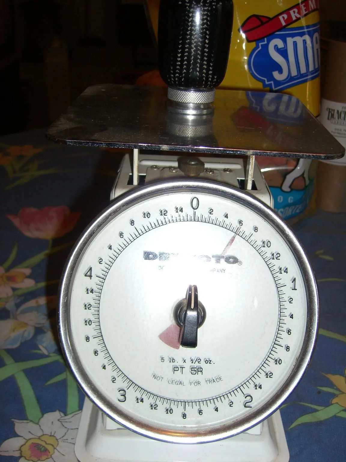

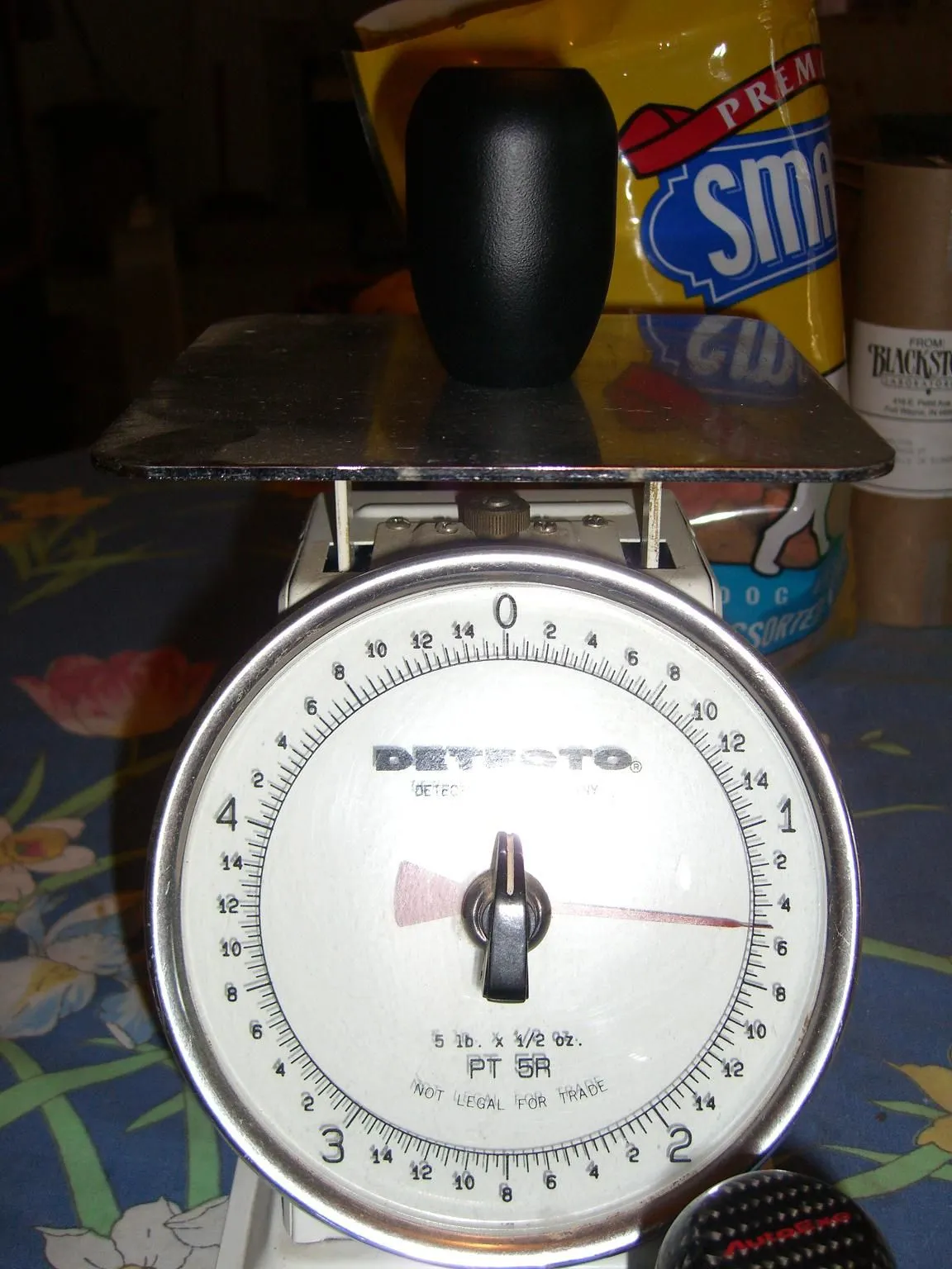

These pics show the difference in weight between my CF AutoExe knob, and the E4P knob.
Pic 1: AutoExe knob @ ~6 ounces
Pic 2: E4P Knob @ 21 ounces (That's over 1lb!)

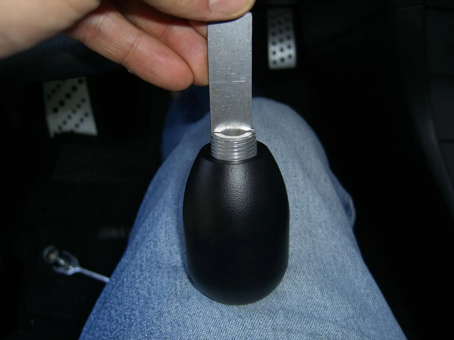

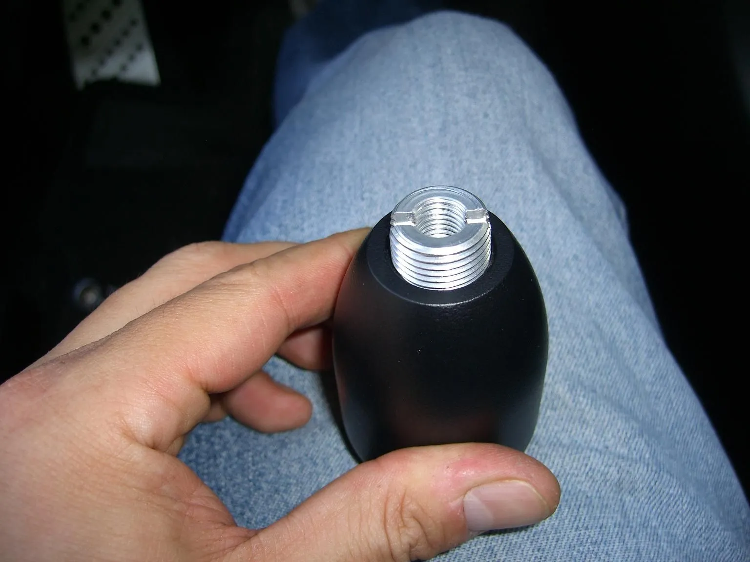

I selected the mid-sized spacer...
Pic 1: Shows spacer inserted in knob - make sure it's flat on the bottom
Pic 2: Shows the retaining nut - this holds the spacer in
Pic 3: Use the rectangular tool to screw the retaining nut into the knob

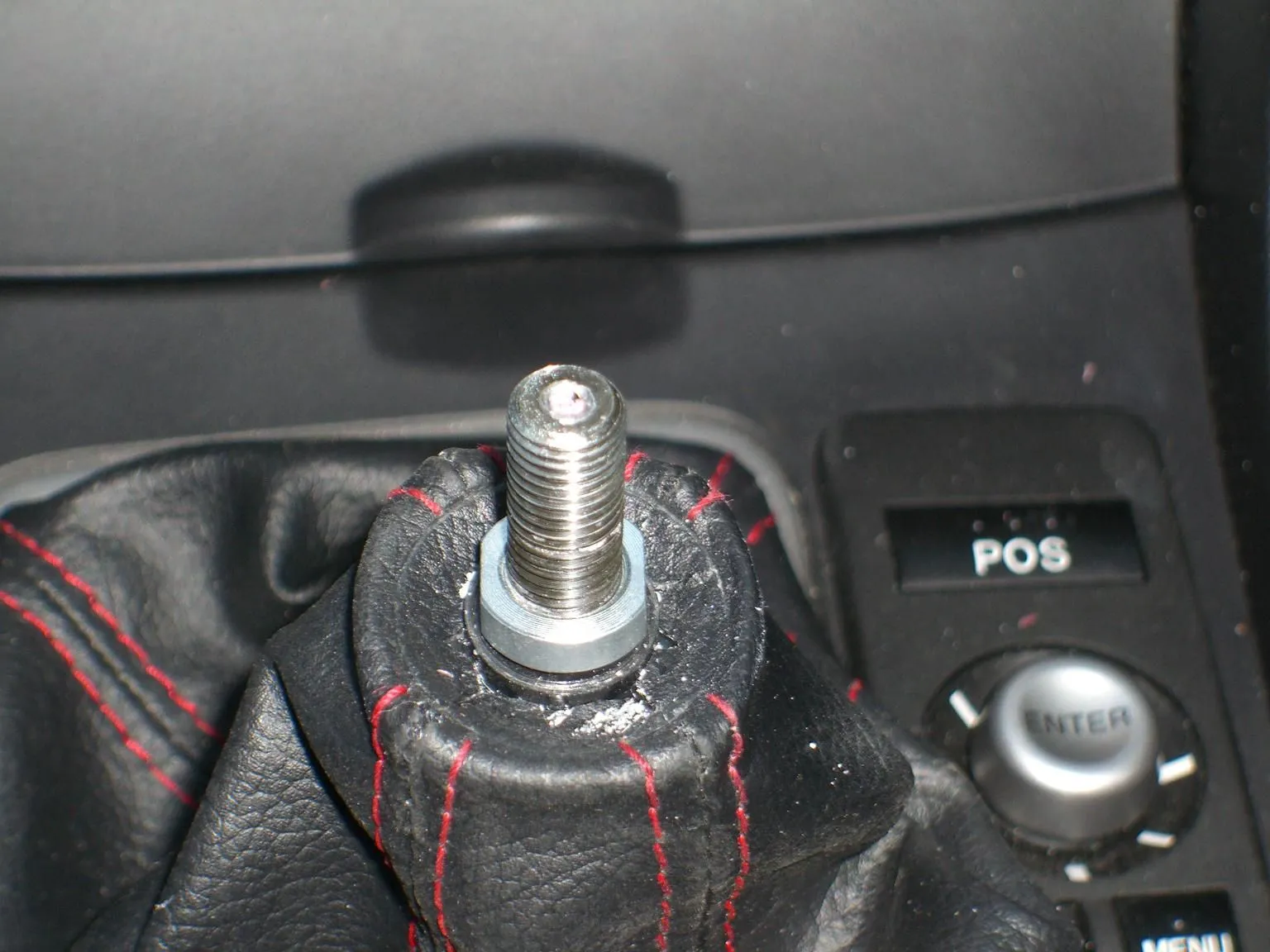

Pic 1: Insert the low profile jam nut onto the shaft, and screw it all the way down
Pic 2: The threaded sleeve that goes into the knob, and your shifter screws into it

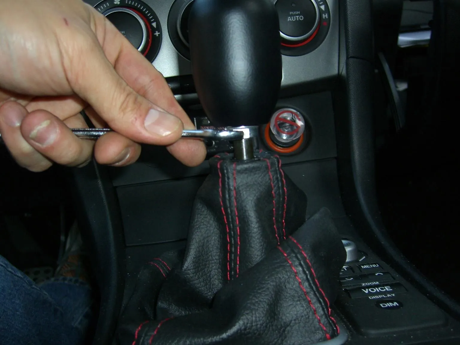

Pic 3: Other side of rectangular tool used to screw the sleeve in

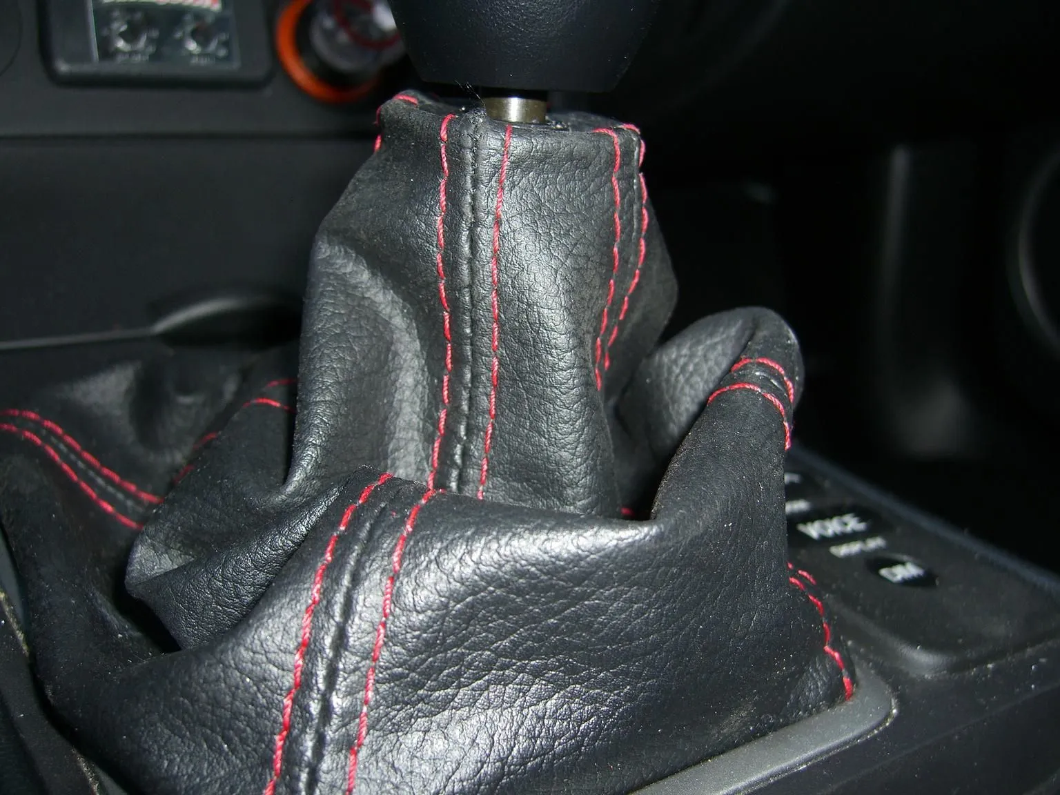

Pic 1: Shows how much gap I left between knob and boot
Pic 2: Once you've gotten the height set to your liking, and the lettering aligned properly (if you chose the engraving option), tighten the jam nut to prevent movement
Pic 3: Final product

Impressions:
This thing is a monster! Heavy heavy heavy! The powdercoating was flawless... I love the fine wrinkle finish on the knob, gives it some texture as opposed to a smooth finish. If you want a smooth finish, get the polished option...
The hardest thing about this install, was that there were no instructions included with the knob. You can search this forum or others for installation instructions if you want... I ended up watching a youtube video showing a heavyweight knob install from another manufacturer, on a different car. That being said, it was still a pain in the butt to adjust the sleeve and jam nut to get the engraving to line up properly. You'll have to play with raising/lowering the threaded sleeve on the shifter shaft, and then tighten the jam nut, then screw on the knob to check alignment. You have to tighten the jam nut against the sleeve or else when you unscrew the knob, the sleeve will unscrew with it.

I tried to install my E4 knob today. It is on and seems secure, but it seems like it sits quite a bit higher than the old knob, and there is quite a bit (an inch maybe) of shaft showing between the bottom of the knob and the shift boot. Is this normal? I actually didn't use any of the spacers, so it's as low as it can go.
I'm sure I can make it look better by taking off the boot and putting spacers in to lift the top of the boot up a bit, but I'm just wondering if this is normal or if something funny is going on.
Nevermind. I figured it out. I wasn't removing the nut that comes inside the knob that is supposed to hold the spacer in place. I don't know why the send it already installed. Just makes it more confusing.
I tried using the smallest spacer. Still a small gap between boot and knob, so I removed the spacer, tightened the nut and sleeve all the way in, and put it on. Now there's no gap and everything looks good.
