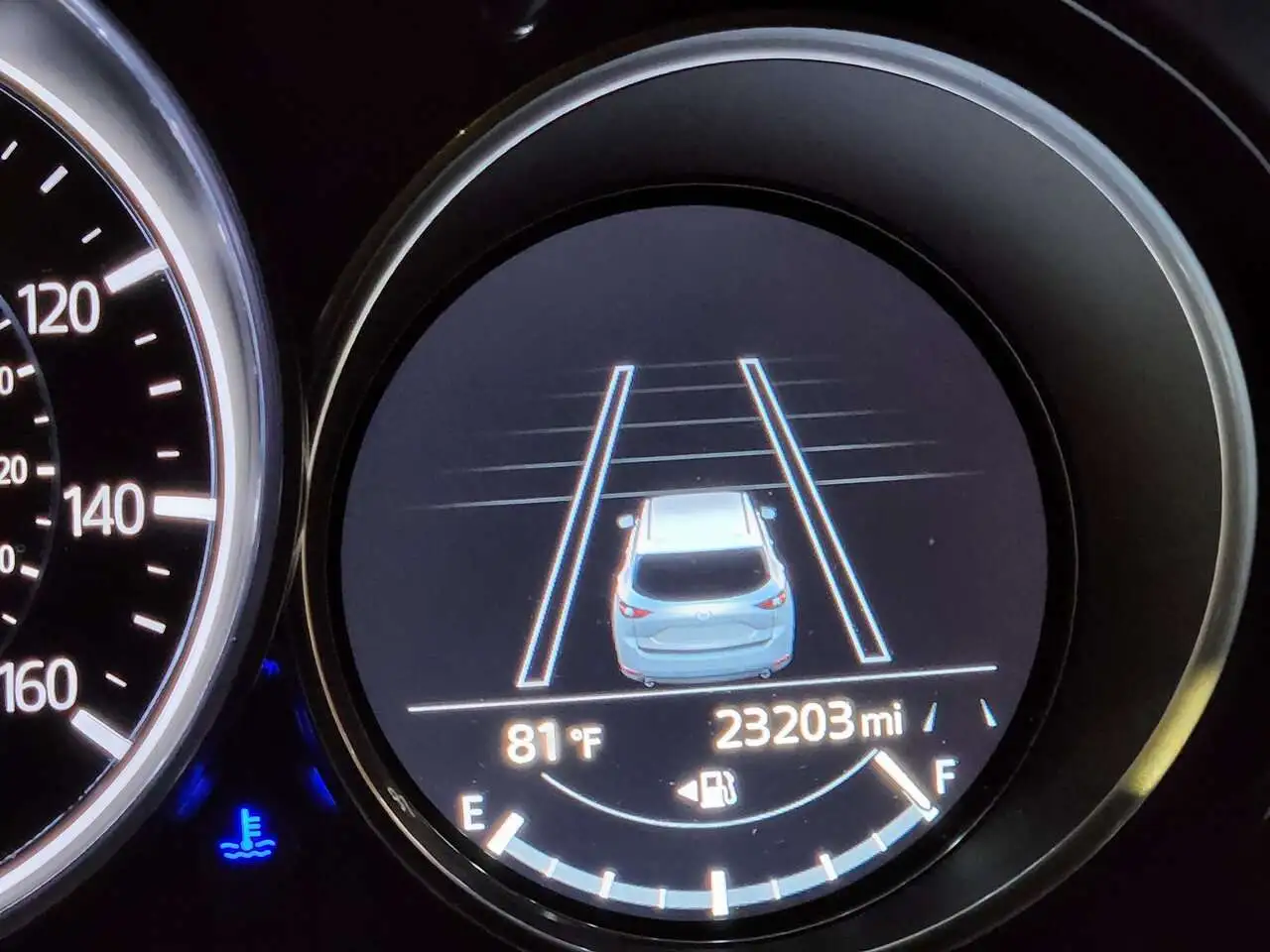

Does anyone else have these horizontal white lines on the driver info system screen. Is this normal? Anyone else have this problem?

That's the car length distance spacing. When you get too close and enter one it should change to red. If radar cruise is activated it should keep 3 car lengths back from the car in front of you.
What about the horizontal lines outside of the bold vertical lines? I don't remember those being there until recently. They look like ghosts.
Not quite sure but I think that indicates that radar cruise is on but not set to a specific speed.

Radar cruise does not have a fixed trailing distance, at least not in my 2020. There is a toggle switch on the steering wheel to adjust radar cruise trailing distance from near to far with a couple other settings in between.
It's not clear what the pictures in the above posts are actually illustrating, but if I start my vehicle, turn on radar cruise and adjust the trailing distance with the toggle switch, I get a display similar to what has been posted. The horizontal lines are not car lengths; they mark the various near-to-far trailing distance settings with the display changing in kind as I toggle, like the attached video if it is viewable to you.

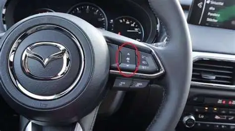

I have a 2020 CX-5 Signature and somehow this is new information to me. Please elaborate so I can learn the location of this switch ...
It's one of the buttons associated with cruise control.
It's immediately to the left of the set+/resume/set- cruise switch. Some useful information can be found beginning at page 4-147 in the 2020 manual. The switches are pictured on page 4-152.

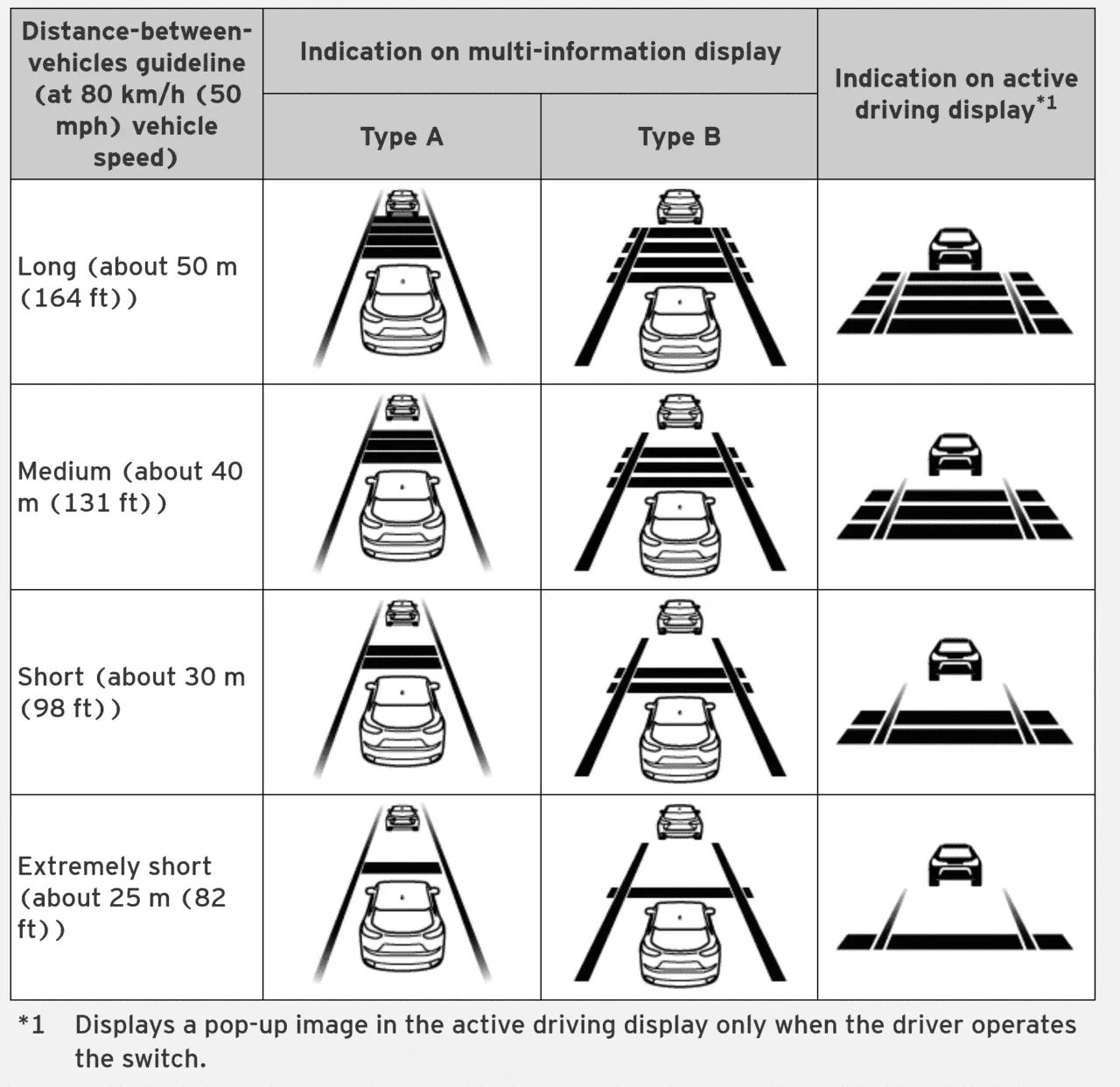

How to set the distance-between-vehicles during headway control
The distance-between-vehicles is set to a shorter distance by pressing the
switch. The distance-between-vehicles is set to a longer distance by pressing the
switch. The distance-between-vehicles can be set to 4 levels; Long, medium, short, and extremely short distance.

"At 50 mph" in the upper left box indicates the distance-between-vehicles is variable within each setting based on vehicle speed.
I wonder if it has to do with time rather than actual distance. The old 2 second rule, or whatever it is.
At 50mph, it's X distance. At 70mph is X+Y distance to equal roughly same time space to vehicle in front.

Here's the Mazda distances for Adaptive CC.
  • Long (four distance bars): about 164 ft.
  • Medium (three distance bars): about 131 ft.
  • Short (two distance bars): about 98 ft.
  • Extremely Short (one distance bar): about 82 ft.
Don't know if they fluctuate based on speed.

See posts #15 and #16 above. Those distances are for 50 mph so evidently these distances are variable by speed which makes perfect sense while not being hard to accomplish. a simple algorithm to construct. Whether the algorithm is optimally constructed for real world circumstances is not something I'm in a position to opine upon since I don't use radar cruise.
Radar cruise with stop-and-go operates at speeds down to 0 mph but only as low as 20 mph under certain conditions including a dirty windshield (or one presumes ice or snow) obscuring the camera. You could run the thing in slow moving stop and go traffic and there have been reports here of people doing just that though I personally wouldn't try it. It's pretty obvious you'd want speed-based adjustments for 20 mphs vs. the max speed radar cruise will operate, 90 mph.
Keep in mind if you're slogging along under 20 mph radar cruise and its stop-and-go may deactivate. If you don't take notice of that fact, however, Advanced Smart City Brake Support which operates down to 2 mph will presumably save you. Or is it one of the other two brake support systems--that's more digging than I'd prefer at the moment.
Those specs are according to the 2020 manual. The specs might or might not vary with other model years, I couldn't say.
