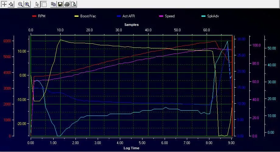

Heres why -AFR's seem to lean to me.
Something is wrong with your firmware/software. It shouldn't be saying "Supported PIDs 0-32". And you don't need the mazda specific PIDs to log AFR. I would reflash your DH to beta9 following Kens instructions carefully. Then log it again.
These are the values you should be seeing for AFR:
@ Idle or cruise - 14.7:1
@ WOT - about 10:1 to 11:1 in the upper RPM range.
@ zero throttle (when you let up on the gas) - 29:1
Remember, the AFR readings are based on the ECU readings from the stock WB sensor. If you can't trust those readings than how can you trust the ECU to deliver the correct amount of fuel?

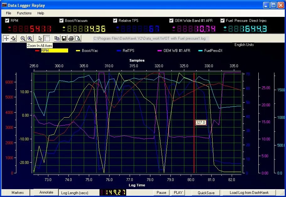

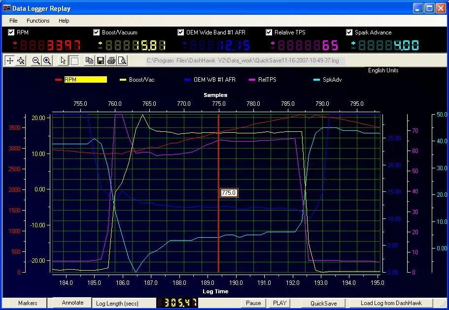

Here are a few of my logs to give you an idea of what they should look like.
12.0 is what regular fuel injected cars under boost should be running on the street. The DISI is new technology and other cars like the VW/Audi are in the 13s and its considered safe. Still a lot to learn with direct inject.

Those are the same reading that I am seeing. I do see 9.5:1 under heavy accel. once and a while.
