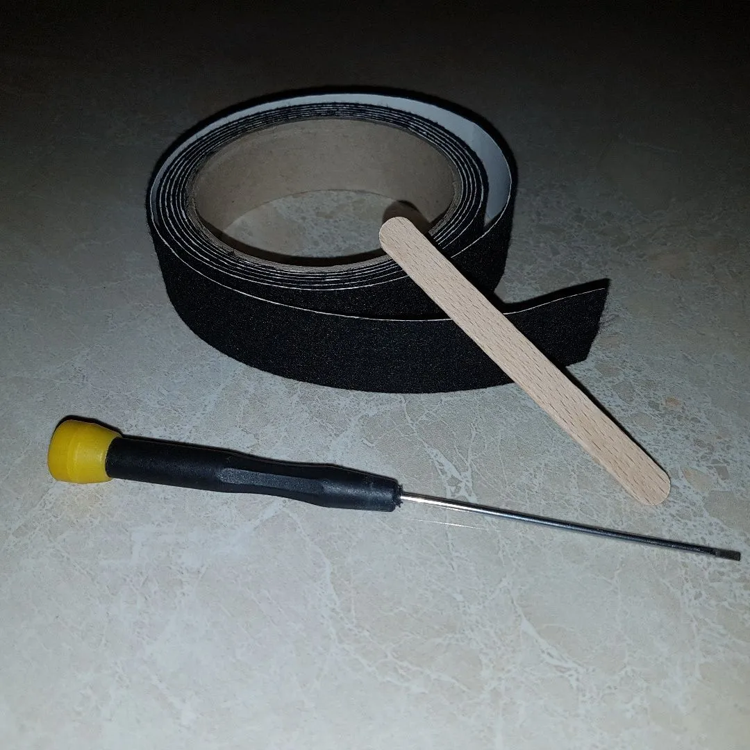

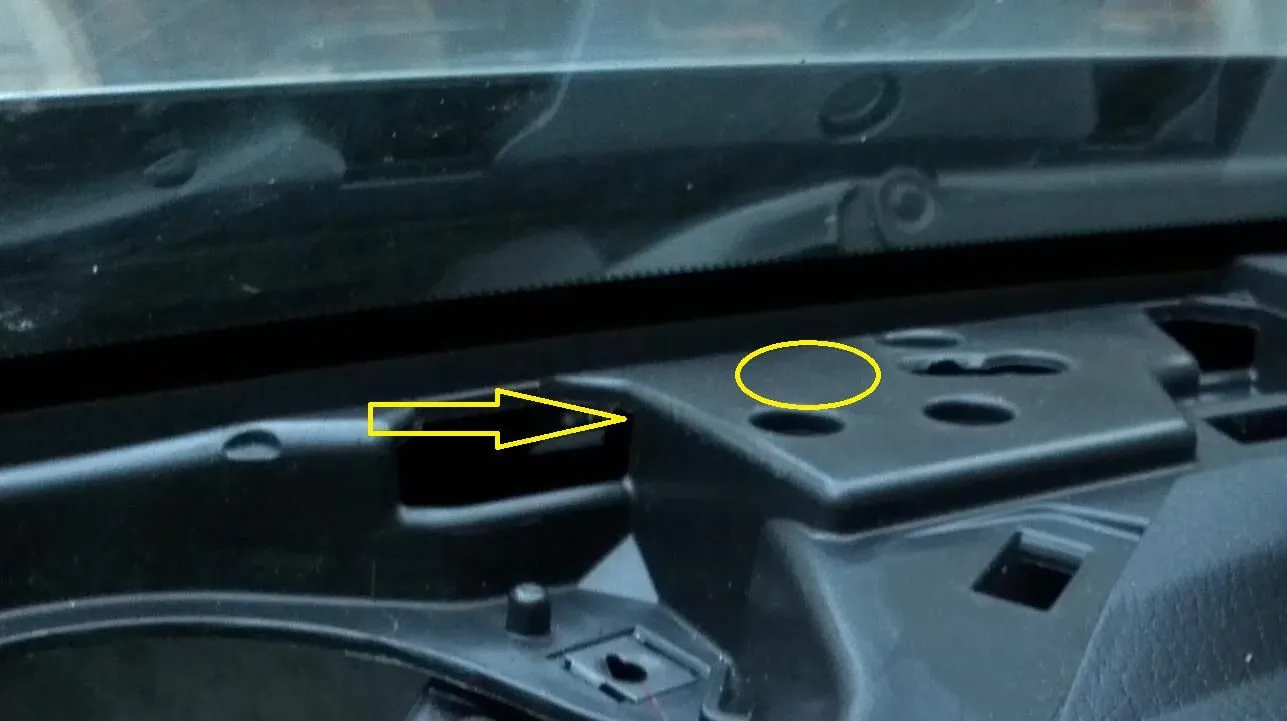

Hi lomo,
Sorry, havent been here in a while. Short answer is yes, I did. The noise is coming from the interface between the underside of the dash, some ducting support directly underneath and the metal bulkhead bracket right at the location circled. Suspect that when the bulkhead is cold, the bracket moves just enough to allow the noise. Mazda must have been aware of this when they issued a TSB to put felt tape on the bracket, however this is insufficient imo it should have been something thicker and spongier like foam to absorb the movement.
I didnt take any photos unfortunately, but my car is RHD anyway so will use a photo from another thread (about replacing the speaker). You need to remove the speaker cover - I removed the a-pillar trim first to get easy access to the side of the cover and just pull it up and off (no point fixing an intermittent noise and leaving a permanent pry mark). I also removed the speaker as a precaution just in case something slipped and I damaged it. Use a good flash light to look into the top right-hand corner of the opening indicated. Now this is fiddly but you should just about see some plastic sidewall its difficult to say what it is but it appears to be some sort of support for the ventilation ducting. The top of this support is contacting the underside of the dash. Insert a long, narrow screwdriver into the opening and gently pry a small gap between the top of the plastic support and the underside of the dash there should be about 1mm of play. Leaving the screwdriver in place, you will need to insert a small wedge into the gap you have just created before pulling the screwdriver back out. I used an ice-lolly stick wrapped in felt tape and pushed it in beside the screwdriver blade as far as it would go (about 50mm). I left just enough of the stick protruding out of the opening to be able to grab it again if I ever need to remove it in future and cut off the excess. Dont leave too much excess or it will catch on the circular side-wall on the underside of the speaker cover but you can leave some, it should not interfere with the tab on the speaker cover that actually engages in the opening.
Have had a few sub-zero degrees C mornings this winter and not as much as whisper from this area of the dash sorted :-)
