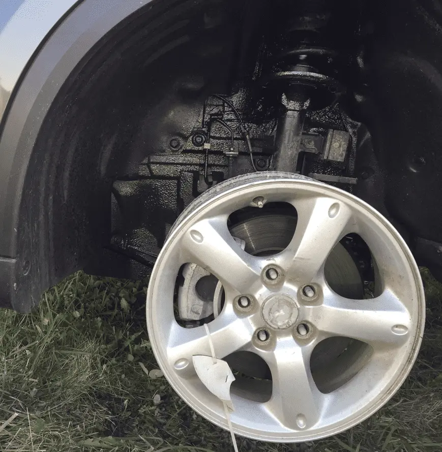

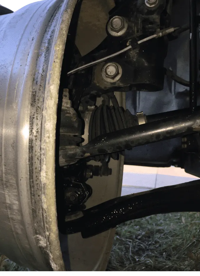

Before ordering new 16" rims, decided to take one last look & make sure which offset would fit.
Really don't want to end up with rims that don't fit.
Went to junkyard and got a beat up Mazda Tribute 16" x 7 rim with ET45 and tested it out. This will become my full-size 16" spare.
Pics are attached for anyone interested in downsizing.

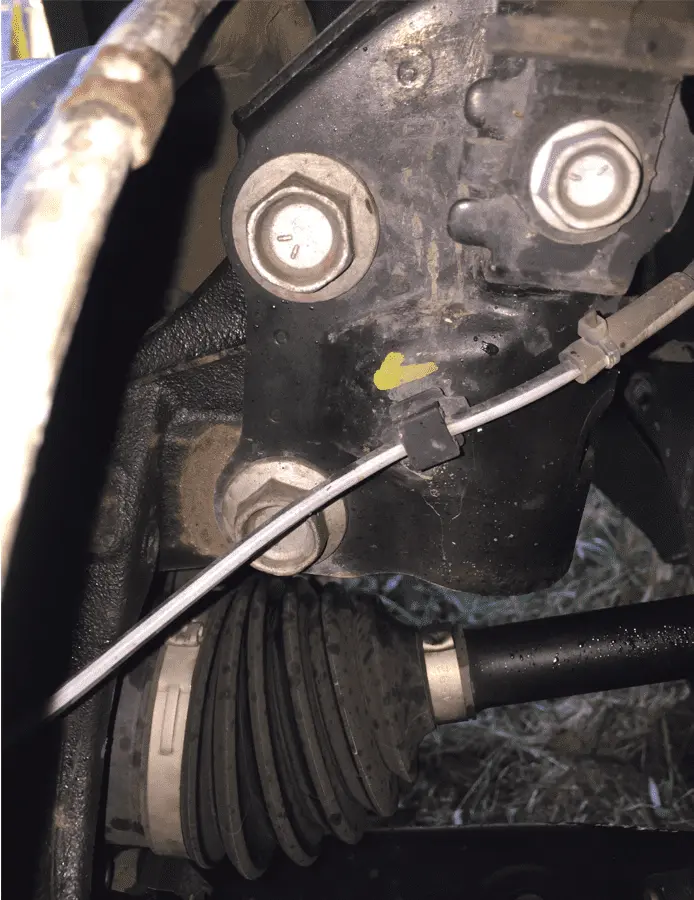

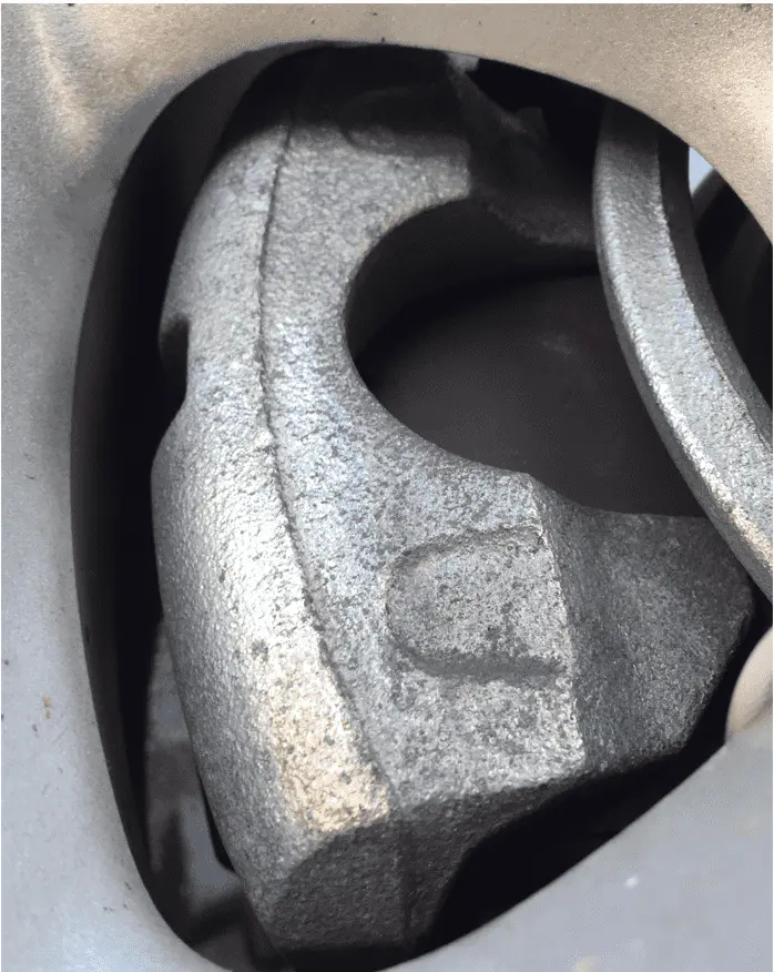

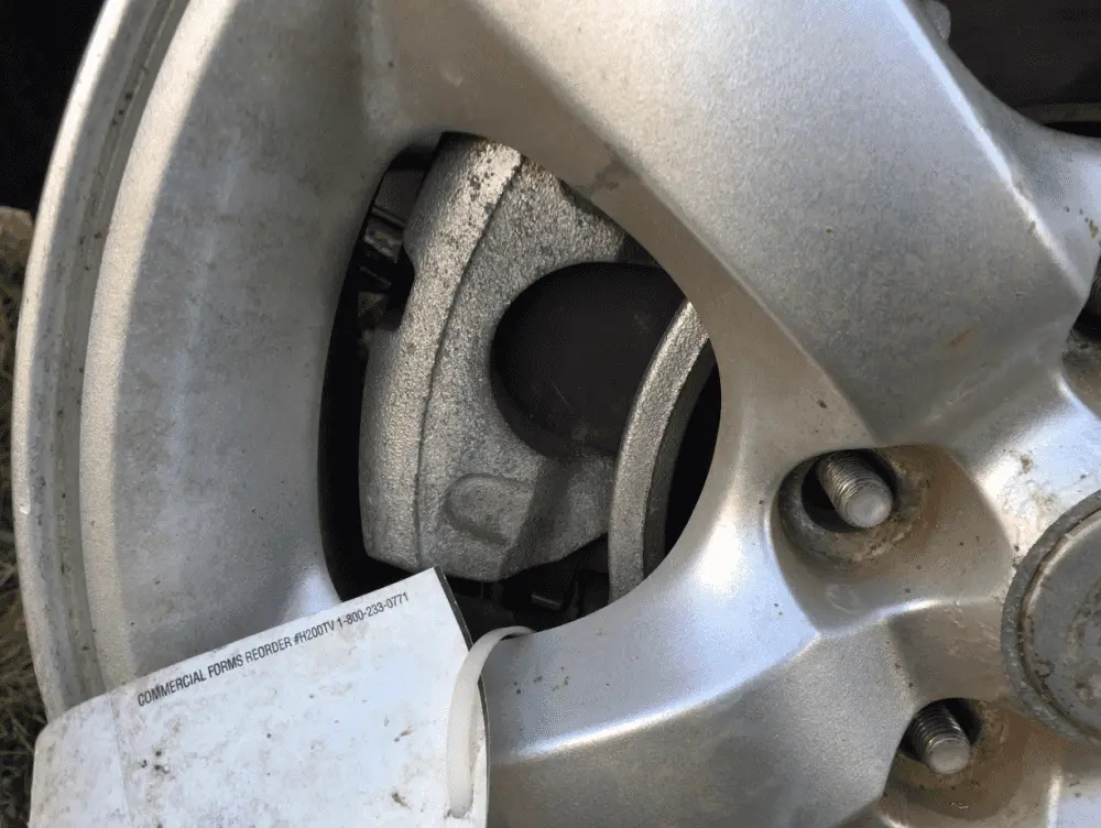

In my case, needed to worry the wheel rubbing the calipers & suspension more so than a wider tire.
The 16 x 7 with 45 offset works and clears the calipers, suspension & lower control arm.
The offset can be pushed out to a 42 or 40 although it will affect your scrub radius slightly. Pushing the offset in any closer(i.e. 47 or 50) or going with a wider wheel (i.e. 16 x 7.5, 16 x 8) is possibly going to hit. If you want to go a little closer, you need to stick with 17", 18" or 19". If you want a wider wheel,
you need to get a rim of et40 or lower, push your offset out to et40/lower using spacers or keep your 17 inch/19 inch wheels.
Now need to decide between 16" rim with et45 versus et40. The ET 45 will keep same scrub radius for me so will be making decision this weekend and ordering tires tomorrow before sale ends.
How much space? look at the pictures.
*This is for non-turbo 2018
It appears more than enough space anywhere
from 1/4"(6.4 mm)to 5/16"(8mm) all around.
*These are rough eyeball measurements,
didn't have my tape and was too tired to go get it.
approx 5/16"(8 mm) from outer lip/barrel to caliper.
approx. 5/16"(8mm) from inner lip to frame/suspension
approx. 5/16"(8mm) from centerdisc/spoke to caliper side.
way more than 5/16"(8mm) from barrel to lower arm.
Hopefully this helps more people who want to downsize as
downsizing information is limited.
