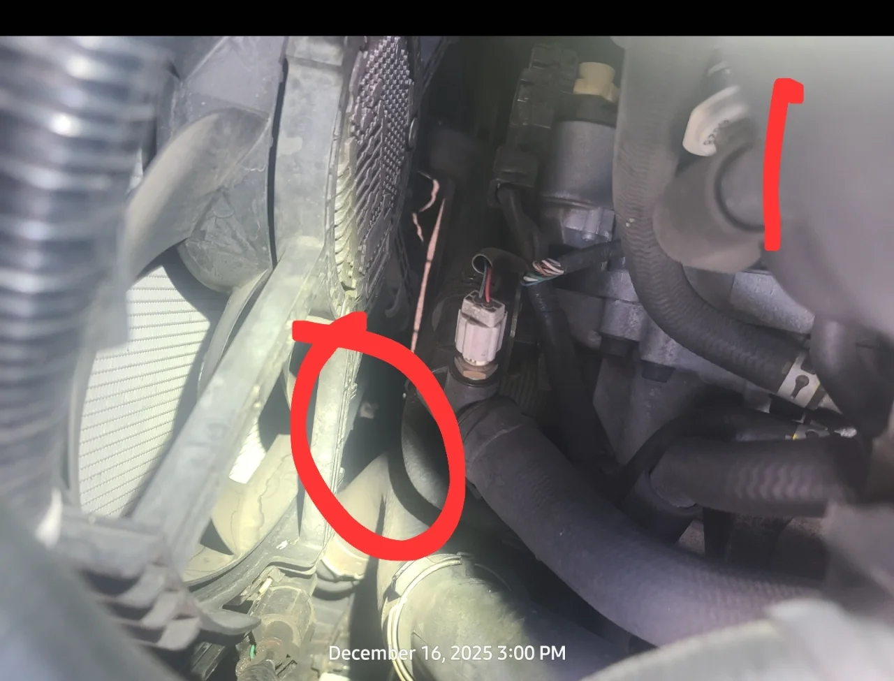

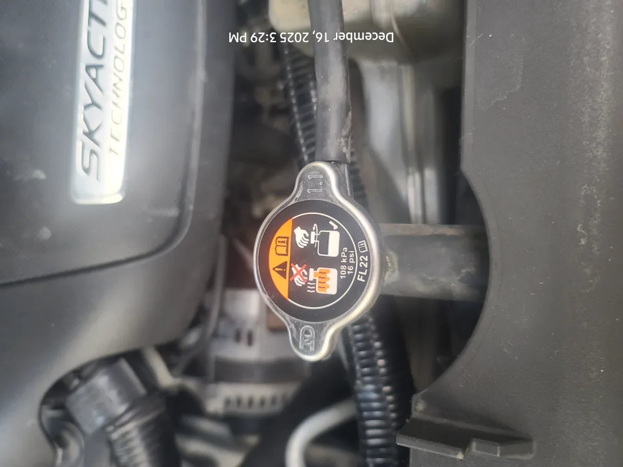

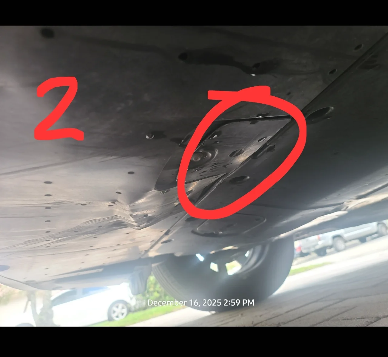

Once engine is cool down. You need to go below and remove black cover . It's on driver side ( photo #2). Attach the open plastic water bottles. SO it would splash out and downward. If arm is long enough, you can then remove plug via top of the car (photo #1) . If not remove from below. Let it drain into pan. You can take it slow and clean for a while. Then open top cover (the one that had F22 / hot lable). It would speed things up.

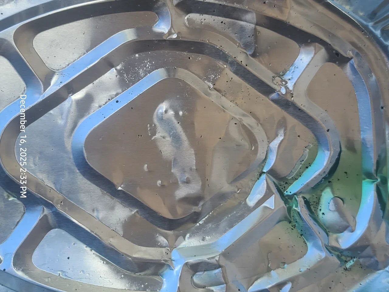

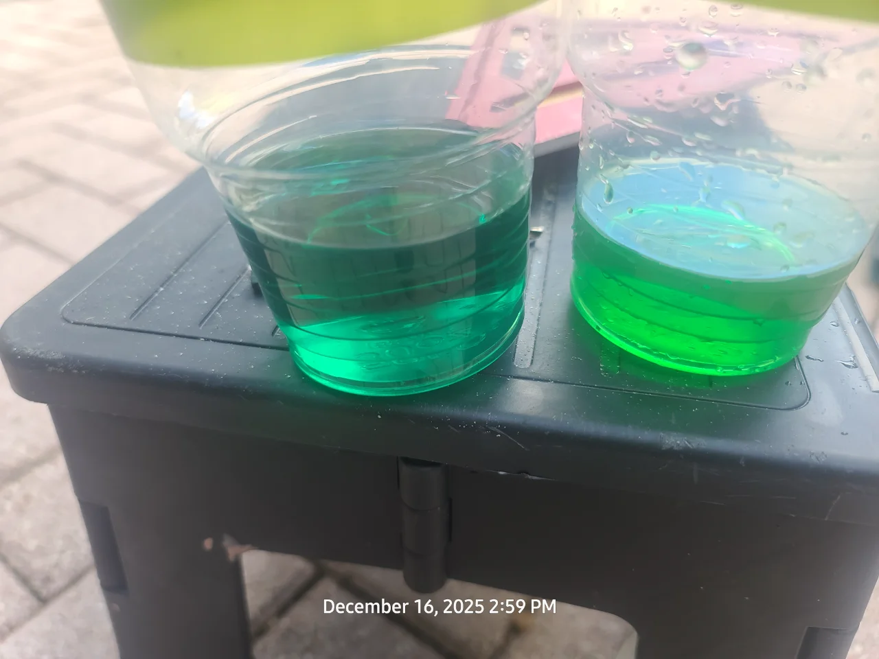

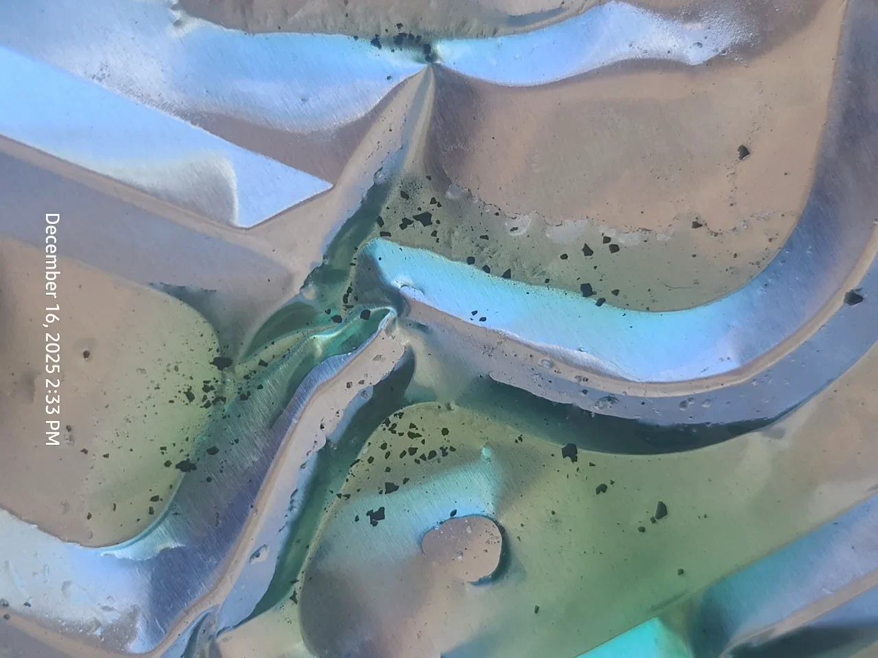

Attached the photo of my job at 126k cx 9 2016. Darker green is oem. Pan show some stuff in it, not much. Under $30 and less then 1 hour. I'll do another flush later.
