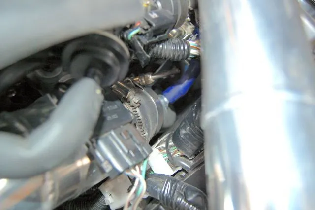

Where is does the sensor plug into it? Cant really see it from the OP, but it appears to be a bit closer to the battery box than on the stock.

You can see where the MAF is plugged in in the OP pics but here is another for you.
