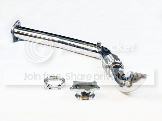

CorkSport downpipe
It has a Divorced wastegate pipe. Overall I think its good/excellent. Im probably gonna get it since I already have the Turbo XS TP.. No point in me getting the whole CPE DP since I only need this piece :). Thats my OP

I dont know if im going to keep it looks hard to install and the shops want $450 so if anyone looking for a dp PM me thanks
install is honestly like 3 hours if you have basic tools. there is not a bunch of hard work involved.
I've heard only good things about the ebay dp's.
http://cgi.ebay.com/ebaymotors/05-0...r_Truck_Parts_Accessories&hash=item1e5e7adb94
For $125...w/an extra bung for wideband, its a good deal.
