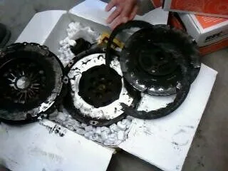

I had the EXACT same problem blender.. I got my car with 17000 miles on it and it was messed up from the start. here is what it looked like when i got it replaced with 21k miles. (i did not launch the car at all)
