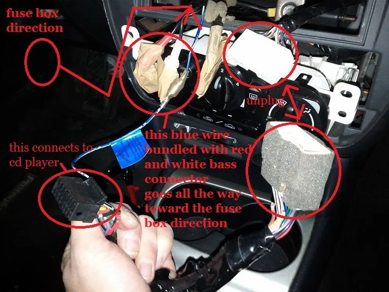

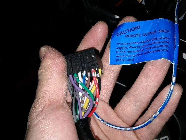

but i am lil confused about the blue wire connected to the cd player (is it for factory Key-less Entry remote or cd player remote or else)

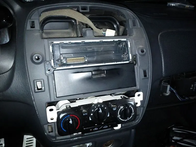

after taking the cd player down, my keyless entry remote kind malfunction (not sure if its because the battery is low or what) the remote cant lock cars, i have to manually lock all doors before clicking lock button
i got a new DVD GPS mediaplayer installing
i dont know if i should connect this blue line to somewhere, not sure which line to connect to.
or should i just plug my cd player back in and see if keyless entry remote gonna work first?

the bass and blue wire bundle are wrapped in black electric tape/tube. might go from fuse box toward the rear kenwood bass? not sure if bluewire goes somewhere else?
The blue remote wire is a signal to turn on an accessory like an amplifier for the stereo. It has nothing to do with your alarm.
so this is something that related to cd player's remote right?
after i removed cd player , installing a gps dvd double din one
this become useless thing? should i just cut it and electric tape the end ?

the blue wire is for an amplifier if you are running subs....It has NOTHING to do with the car or a remote for the radio....If you have an amp, there is a place on the amp for a "remote" wire....if you don't have an amp, tape the end of the blue wire off and tuck it back.....your keyless entry, there could be several things going on there....could be the battery in the keyless entry remote itself, most likely not your car battery, could be the reciever for the keyless entry not responding....does the lock button work on the door? or do you have to manually push down each lock? if the button is NOT working it could be your door switch, could be lock actuators (not likely all of them going bad at once though) I deal with drivability at work (machanic for cadillac) if you give me some more details about whats going on with the keyless entry I could be able to diag it better

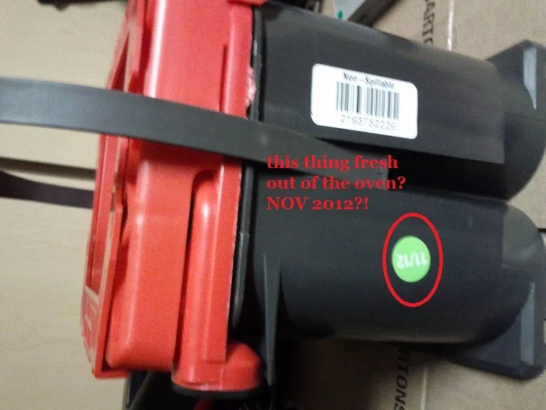

just got home with a multimeter and a optima red top battery (11/12 means nov 2012?! LOL i saw the other one with 09/12 and one without any sticker)
deadly tired to carry this beauty on foot =,=||| altho its only 5mins walk

this multimeter only has 1.5-12v load test, i should not use it to check load test with engine on, or check alternator?
last time i dced negative cable and reconnected it, trigers a spark and turned on the alarm system right a way. is it normal?
btw old battery is MotoMaster Eliminator from 2008, cant hold voltage anymore, always drops down to 6volts after a day or 2 with alarm system on,
