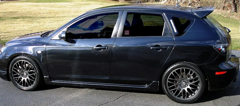

Bought The Tenzo Type-M
Damn, I want those rims in Charcoal. I think it would look better on a black.
And I also am looking to wrap those with Nitto InVo.
where in martinsville you at? I wanna steal em!
+1 on that, somebody buy the charcoal so that I can be more pissed that I dont have any money.
Is there any chance that someone can photoshop these bronze so we can see what that would look like? I have a black ms3 and was looking at bronze or gold.
heres a photochop of the rims gray
I thought there was zero rubbing, but if i completely lock the steering wheel then the tire will just barely touch that plastic wheel well liner. Not an issue at all considering the steering wheel is only in that position at low speeds
so today i was driving with me and a someone up front and two guys in the back. there was definitely some rubbing. I dont think there is any problems without extra weight but when i do then it rubs pretty easily. I need to get the fenders rolled soon so i don't wear down the brand new tires anymore. will most body shops be able to do this?
