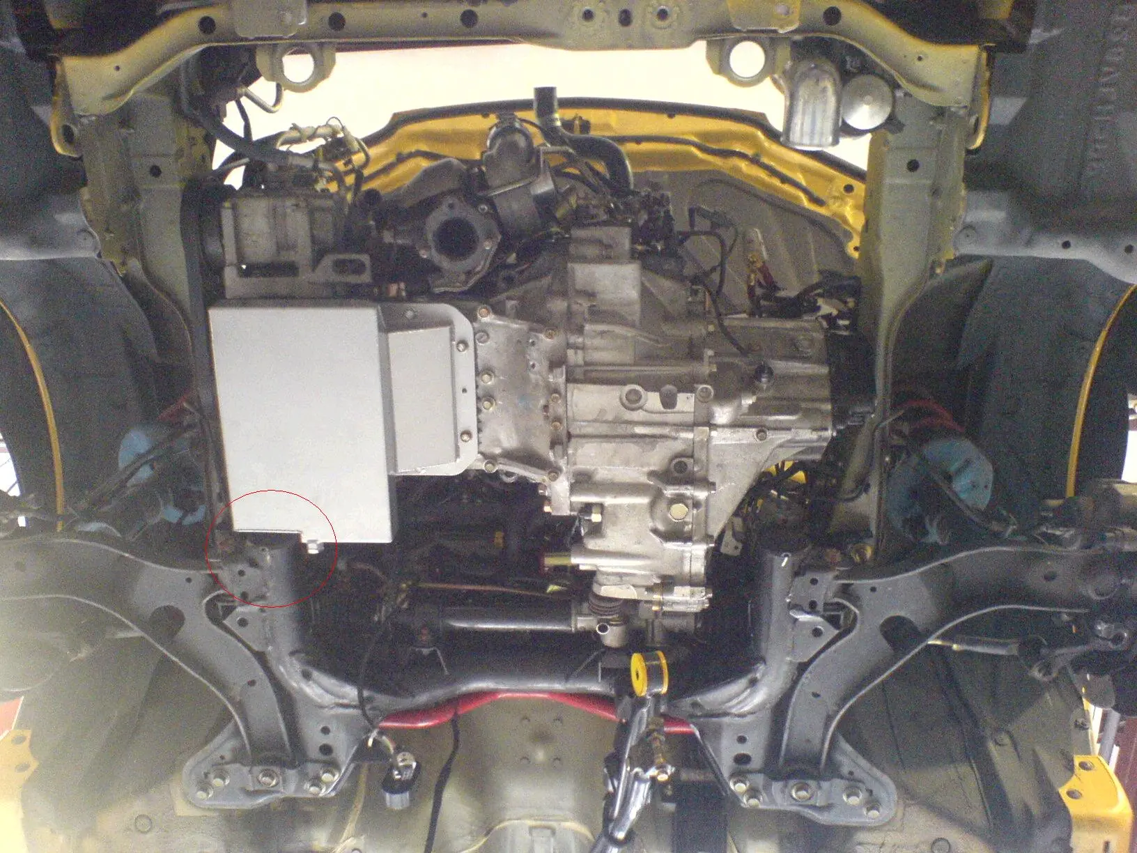

LOL, what you guys have almost no clearance whatsoever right there to the right of the drain plug either? I almost wanna just ditch the pan altogether, but I already paid for it and a baffled oil pan with higher capacity is ideal. If all my motor mounts were not solid, there is no way I would leave it on the car. If the motor was able to move it seems like it would just rip the pan right off of there.

Heres a pic of the clearance issue. It's circled in red. Sorry the pic is kinda bad.
