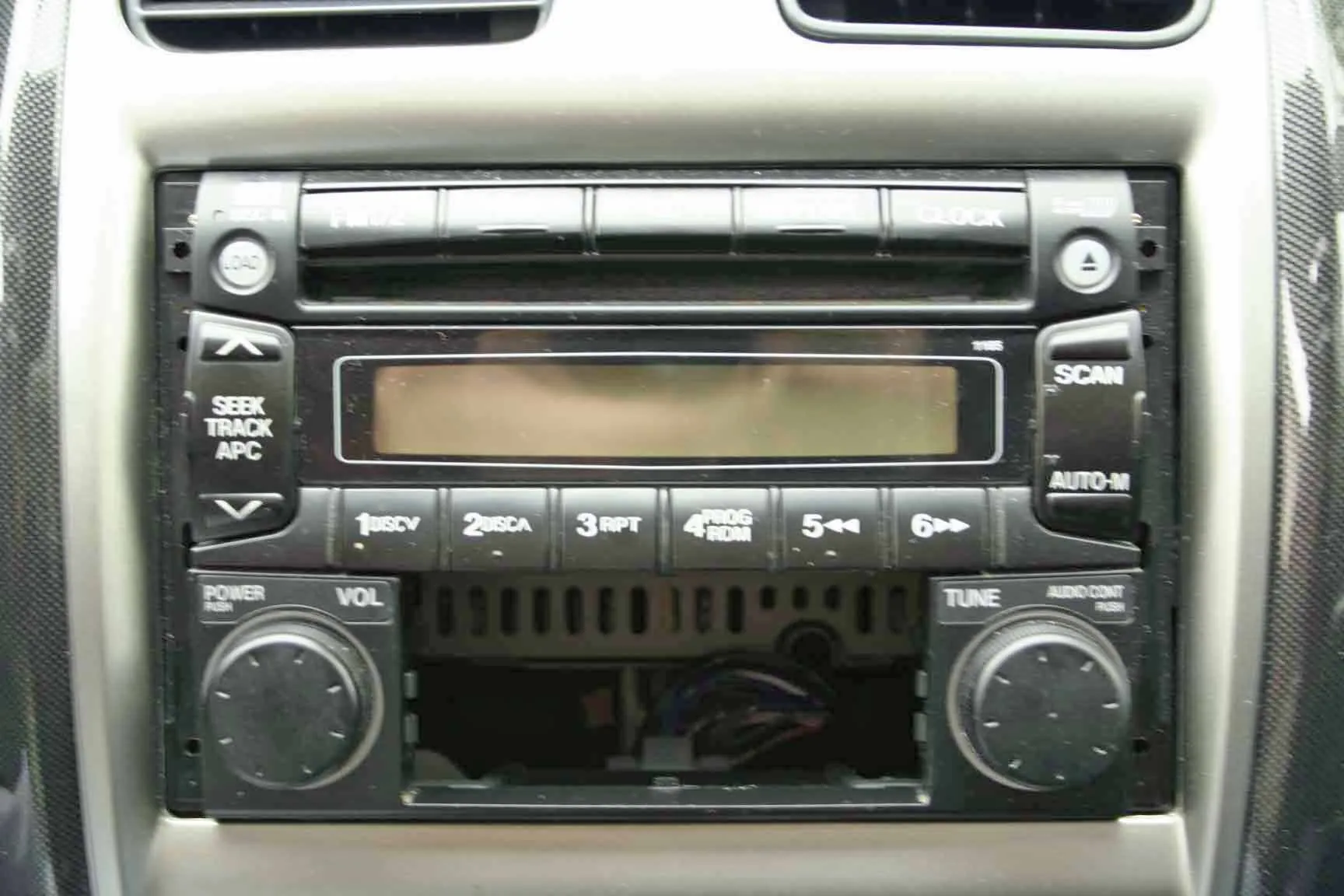

Use a small, flathead screwdriver to remove the optional MiniDisk faceplate.

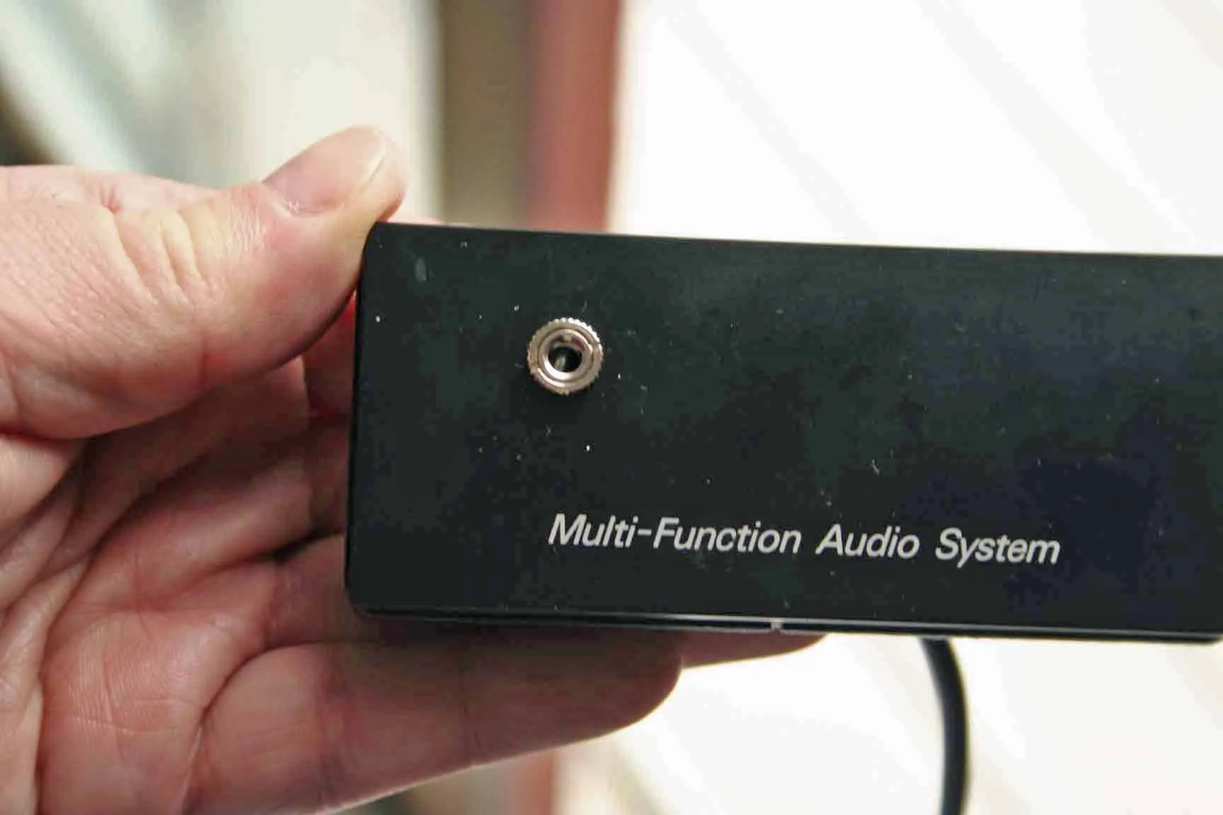

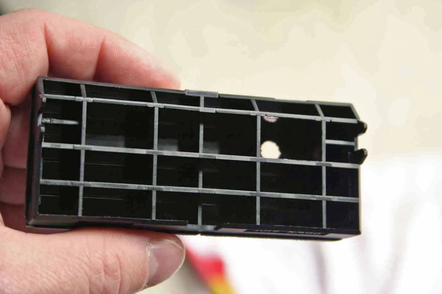

I just used a tiny X-acto knife and twirled the point around. The hole doesn't have to be perfect - the finishing nut will cover any small irregularities. You will note that the back limits the placement of the jack. I suppose a Dremel would solve this problem, but I was doing this rather low tech.

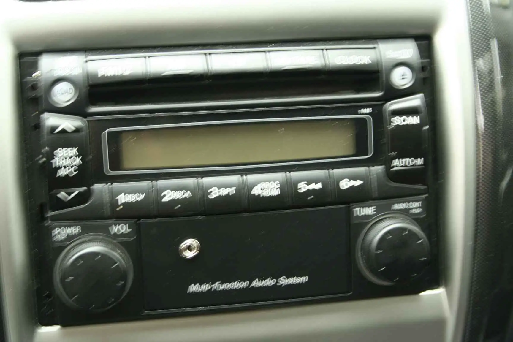

What would I do different? I'd put the jack closer to the tuner knob than the volume knob. I put a right angle adapter in it and that helps alot.
But the iPod works like a charm by using the MD/Tape button. I'm very happy with the results of this little project.

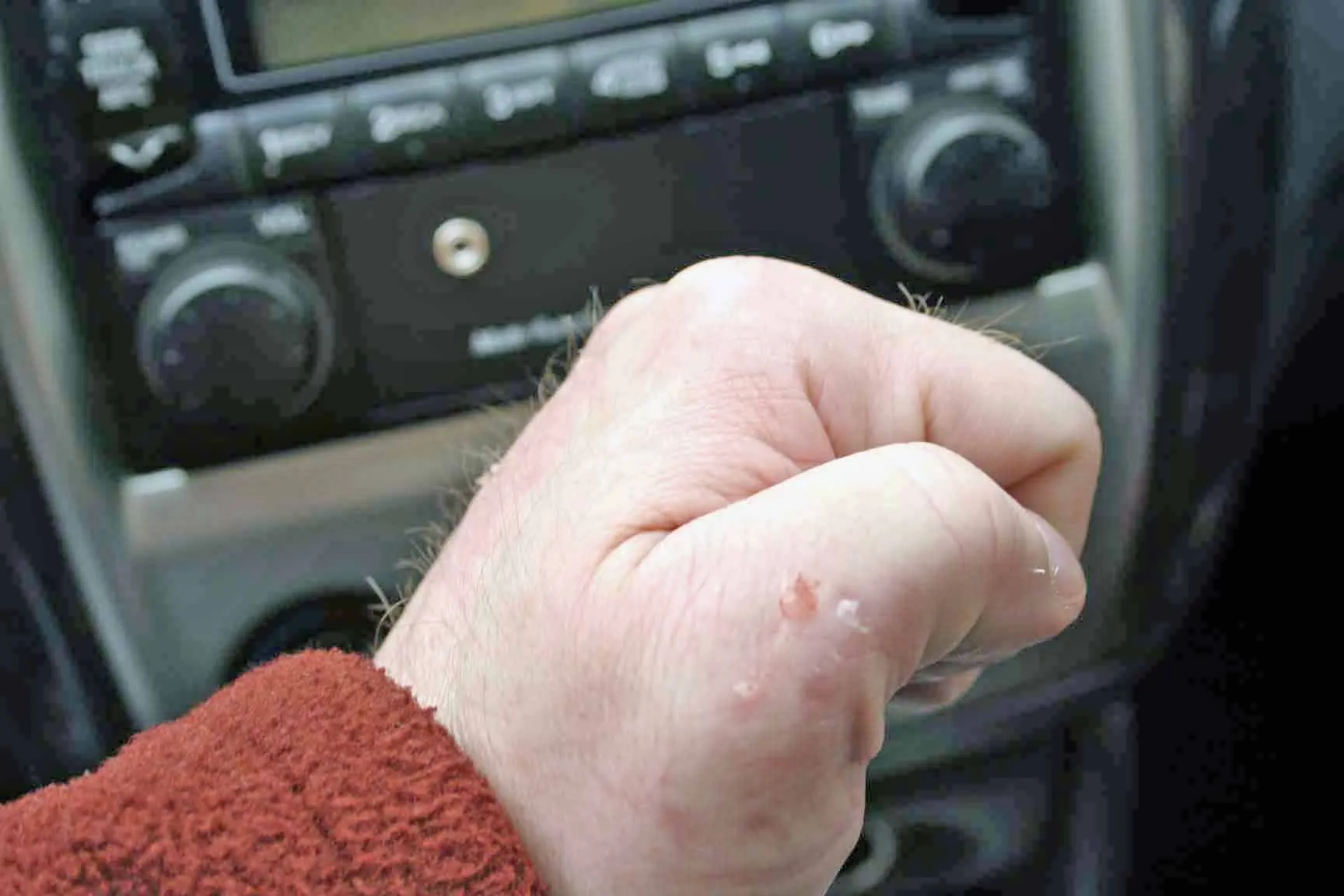

It was a little hard getting the part aligned propertly through such a small hole. It's not too hard to get it in there when not using the sticky tape stuff that is attached to the part, but I think if you don't use it, the Auxmod may disconnet over large bumps. When using the sticky stape, it feels very secure. Anyway totally scratched up my hands getting it done, the tape tends to stick before you get in lined up properly and I had to unstick and restick it about 3 times... It's probably best to get a girl or a friend with small hands to get it to it's final resting place.

So far, overall it's an easy install, if you don't mind a few srcatches which could probably be avoided if you prepare a little better than I did, like having some good, small, long handled gripping tools or even small, nimble, strong tongs could work You could also remove the head unit and avoid having to use the small hole altogether if you wanted to.

Once I was satisfied with my wiring job and it felt solid... I drilled my hole into the plate for the jack, put the jack into the plate, screwed on the locking ring, plugged in the other end of the cut male/male cord into the Auxmod (this time using tongs = no scratched hands), pushed the plate back onto the HU and it works great! Lov'in it!!
FYI - as he mentioned on the original how-to, I placed my jack closer to the tuning knob, so that the cord doesn't get in the way of the volume. No, you cannot centre the jack on the plate without some serious modding of the plate. The back of the plate is covered with ridges that leave little open boxes on the back... and only a few of these boxes will fit the chunky electrical tape covered jack. Make sure you test before you drill!
