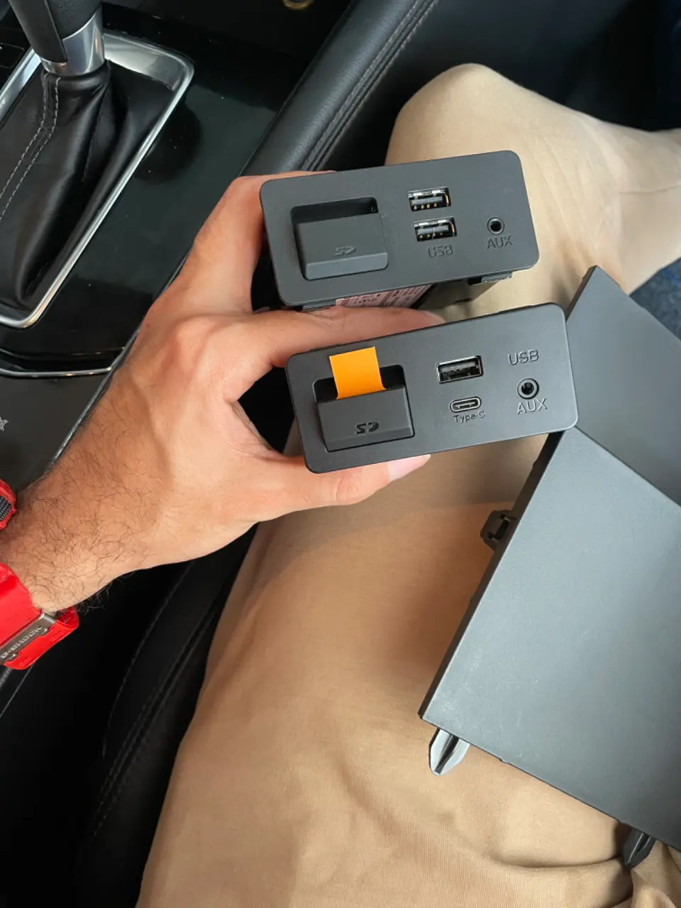

So later then you have to buy/install the new usb/adapter with carplay feature…. Your original usb adapter (the one that came from factory in your CX5 DOES NOT SUPPORT CarPlay/Android Auto…
Here i show you what im talking about you need to buy
