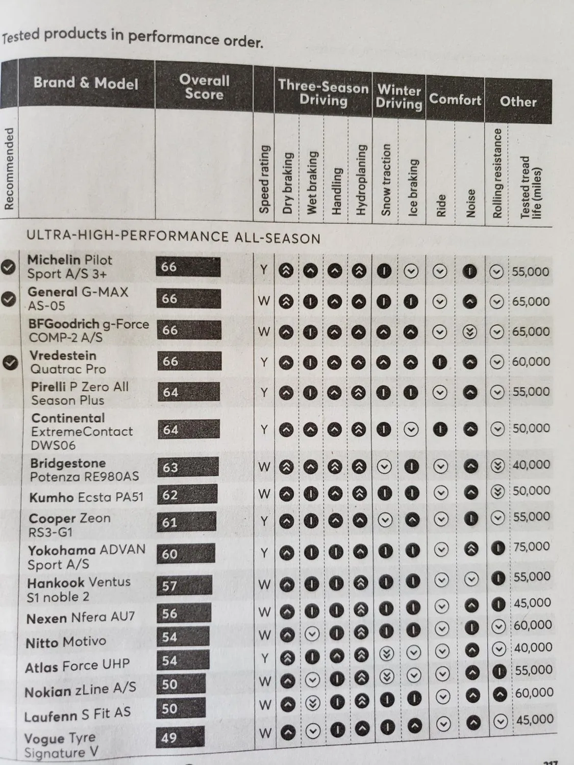

According to Consumer Reports' extensive tire tests, the best handling Ultra-High-Performance all-season tires for your car are the Bridgestone Potenza RE980AS. The added bonus is that their noise rating is better than average. The slight down side is snow traction, which is below average. Tread life is 40,000 miles compared to 55,000 for the Michelins which are tied with three other makes and models of tires. (See attached image.)

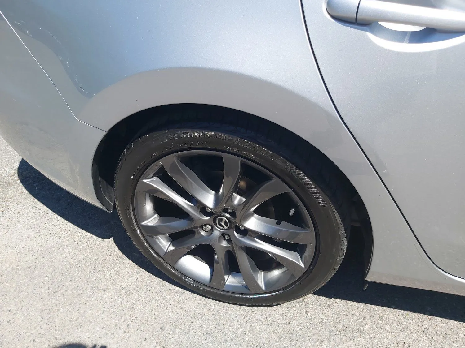

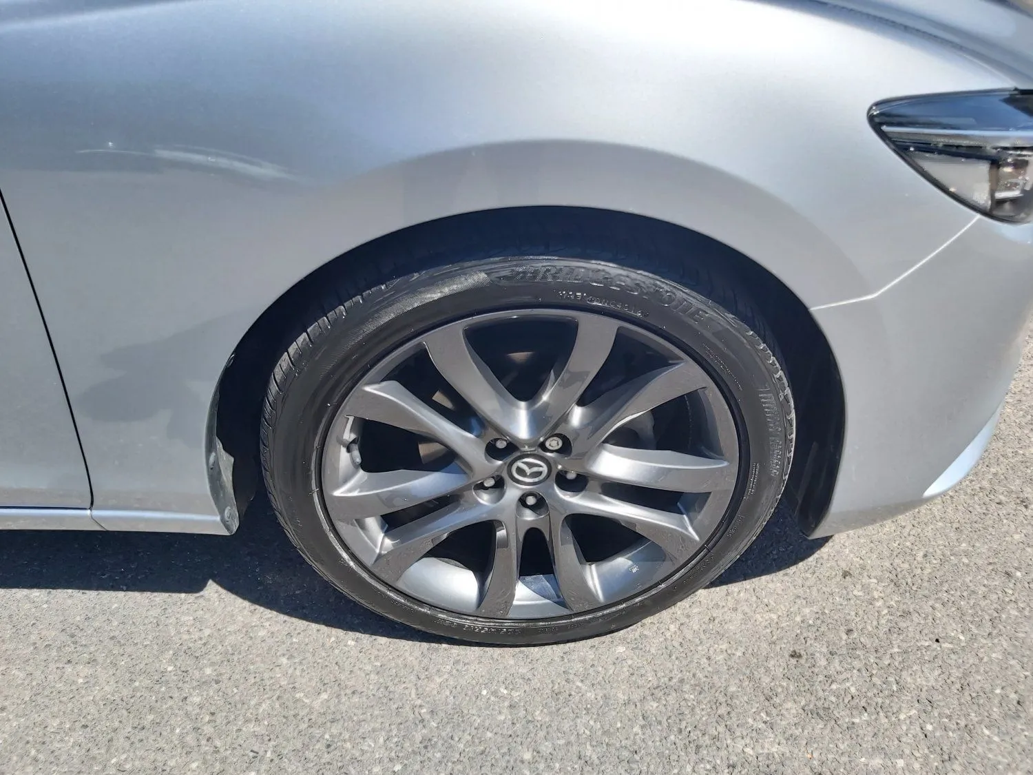

Hi, the OEM tyres over here in the UK for the 19" alloy wheels are Bridgestone Turanza T001 225/45/19 92W. Bridgestone tyres are generally wider and offer some reasonable level of rim protection. I have covered 17k from new and still running on the original tyres, which have about 6mm thread left at the front. The tyres at the rear are like brand new, these tyres are wearing very well and I think I should get plenty more miles out of them.
I give Bridgestone tyres a good score, I'm very happy, the tyres look nice and the thread pattern is good too. Road noise is not bad either, so thumbs up.
I give Bridgestone tyres a good score, I'm very happy, the tyres look nice and the thread pattern is good too. Road noise is not bad either, so thumbs up. View attachment 226940View attachment 226941View attachment 226941

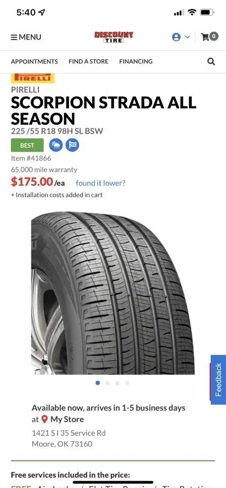

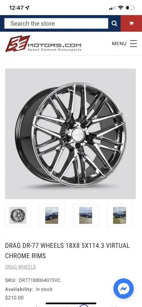

I am dropping off the 19” wheels for 18”. To maintain accuracy on the Speedo, I am going from 225/45R/19’s to 225/55R/18’s. 19” tires are ridiculously high. 18’s? Not so much. Pic below.
Wheels are chrome Drag wheels DR-77’s. Also pic below. Will attach a pic of the ride with her new shoes once everything arrives and is installed. OTD price was about $10-15 over $1,500. Got the veteran 10%, the extra 5% on their Daytona special, price match on the wheels, certificates, concentric rings, and mounting, balancing, $75 Pirelli rebate applied, etc. And as a disabled vet, I didn’t have to pay sales tax. Tires carry a 65,000 rating, 700 A A. (Rubber a bit harder than most.)
