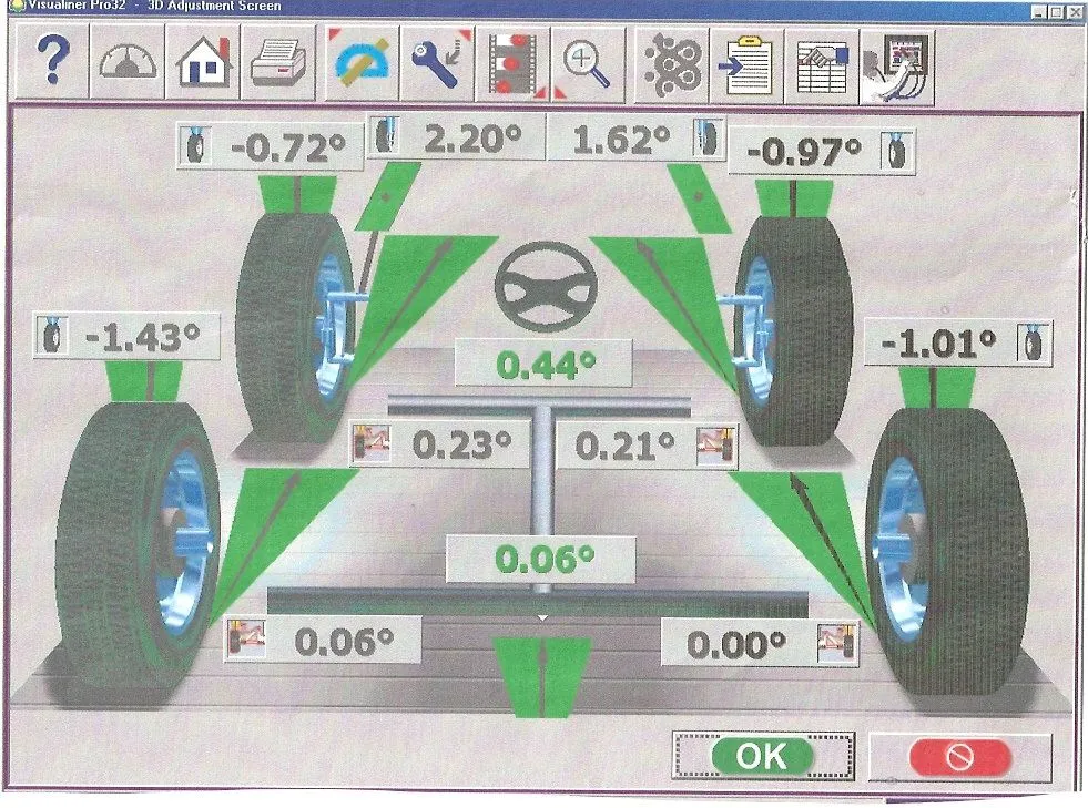

okay so i had Mazda do an alignment on the car today. I didn't have any pulling issues, but the inside edges of my front tires were wearing badly, leading me to guess that the toe was out of spec....
well i was right, and when i asked what they had to change they said the front toe. However now the car pulls to the left. Also, even though perhaps no one would notice it except for my anal-retentive self, the steering wheel is marginally crooked when going straight.
They gave me a sheet with the specs, on which i was able to figure out what numbers were toe and camber (i think), but i was wondering if anybody could help me out with what all these symbols and whatnot mean.....
also it seems like some of the settings are perhaps a bit too different from the opposite side, but i don't know much about alignments. I've already talked to them and will be bringing the car in again tomorrow to have them look at it again....

It looks to me, though im not used to that machine either. that your caster is greater in the right side, thus causing you to pull left. though in spec they vary pretty greatly from each other side to side.
get it realigned and tell them that its now pulling, it should be covered

the side witht he most positive camber ive read can cause a pull, which is slightly seen in ur sheet. and road crown goes to the right, in which you would pull to the right

Its always been to the left. We rotated out the tires since all the specs checked out, and it might've pulled to the left a hair.... but it was damn hard to tell. With the tires back the other way, it pulls left. Or i guess rather it drifts left.
Check your front top plates to make sure that the green dots are aiming outward toward the front or the back. Depending on where the dots are aimed at, it changes the camber and caster on the front. So if they are not symetric, it unblances the car quite a bit.
