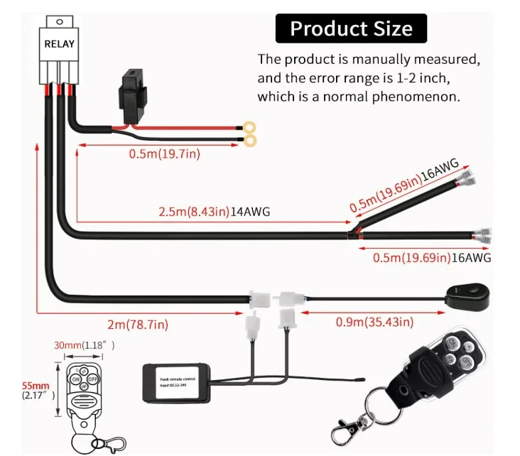

I also did not want to drill through the firewall to install aftermarket rocker switches so I found a pre-wired harness with remote key fob.

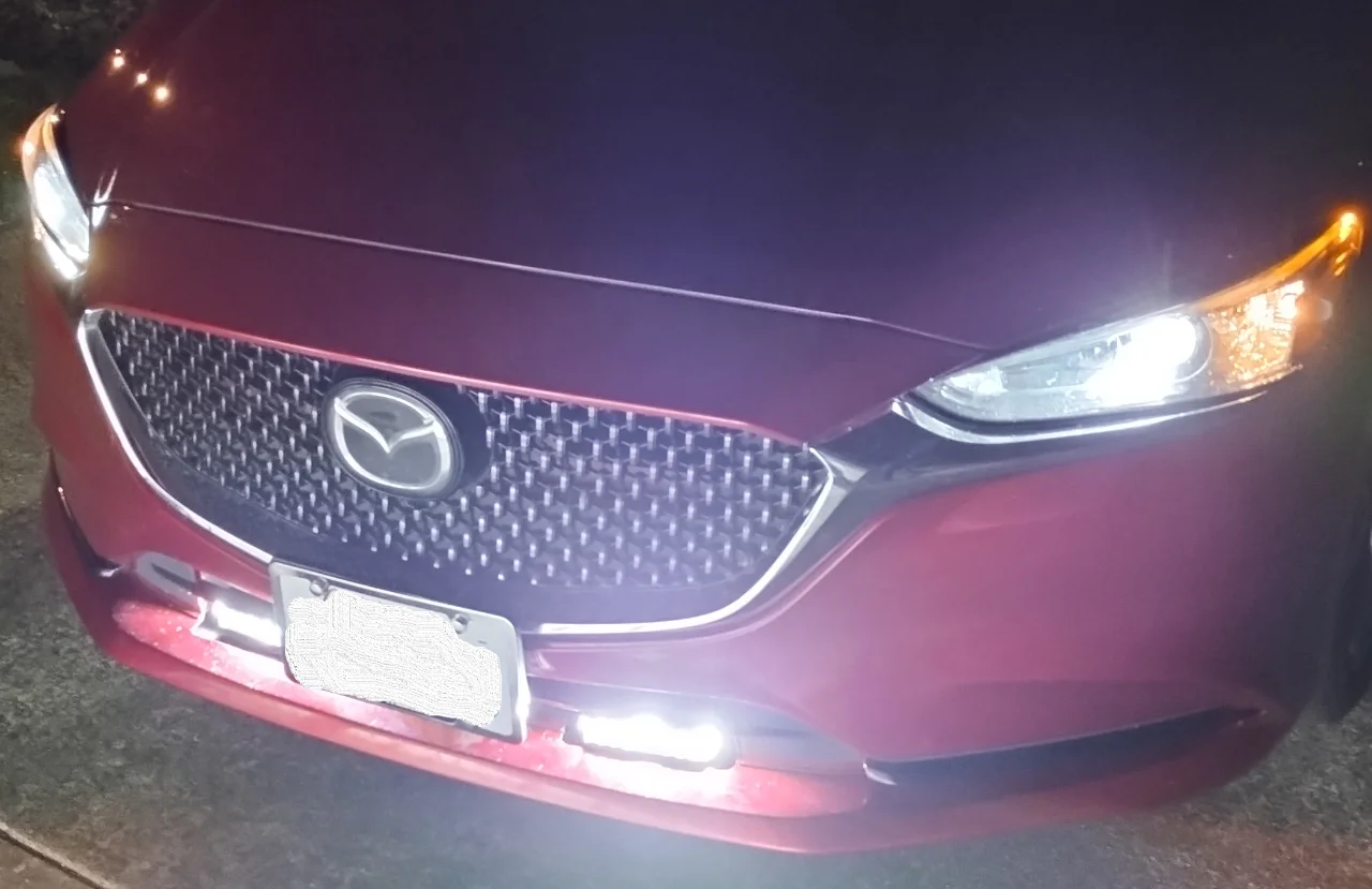

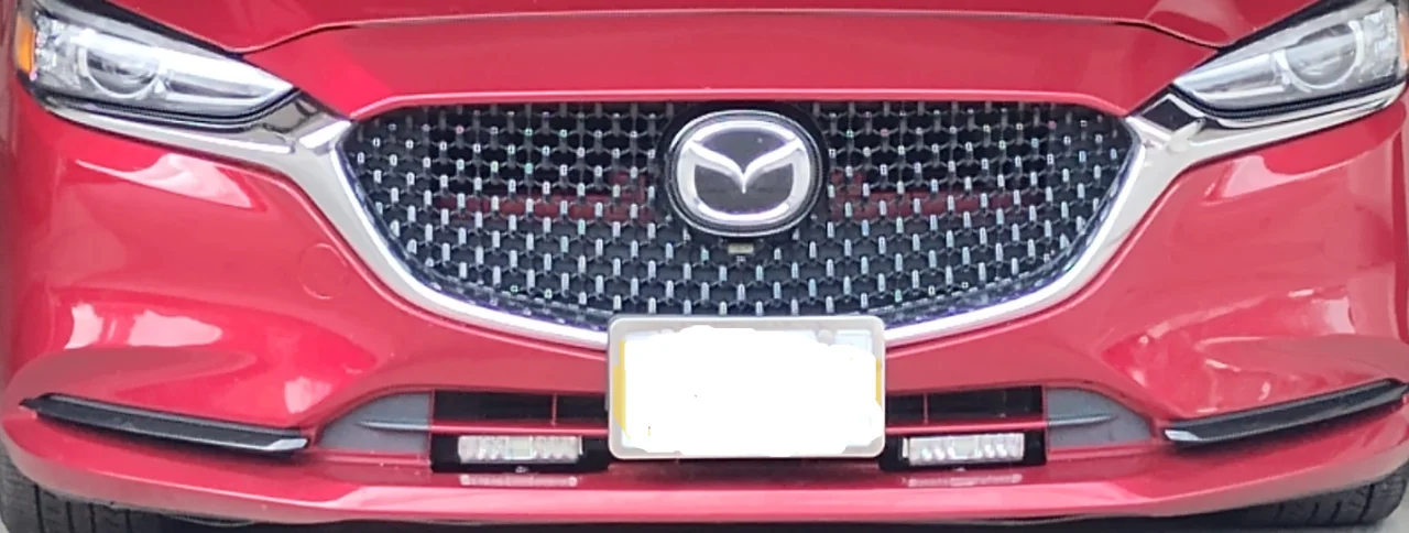

After laying out the harness in the engine bay, and installing the Lights in the lower air intake duct with minimal modifications, I was quite pleased with the outcome.
If you to are interested in doing the same and are willing to put in the extra effort (~4hrs) , this might be something worth your while. (see results)

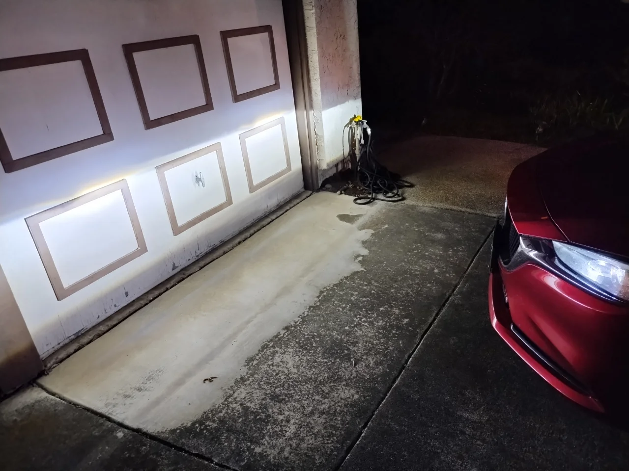

Low beams only

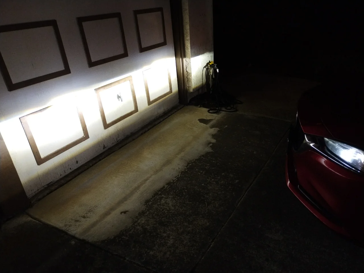

Low Beams with Aux lights
