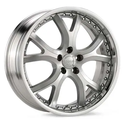

2.) Per the Tirerack selector: Wheel is Moda-210 20x8.5, 35mm Offset, 5-114 Bolt, 6.18 Backspace, 2-Piece Forged-Rim/Cast-Center.
Why do wheel makers these days always over complicate their wheels with unnecessary details like dimples and rivets?
