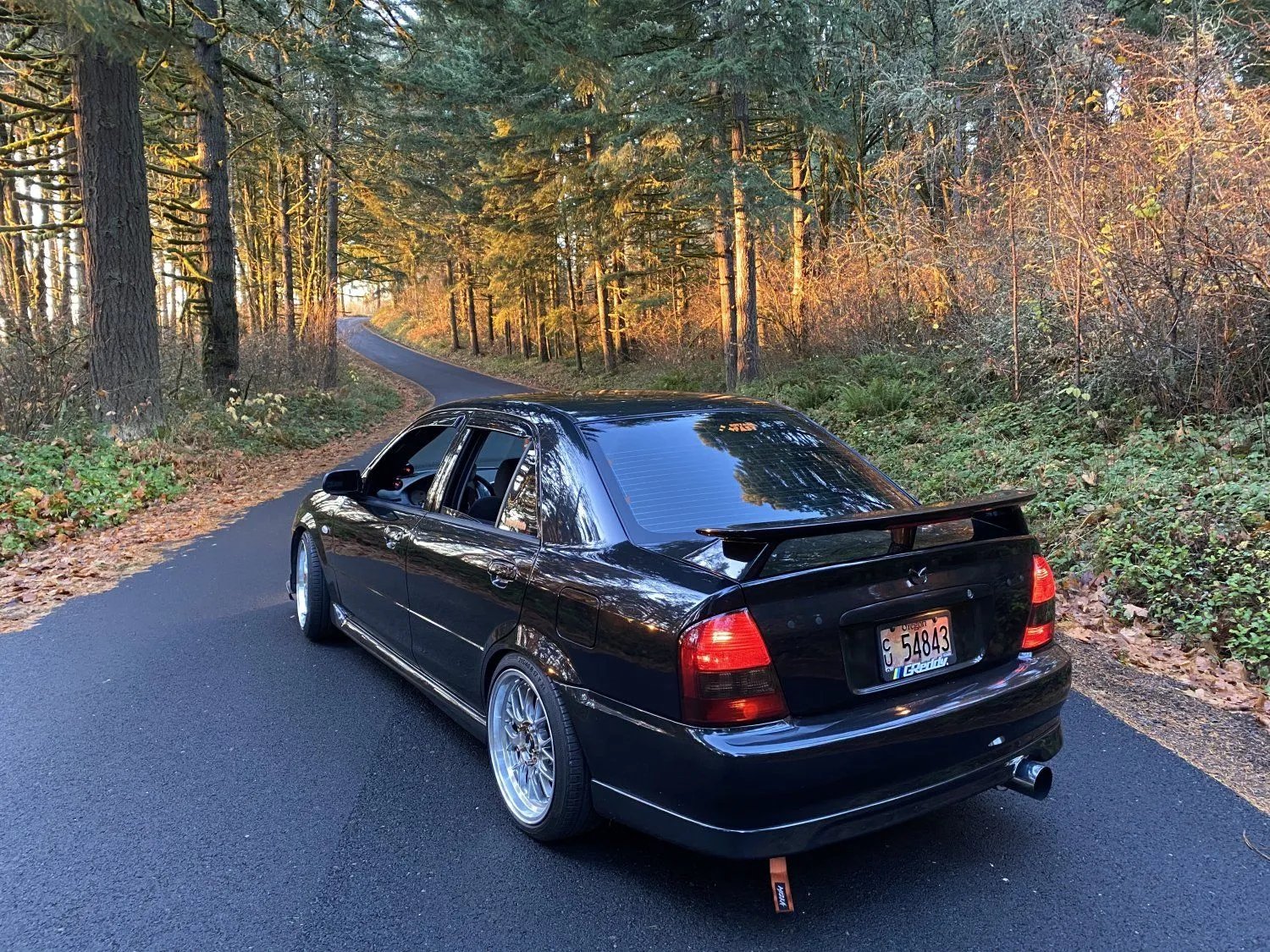

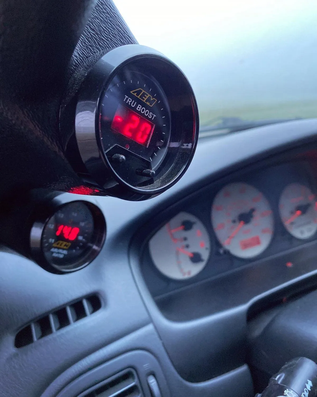

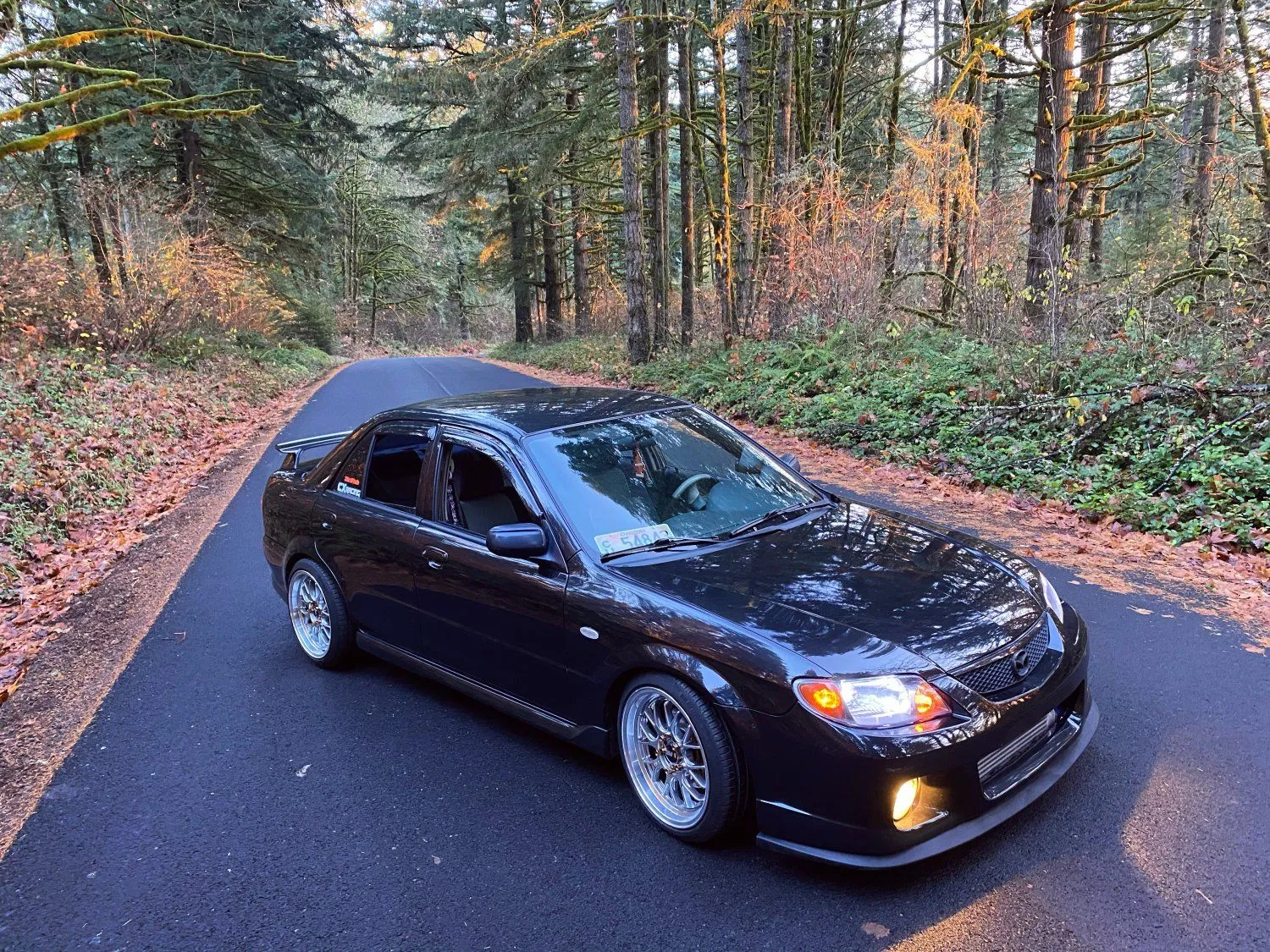

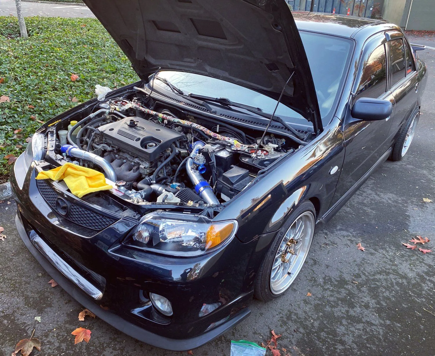

Hey guys, so I’m new to the community as far as forums go, I have owned my 2003 Mazdaspeed protege since 2015 and have been building on it for the last year. I bough it with the Split Second PSC1 030 controller installed and I’ve heard that it was supposed to come with an r232 connector but it didn’t and i can’t find anything on that online. I have the female usb flash port in my glove box and yesterday i downloaded the FMIC map from this thread. (I am currently running a CX Racing FMIC kit) and when i went to connect i realized that it is a female usb that i cannot plug into the laptop. My question is, is this a simple fix? Can i use a dual male usb cord to connect the flash to the laptop and run it or do i need a specific controller that will make this possible? Anything helps, thanks.

Take cover off of SSAFC by removing 4 screws. Plug 9pin port into SSAFC. Plug USB into laptop. :)

Ohhh that makes sense! So i guess the usb flash cord in my glove box is just there in the case the original equipment was all there like the r232 controller that it came with?
