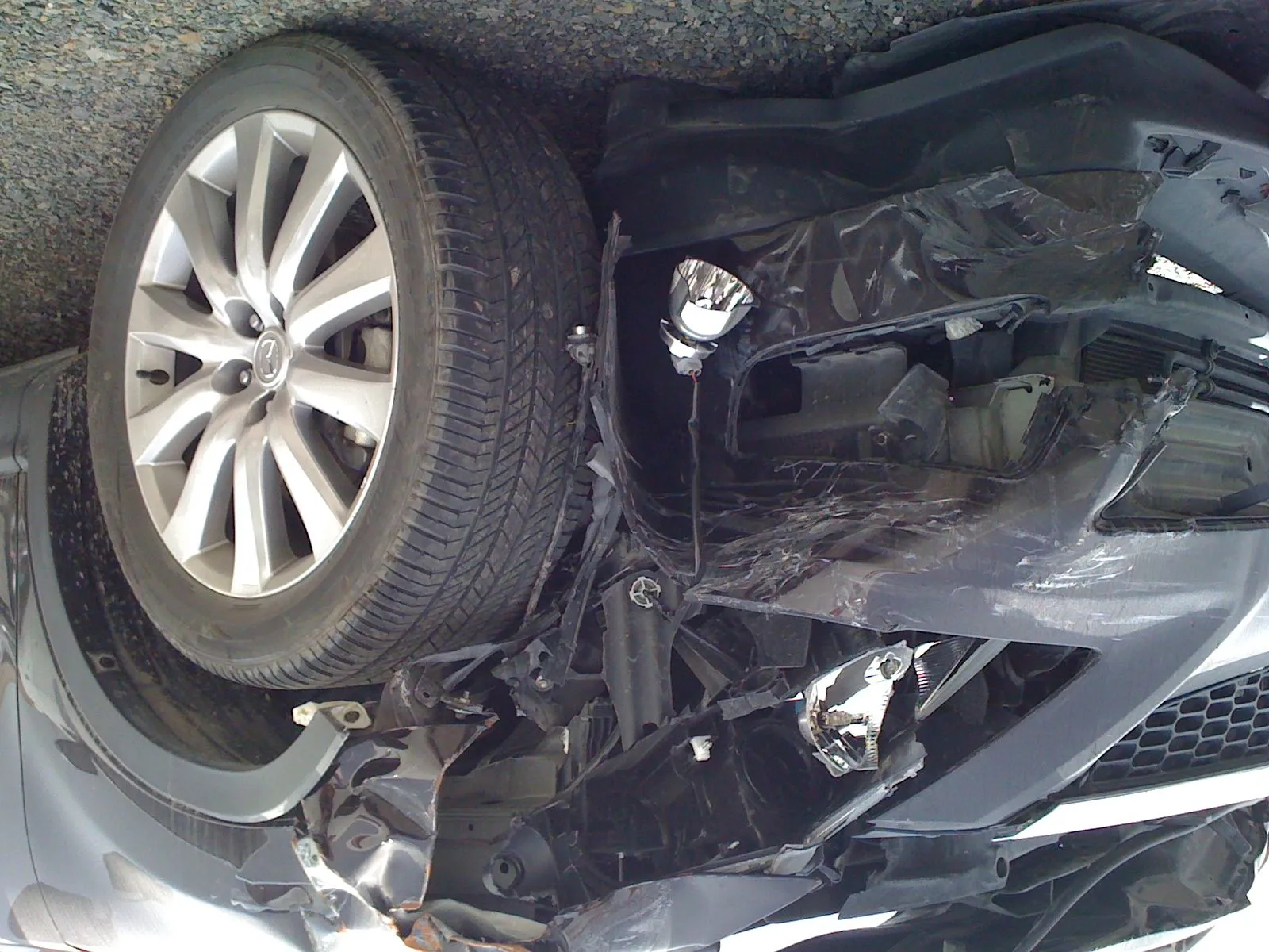

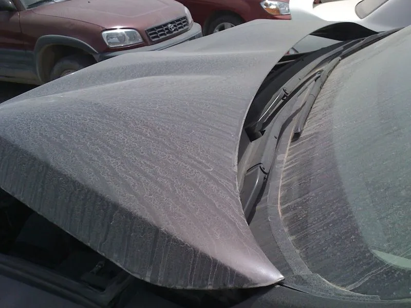

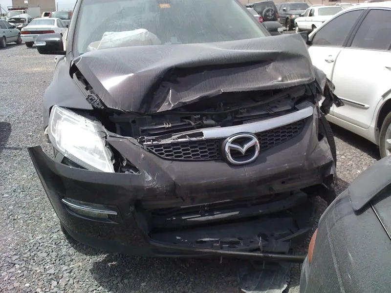

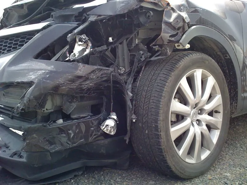

Hey guys, please can you give me information about the approximate expenses for fixing my poor baby?
Not to mention any estimate we'd even make in the US would be pretty much void in the middle east...
And, yea... why are the photos all upside down?
I agree. It is hard to estimate just by looking at the pictures.
Actually, my neck still hurts from looking at them upside down.
Hope no one was hurt in the accident.
sorry guys for this crazy turning of the pictures, don't know why it happened?!
I will bring it to a workshop, nevertheless I want to get a rough estimation because I'll have to wait for my damaged baby for six weeks to get it back, so in the meantime I want to get an overview before I bring it for fixing..
Its going to cost a ton of money for them to flip the car over right side up, thats for sure.....
(lol2)

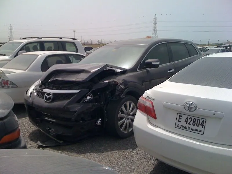

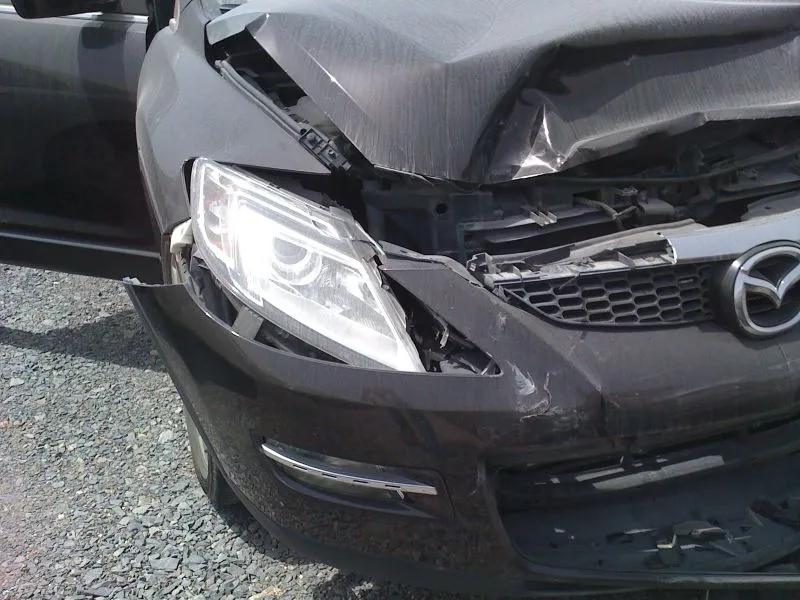

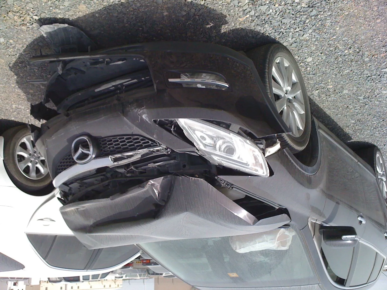

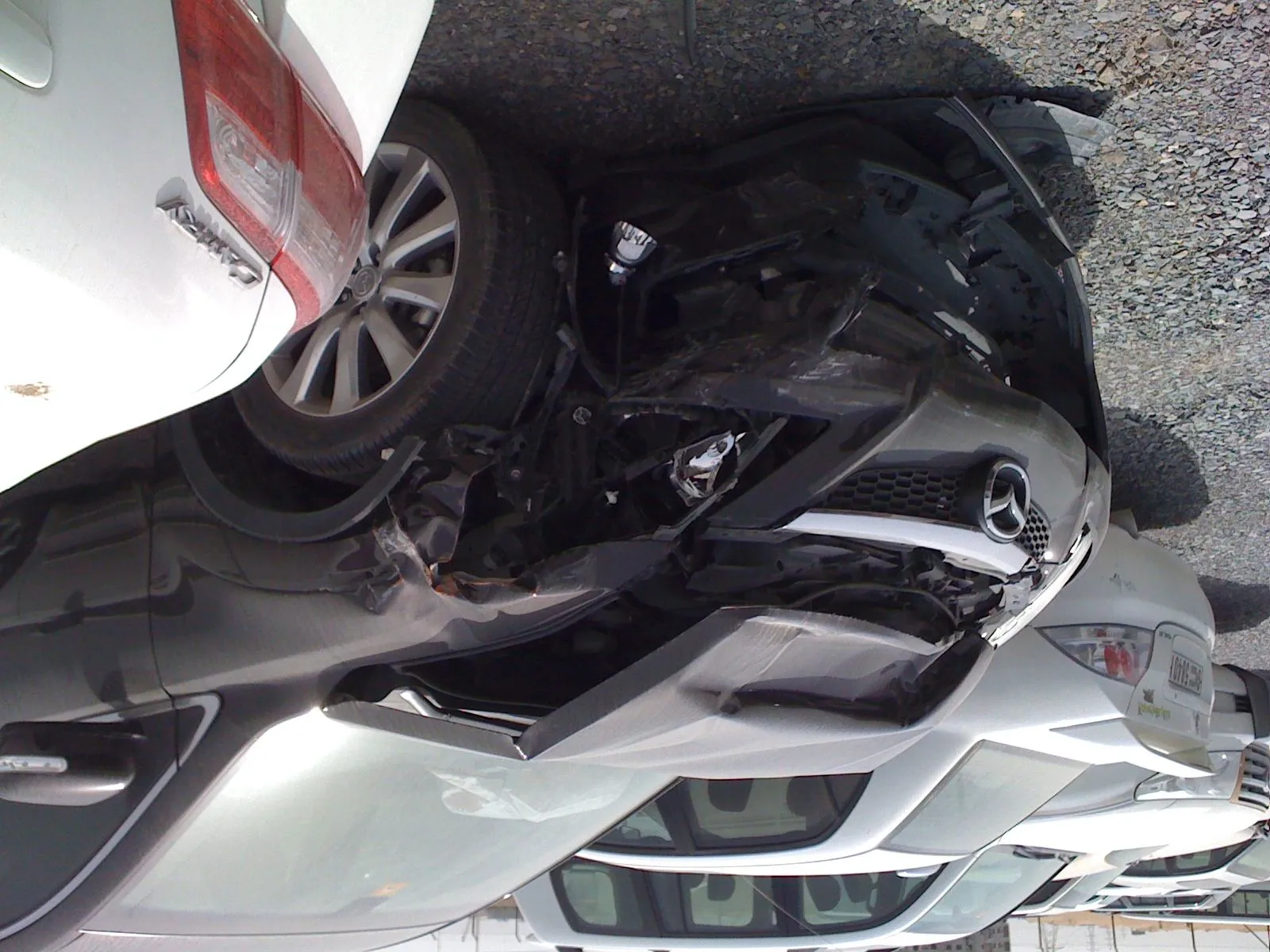

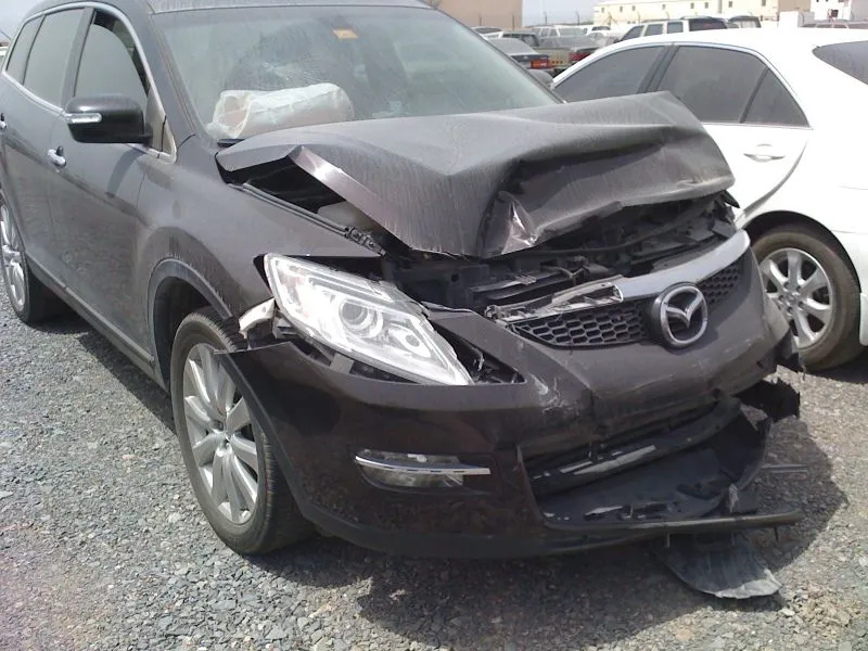

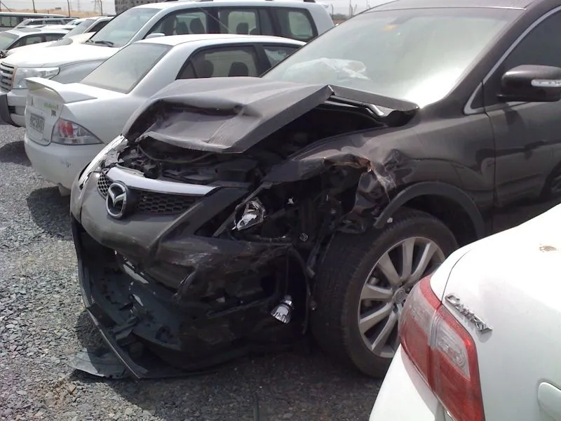

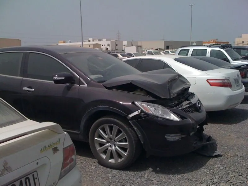

my goodness sorry again.. actually the axes seam to be unharmed (tire in normal position), like the chassis. even the engine area seams to be fine (couldn't open it - no time for that). even the stearing wheel is in it's normal position. so I guess only metal and the more expensive lights on the driver's side.

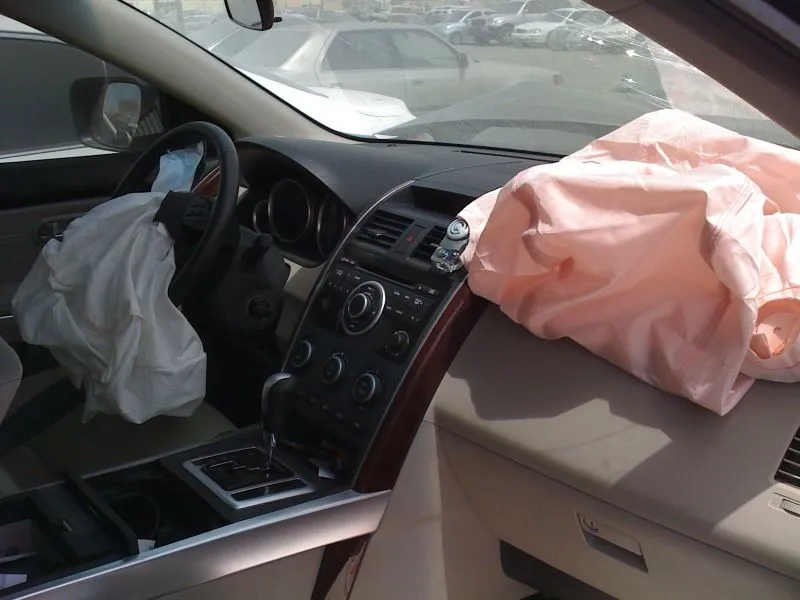

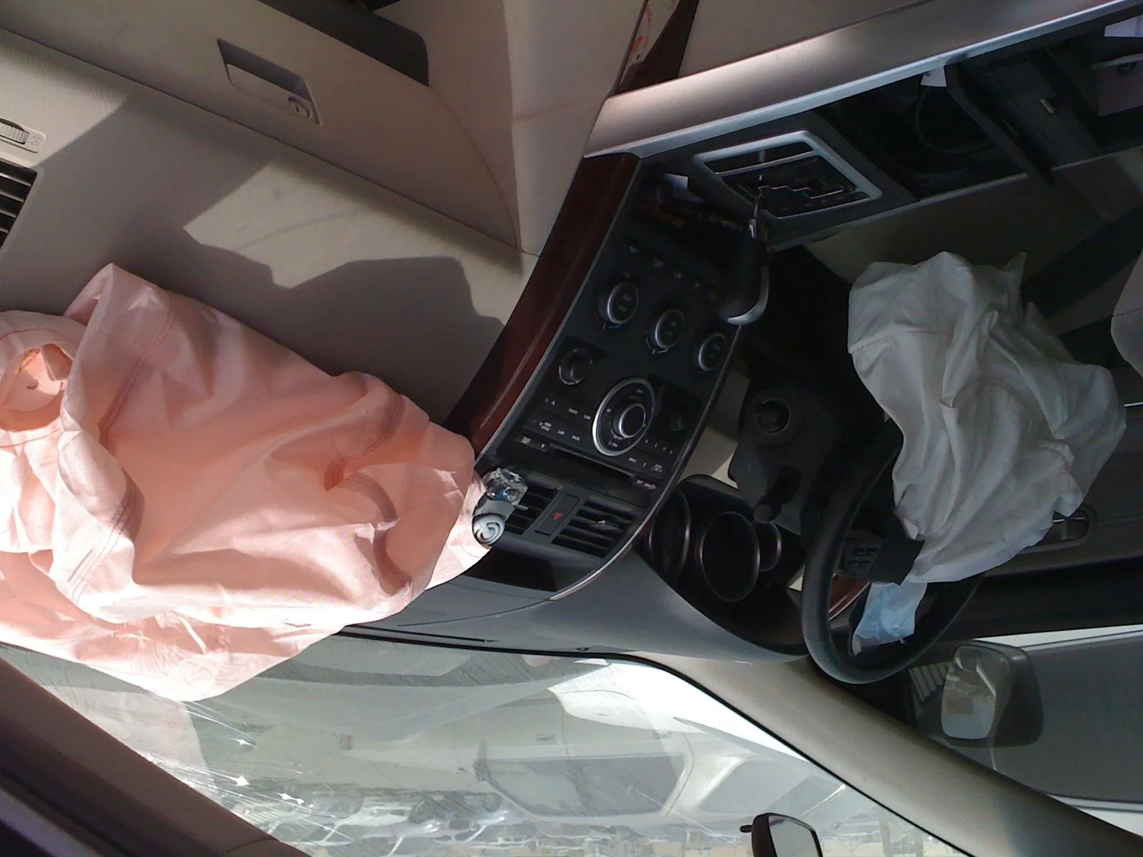

Parts that you will need for sure from a visual standpoint:
Bumper
Absorber
Reinforcement
Brackets
Misc. harware
Headlamps
Hood
Hood hinges
Hood latch
Grille
Fenders
Fender liners
Radiator Support
Airbags (both)
SRS unit (brain)
Seat belts
Buckles
Thx a lot guys, that's what I wanted to hear. If it's really $20.000 I can scrap it. F*ck..
And thanks for telling me the names of the parts in english. Will also help me a lot!
Sorry No way to know what internal damage was done, let alone know the cost in a foreign country. Shouldn't have been fiddling with the gadgets while driving, I guess.
Based on past experience, here it would probably be totaled by the insurance company.
I agree - Air bags blown usually means it would have been totaled here (and I would personally prefer it that way). Hard to get a vehicle to perform like new after something like that, even when done by the best mechanics / body shops.
