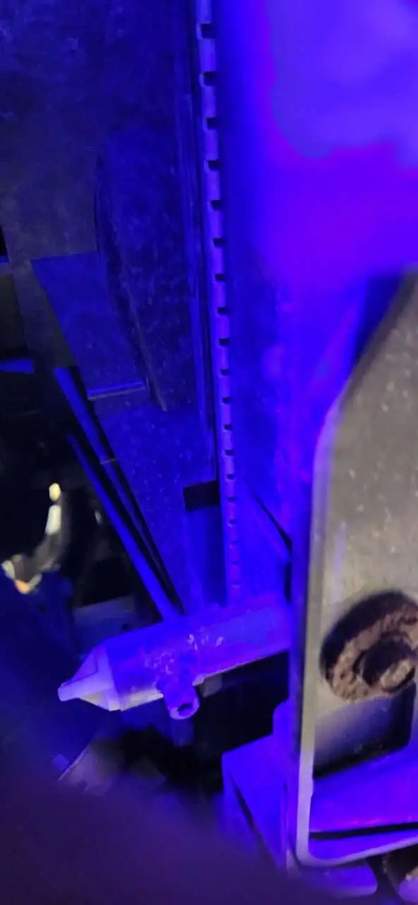

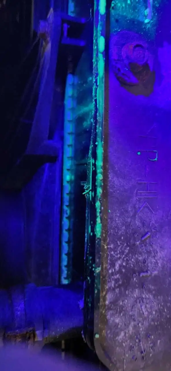

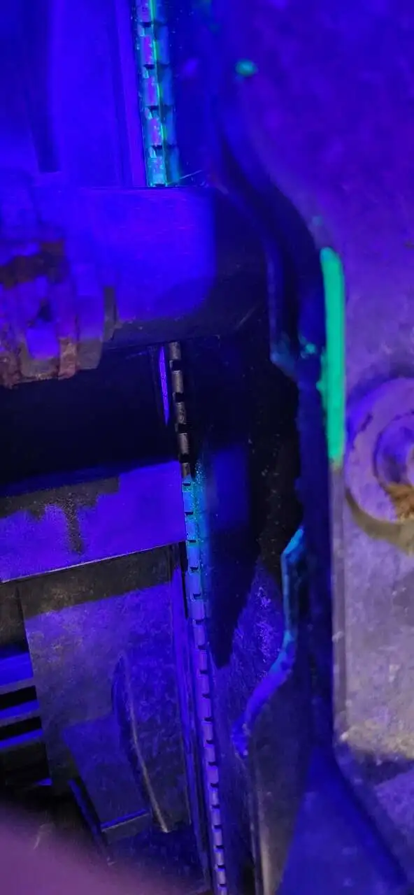

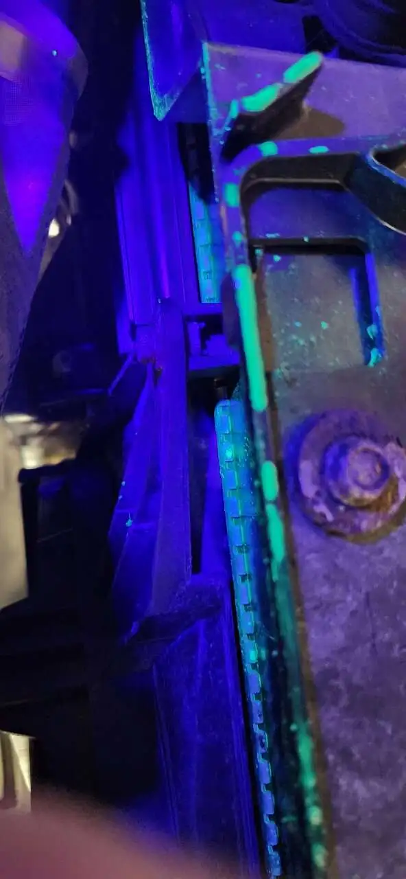

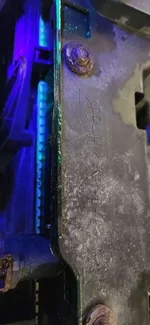

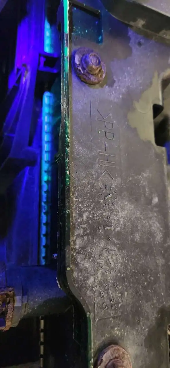

So I removed the bottom plastic trim under the radiator and using a blacklight, I'm trying to find a leak in my AC.
Some background info:
AC is blowing hot. It never actually got cold like my other vehicles throughout my ownership (since new).
This summer though, I'm actually melting. It worked before was compared to how it is now.
Anyways, when I refill will refrigerant+ UV dye, it goes in and when the compressor kicks in to suck it down, I can literally see the gas (mist) escaping (coming from a high pressure line) from somewhere after the compressor into the condenser. I took a few pictures of the bottom of the compressor. It seems to have UV dye throughout the bottom half of the condenser, passenger side. The bottom of the condenser on the driver side is completely clean of the UV dye.
Has anyone experienced anything like this before?
I tried looking through the grill from the top and bottom, from inside and outside of the engine bay. This is the only dye I can find.
Looks like the leak is at the bottom of the condenser, passenger side.
Is this normal?
Any thoughts, recommendations will be appreciated.
I'm looking to fix this myself, just looking for tips from you guys.
Note, a ton of the dye fell to the bottom of the plastic when I was feeding it into the L pressure line. (Why it's lit up like Christmas. Look at the bottom of the condenser)..
Thanks 🙏🏽

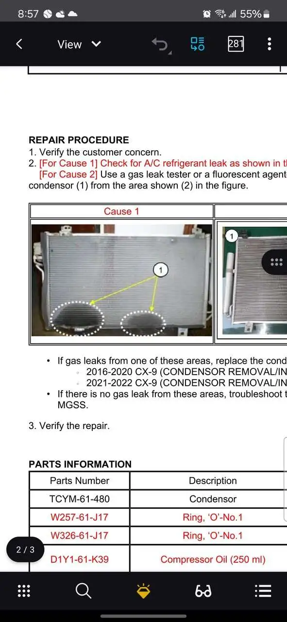

Have you looked at the condenser technical services bulletin. It shows the location of the common leak. I think it is at the bottom on the driver side where the tube connects
Link to another thread on the condenser leak and the TSB:
Post in thread '2016 CX-9 AC Leak (suspecting upper suction line)'
https://mazdas247.com/forum/t/2016-cx-9-ac-leak-suspecting-upper-suction-line.123880925/post-6799169
So it seems this is exactly my issue.
Looking at the link you provided and then navigating to the TSB, cause 1 is exactly the issue where my leak is at the bottom of the condenser on the middle and passenger side. (See attached).
How does this TSB work exactly? It's covered under their recall? Why did you have to pay $900?
Thanks 🙏🏽
A TSB is just a repair guide for the shops to reference, it's not a recall. If you find an issue under warranty they will fix it. Sadly most issues are found long after the warranty period has expired so your on your own.
Sometimes a manufacturer will 'good will' some of the cost. Usually only for people who service their car at the dealerships. Sometimes these common issues result in class-action lawsuits, depending on the number of affected vehicles.
