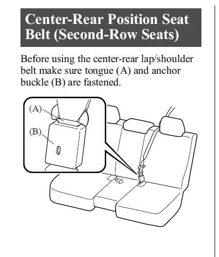

ok bought my car with the left rear overhead seatbelt (behind the 2nd row) inserted into the one seat belt receiver that doesn't have a release button on it. am i stupid but i can't figure out how to release it. any suggestions would be great. i'm ready to cut it off! :) thanks in advance!

You need to insert as small screwdriver into the little hole on the front to release it so it can be stowed in the roof "docking port".
See attached

I also was stumped the first time I used it: my friend's Honday Odyssey has a built-in slot on the belt that opens the latch, so I thought the CX-9 would have the same, but to no avail. Had to stick the key in there.
