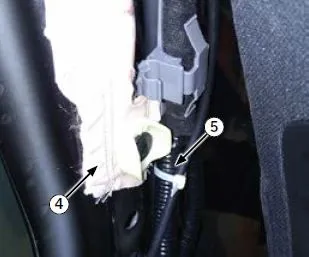

5. Run the dashcam wire from the headliner down the A-pillar, making sure that the wire does not cross over the airbag (4). I ziptied the wire to the existing wire loom (5) to make sure it didn't fall in the path of the airbag.

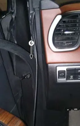

6. Replace the A-pillar cover (installation is the reverse of removal). Run the wire down to the footwell area, tucking it behind the weatherstripping (6) as you go.

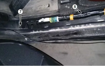

7. Using your screwdriver or pry tool (wrap the end in an old t-shirt or something if you want to prevent scratches), insert one end into the groove (7) and pry the step cover up. This piece is held on by plastic and metal clips. Once you get your fingers underneath you can easily pull it off by hand.

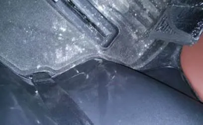

8. Open the rear door and remove the step cover (same as the front). Use your wire fish tool to pull the wire from the front to the rear. I found that I encountered less resistance by threading the wire along the right side of the wire loom (8).

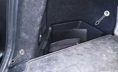

10. Remove the cover from the cubby, then run the wire around the outside edge of the cubby (9) and into the weatherstripping (10).

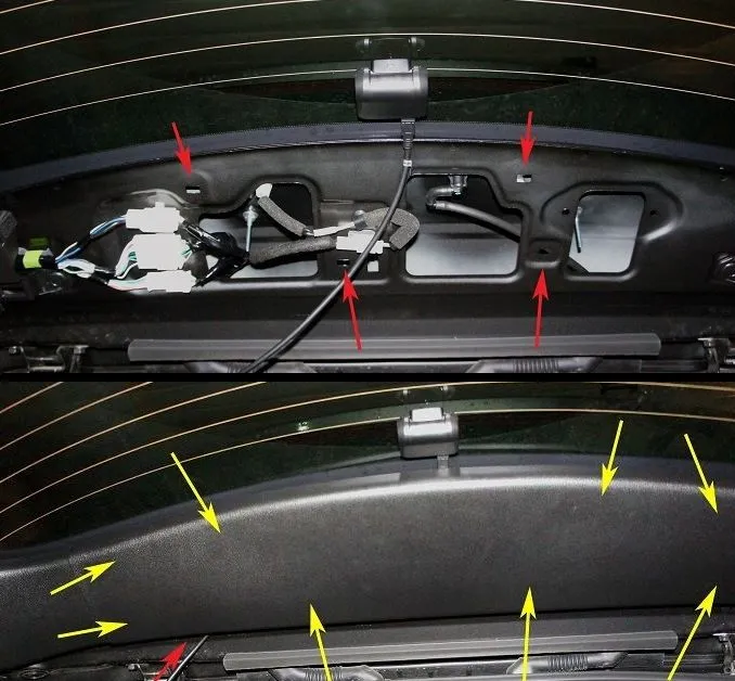

12. Remove the liftgate cover. This piece simply pulls right off, and is held in by metal and plastic clips. The red arrows show where some of the clips attach. Connect the power cable to the rear camera. Replace the liftgate cover by pressing down on the areas identified by the yellow arrows.

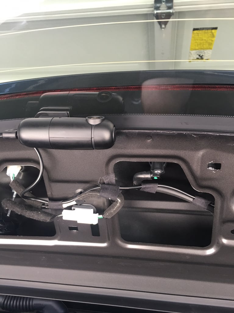

You can run your cable on the inside of headliner, that would free enough cable.
This is how I did it, and just secured with duct tape to prevent rattling. ( my setup is little different: Viofo 119S up front and Blueskysea in rear, but I ran power cable from the front this way):
Also I ran my cable through Right rubber boot, as it has more room due to only been used for rear window washer sprayer line)

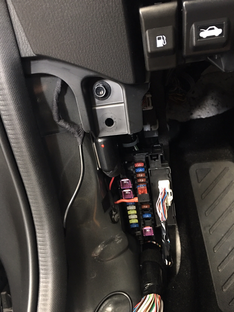

I did run power from fuse box ( used tap a fuse adapter), single 12V to 5V adapter, than spliced power cords for the front and rear dash cams, ran it up the pillar and secured to the inside of the headliner( one power cord for the rear all the way and one cord towards the rearview mirror).

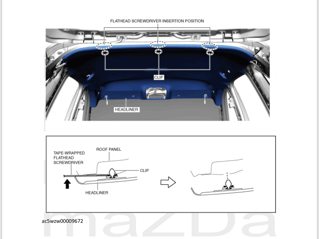

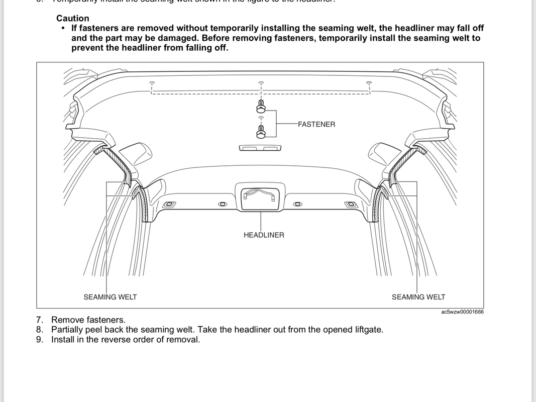

vitpk1, how did you remove the screw in the headliner (shown in this pic, with your index finger pointing towards the hole)? It looks like one of those fasteners where you use a flathead to lift the center, and the entire screw pops out, but I didn't see a spot to insert a screwdriver.

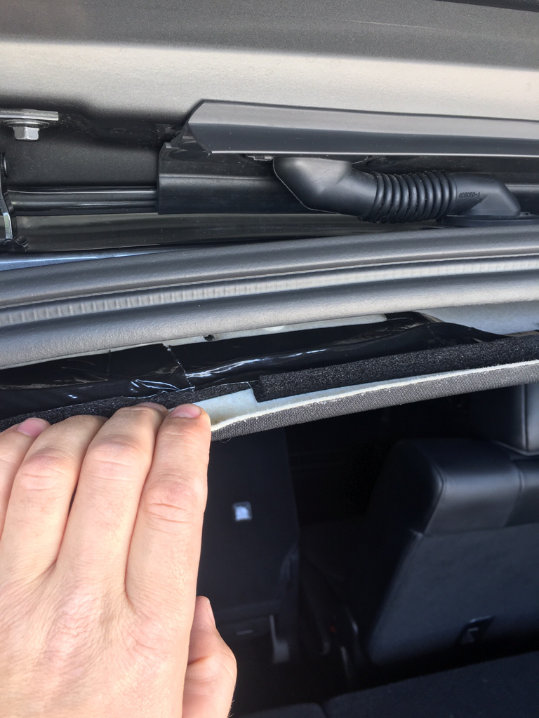

@sm1ke I copied your routing and managed to hide all the cables save for the bit that goes into the cam itself. For the B pillar if you pull back the weather stripping there is a gap that you can run the cable through.
I wish I knew how to pull down the headliner a bit. What I had to do was run it along the hatch weather stripping and then up towards the cam. I had to make a small slit to the weather stripping so the cable does not pull it upwards when opening the hatch.
You do realise that crossing the top of the A pillar is extremely dangerous? If the airbag isn*t torn apart if it needs to deploy then somebody is going to get maimed by the trim or the wire when it hits them in the face. It*s airbag failure, whipped with a severed wire or hit by trim at explosive speed, which do you prefer? The trim is tethered to the A post so that it stays in place but it has no option but come off as you*ve tied it to the airbag.
It is possible to cross under it safely but that trim has to come off to do it. The official Mazda way is to cut the tether and fit a new one but you can get it off if you are careful and reuse it. This shows you how but if you make a mess getting it off, just buy a new one. It*s not worth the risk.
Oops, no, Ive just realised youve done it again on the B pillar. The only safe way is to down under the doors and come up somewhere in the trunk. Ironically the legal reminders that you are interfering with the air curtain are clearly shown in the photos! If you run out of wire you can buy a 10ft extension off amazon or eBay.

You do realise that crossing the top of the A pillar is extremely dangerous? It is possible to cross under it safely but that trim has to come off to do it. The official Mazda way is to cut the tether and fit a new one but you can get it off if you are careful and reuse it. This shows you how but if you make a mess getting it off, just buy a new one. It*s not worth the risk.
Oops, no, I*ve just realised you*ve done it again on the B pillar. The only safe way is to down under the doors and come up somewhere in the trunk. Ironically the legal reminders that you are interfering with the air curtain are clearly shown in the photos! If you run out of wire you can buy a 10ft extension off amazon or eBay.

To get those trim clips out you just pop the centre part out with a small screwdriver and then the main body of the clip will just fall out.
The headliner clip I'm talking about doesn't have a center part that can be popped out with a screwdriver.

I*ve found this in the file for the US CX5. They are concealed Clips that you pry down with a screwdriver.
Curiously the European model has the two part clips. It seems hard to believe there are two versions but I*ve had my headliner down for the same reason and the definitely are........
Ah, thanks for that image, that helps a ton. Have you dropped the headliner in your CX-5 before? I wonder if I can get enough room to fish the wire through, just by removing the clips and supporting the headliner..
Sorry for the late reply. I have but mine has the two part clips. I didn*t come from the front because I have two independent cameras so I came from the rear trunk power supply, around the door frame and then into the umbilical like you did. I would add that for euro models of either the 5 or 9, that if it has a digital (DAB) radio, use a screened cable and go through the left side umbilical as in your tutorial as the antenna goes through the right and it will otherwise stop it working.
