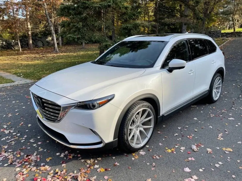

Ah, yes, I think it was just the angle and the way the light hits the wheels in the picture.
My 285 don't look as stretched as yours do, but I think this comes down to the manufacturer. Some tires stretch differently than others. You can see mine in the first pics I posted in this thread.
Pirelli Tires SCORPION ZERO AS PLUS Size: 285/35/22
Asanti Black Custom Wheels ABL-12 Size: 22x10.5 Finish: SILVER CARBON

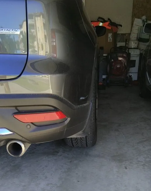

I have 22x10.5 +30ET wheels mounted on 285/35/22 tires (same specs as the one quoted by dougal). I took pictures with this setup installed to see how much clearance I had front and back. I posted them in my "build thread", but here are the photos.
Front:
attachment.php
Rear:
attachment.php
Note how close the front tire is to the spring perch and the shock body. I would estimate maybe 10-15 mm of clearance between a 22x10.5+30 wheel and the shock body. Technically a 22x10.5 +40 wheel would fit, it would just sit 10 mm closer to the shock body.
I would not risk going any larger than 285/35/22 for the tires. They may rub against the spring perch, especially if you go with a 10.5 +40 wheel.

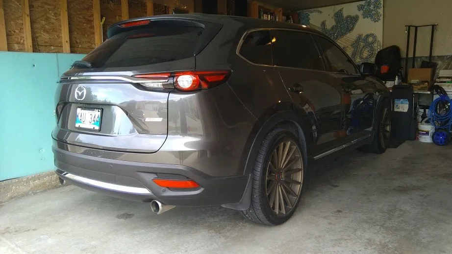

I think it would work just fine. The only real "problem" I have now is that the car gets dirty a little faster because the mudflaps aren't wide enough for the wheels/tires. I actually put a pair of 5mm wheel spacers on the rears, so the rear fitment is actually more like 22x10.5 +25. Here are a couple of old pics:
I'm on stock suspension, so no rubbing on anything. With +30 fronts, I have no rubbing or clearance issues. I'm able to make full-lock u-turns no problem. I don't know if 5mm will make any difference up front, but I don't think it will. I think worst case scenario, you might slightly rub the plastic fender guard if you take a sharp turn and hit a pothole in the middle of the turn (pretty rare situation IMO). Same thing would probably happen with +30 up front. I would go for it.
