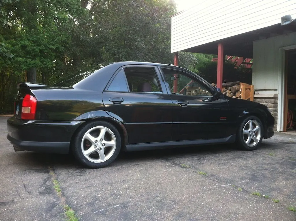

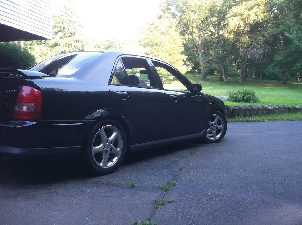

so, here they are... (don't mind the condition of the car)
so far, they ride well. comparing to the 215/45's on the FD wheels, they have decent response. ride well, good handling, responsive enough.

I ran 205/45 on my stockers for the longest and had no issues with them! Also, what is your protege lowered on? Im about to go back to just lowering springs since im driving farther to work now and going to to sell my KSPORT coilovers. I'm trying to get an idea of what my car will look like with just the lowering springs and FD wheels.
i have the tokico HP handling kit. the front could stand be a touch lower, but i think it looks ok.
