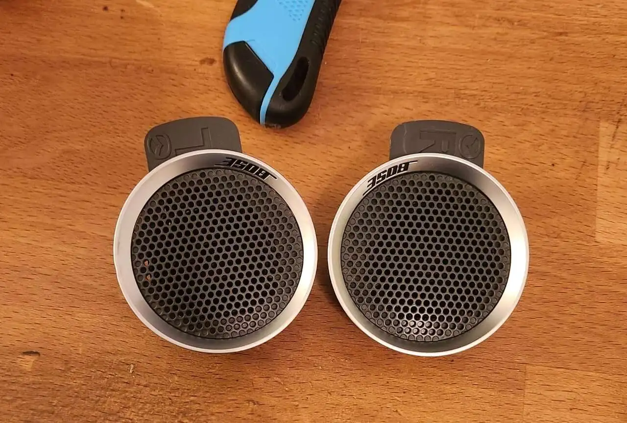

So I bit the bullet.
I acquired 4 bose speakers of a 2019 CX5
2x Tweeters (A Pillar)
2x Front Door Speakers
2X Rear Door Speakers (From a different mazda)
Now, IM NOT an acoustician.
The OEM speakers in my car were good, clear, details were audible.
My issue with them was They didnt sound Full or Loud. Like there was something missing with audio.
I had to crank up the volume to 50 and up to feel the audio.
On a bass heavy track the entire door would vibrate and bass sounded boxy.
Bose
The sound is definitely louder. Hitting the volume to 40ish.. everything is more than audible.
It sounds fuller (hard to explain) but it sounds better.
Question is how much better?
I guess about 15-20% better than audio on oem speakers.
Why Bose and no other?
Some other options needed splicing of the wires for connection.
Bose-Mazda speakers were simply plug and play.
I spent 5 mins for A & B Pillar speaker replacement.
and approx 10-15 mins per door.
Would I recommend ?
No.
I spent around 400 USD (approx in the local currency here) for some used speakers.
After the swap the audio experience is much better but not what I Expected.

I was curious about this swap too. The stock amp will play 2ohm speakers just fine. I liked the NA audio just fine after tuning the EQ, but it's not loud enough. For me it stops sounding clear after volume 35.
Exactly.. even at 45 Though loud.. It wasnt filling enough.. had to crank it up further. The bass was just bad at higher volume.. had to set it to -2 to -3.
After the swap its much louder and fuller as well as clearer. Now I dont usually go beyond 40ish on vol.
Not sure How do I adjust the EQ.
Adding a DSP will help boost the performance of your existing upgraded Bose further, I'd say at least another 30%, well that's what I felt from my own experience anyway by having the same setup like you, but just DSP adding on top of everything. The plus side is that the TAU (stock Mazda amplifier) is easy to access and everything is plug and play.
