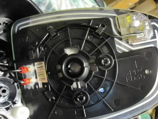

My CX-5 has blind spot monitoring, and this is the wire for that. Note how it is held in place with clips on the backside of the mirror glass.

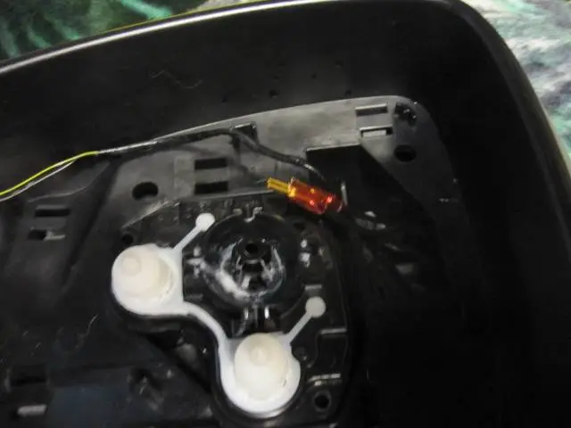

This is just a shot of the inside of the mirror housing. The white knobs are the power mirror adjusters.

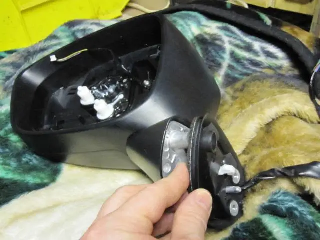

At this point I took the mirror housing indoors to work on. Make sure you have a soft surface such as a blanket or towel to work on or you will probably end up scratching the paint on the mirror housing.

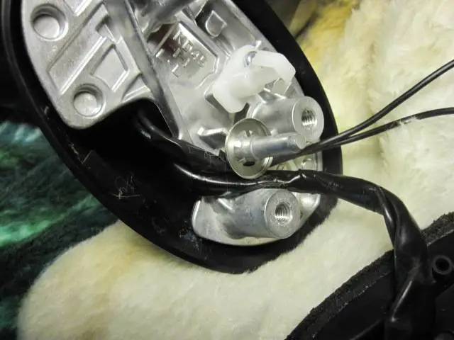

Peel this rubber boot back and you will be able to see where you need to push 2 new wires through. I could have and maybe should have routed the wires inside of the factory wire casing, but there seems to be plenty of room for new wires, so I don't think they will get pinched as long as you are careful. I also added additional electrical tape as a precaution at any points where the wires contact metal.
I took out the 3 screws holding the power mirror motor but did not remove the connector on the back. I only did this to improve light/visibility inside the housing when running the wires. The wires you run will come up through the big opening at the top of this image.

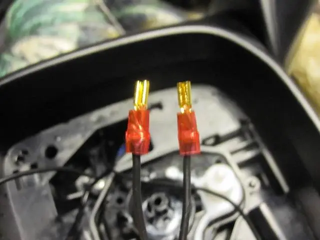

Strip around 1/2" from the end of each wire and attach the female connectors.
Once they are on, pull the wires back out until there is just enough wire inside the housing to allow for full range of mirror adjustment when back on the car. On the other end, cut one of the wires about 6" longer than the factory wire bundle and the other one about 6" shorter than the factory wire bundle.
Route the wires as shown, in the same manner as the factory wires. This is a good place to add additional electrical tape for protection.
Connect all the wires and run the BSM wires back under the retaining clips. NOTE: The heated mirror wires do not matter which is positive/negative. Put them on either way and it will work.
Pop the mirror back in place by pressing firmly first in the center until the main ball pops in, then press the side to pop in the adjuster and repeat for the bottom. This part can be nerve racking, but study the clips, take your time and have faith. It will pop in if you do it right.

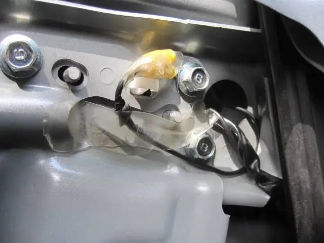

Replace the mirror housing and run the wires back the way they were originally through the door. Only run one of the wires around the window track. The other will be explained below. I ran one of the new wires first because it was easiest and then taped the factory bundle to that wire and pulled it though.

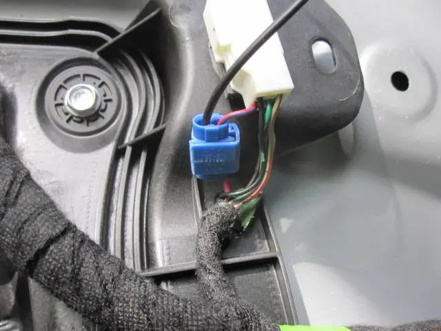

For a ground, I suspect there is one in the same bundle as the red/purple power wire, but I prefer to ground it to the door. I cut the shorter of the 2 new wires to be just long enough for this purpose, then used ring terminals and scraped the paint down to bare metal around one of the mirror housing bolts. I then used a little electrical tape to secure the wire out of the way of the windows path. The picture is ugly, but it looked better in person once I got it all secured.
You can now use one of the splices to connect the other new wire to the red/purple wire as shown.
Another angle of the same wire.
You can now test the mirror by powering on the car and pressing the rear defrost button. You should feel it starting to get warm after a minute or two. You can also 'huff' on the mirror and you should see it clearing away the fog quickly. I tried to capture this on camera but it happens too quickly to get a good picture.
