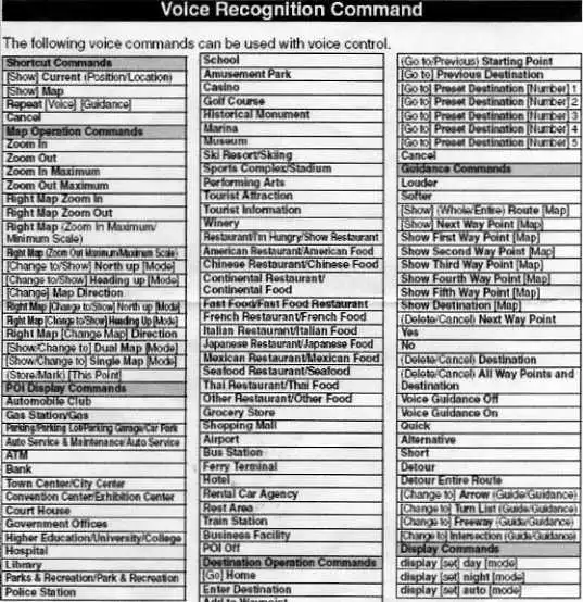

I did have a table of all the verbal commands it recognizes.
I have to dig it out. Haven't had much interest in using voice command after the
initial few days....Very bad recognition.

A few of the commands from the Quick Start guide. (more in the NAVI manual)
“Repeat” “ATM”
“Zoom In / Out” “I’m Hungry”
“Voice Guidance Off / On” “Airport”
“Detour” “Shopping Mall”
“Rest Area” “POI Off”
“Gas Station” “Cancel”
“Hotel” “Enter Destination”
“Hospital” “Go to Preset Destination [#]”
“Police Station” “Go Home”
“Display Day” “Display Night”
“Show Map” “Turn List”
List of voice commands
Found the table I have.
Enjoy.
The last line of the middle column is
"Add way point"
The scanner trimmed it off for some unknown reason.
Those who don't know BNR format,
[...] means "optional"
