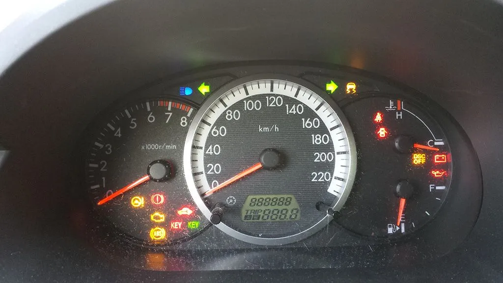

In addition to my question about the part number: Can someone tell me where the cruise control indicators on the dashboard are located? If I run test mode 26 all dashboard indicators light up, but I don't see any cruise control indicators. ("Cruise main" and "Cruise")
Does this perhaps mean that my car does not have pre-programmed cruise control? If so the buttons and brake switch I bought will be useless whilst somewhere else on the forum I read that all 2006-2009 M5's should have the preprogrammed CC :-(
In the meantime I figured out that in my 2006 M5 the DSC lights are on the spots where the Cruise Control lights are supposed to be. On a Cruise Control equiped car the DSC lights are on a different location.

Wonder if a European Mazda5 owner can take a picture of the cluster in test mode to see all the lights on - then post it here.

Regarding the instrument cluster, this is mine, a 2006 1.8 Exclusive Sport from Germany (imported into the Netherlands):
attachment.php
(ignore the dust, I need to clean out the car ;-))
