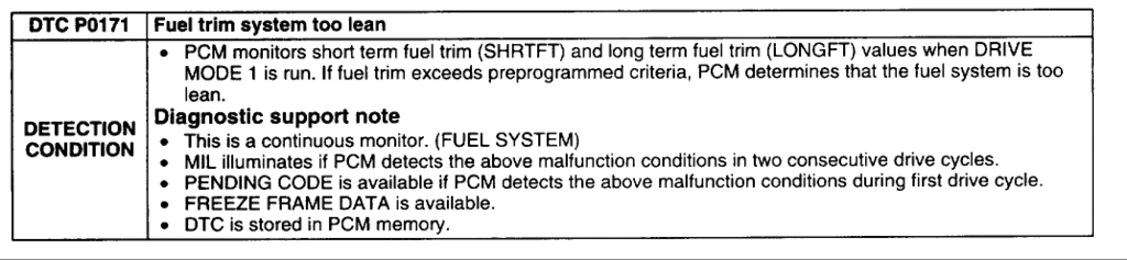

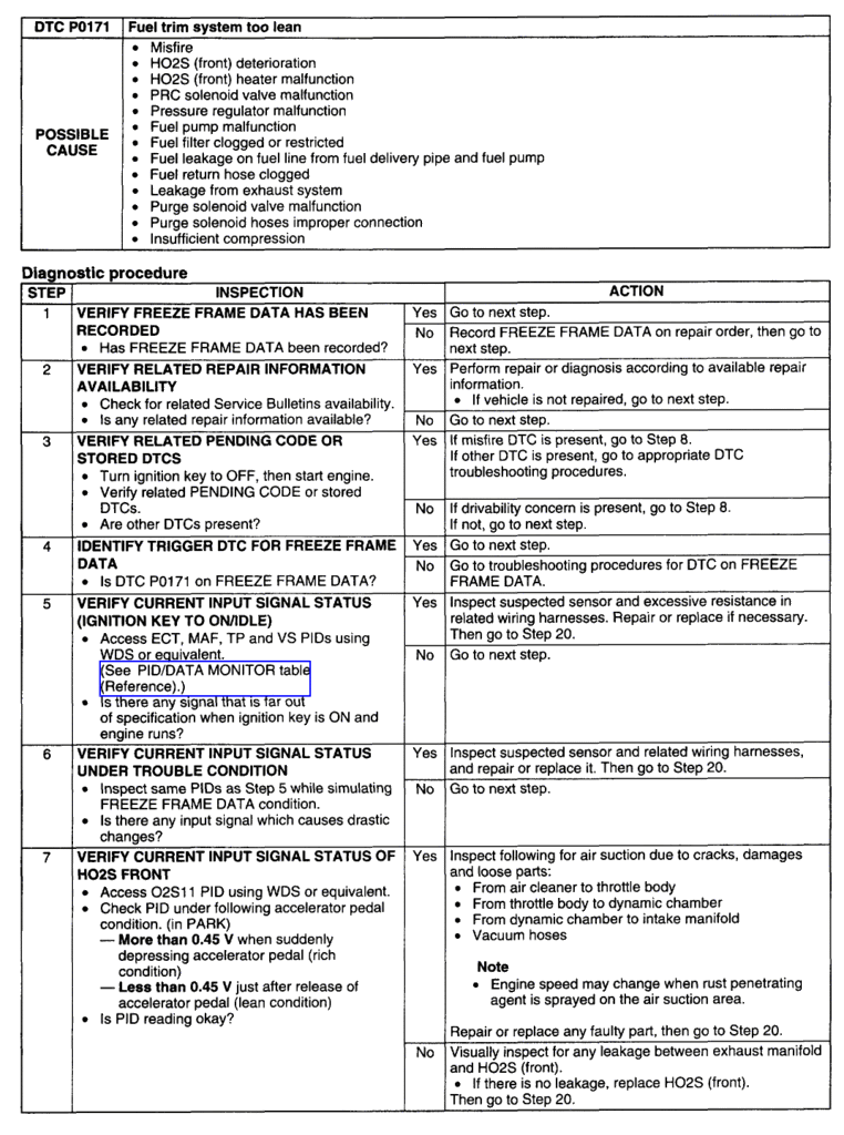

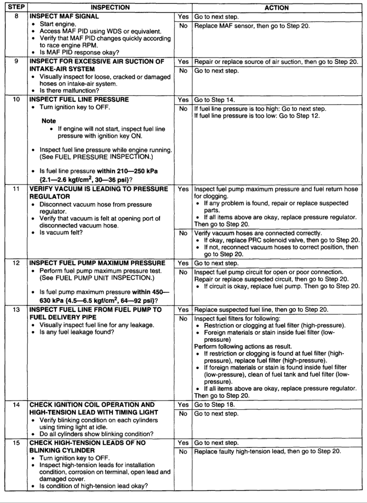

Hey just wanting some help on the P0090 code... I figured that the to lean could be the crack in my turbo mani... But I guess my question is are those two codes related? I did a little research and found out that it code possibly be a dirty fuel filter, fuel pump, and or a fuel regulator... Am I on the right track with this code or do you guys think it's something else... Thanks
