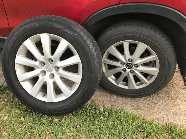

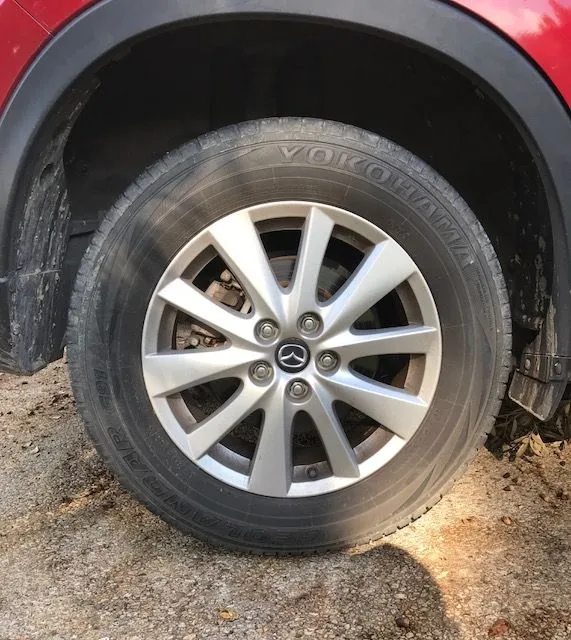

I went and got the wheels today. Couldn't pass them up at that price. The tires look like the middle tread areas are worn more than the outer areas. Maybe over inflated and driven a lot that way? The tires are Yokohama YK580s. Pics...mostly to see the CX-9 18" wheels in relation to the CX-5 17" wheels...attached...I think/hope.
Understood about keeping the outer diameter close to stock to keep speedo accurate. I'm not concerned if I go with a little shorter sidewall and end up with a speedo that's off a little bit. We'll see how it works out when I buy tires. Also understand I will have more weight at each corner of the CX-5. The CX-9 wheels will probably be a temporary thing until I can get some decent lightweight wheels. 90% of my driving nowadays is in the city so the weight penalty won't be felt too much...I hope.

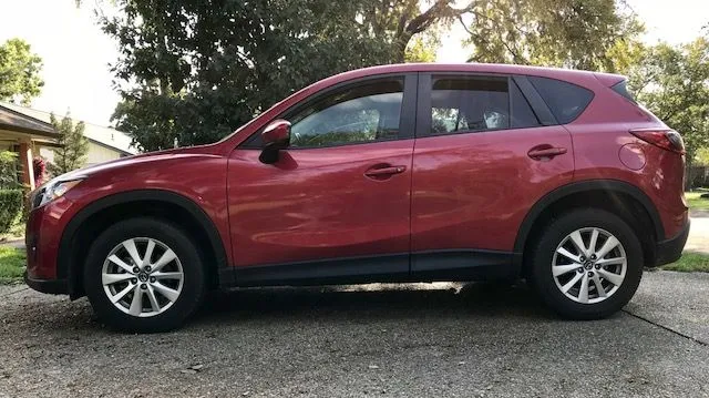

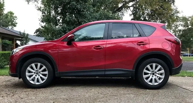

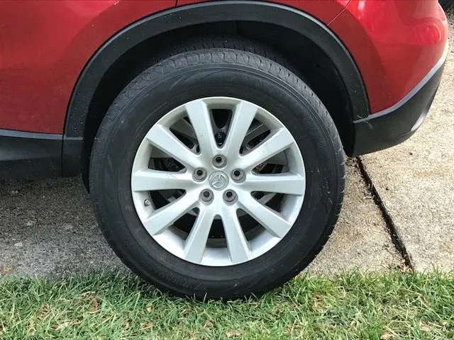

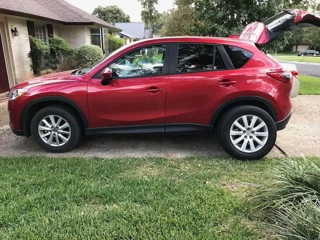

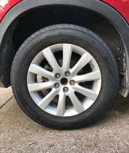

I cleaned the "new" 18" wheels this afternoon and put them on the CX-5. All seems good and no rubbing or trouble with the 245 tires that are on the wheels. Not sure I can tell any difference in the ride feel but I've only driven about 8 miles so far. I need to double check tire pressures tomorrow. I like a couple of PSI over what Mazda recommends and I think the tires are currently right at spec. Might need to add just a couple of PSI...not enough to cause wear issues.
Hopefully the pictures (if I've added them correctly) will show the before and after...stock 17" wheels versus "new" 18" wheels. I can tell the difference but most folks wouldn't even notice.
