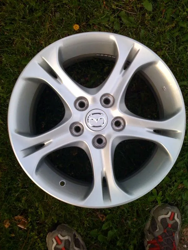

Got the wheels. I think they look pretty good and seem to be in good shape.
I was considering going with something cheap, possibly even just steel wheels, for the winter setup, but these will look much better than that.

wow...i had no idea that they made a 16" rx8 rim. regardless, you should be just fine with them. the stock offset is 52.5mm, so 50mm works out very well.

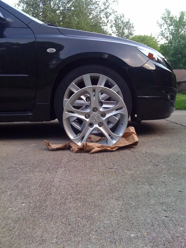

I've been meaning to put one on just to make absolutely certain that everything fits right before I buy tires for them.

Looking good and it will only take a few minutes to check fitment so....and get used to the 'non-believers' lol. Almost everyone has said the same thing 'they made 16" RX8 wheels?'.
Here they are on the wifes car with the stock 205/55's but thanks to them being 7.5" wide I'll be mounting some 225/50's in the future. :)
