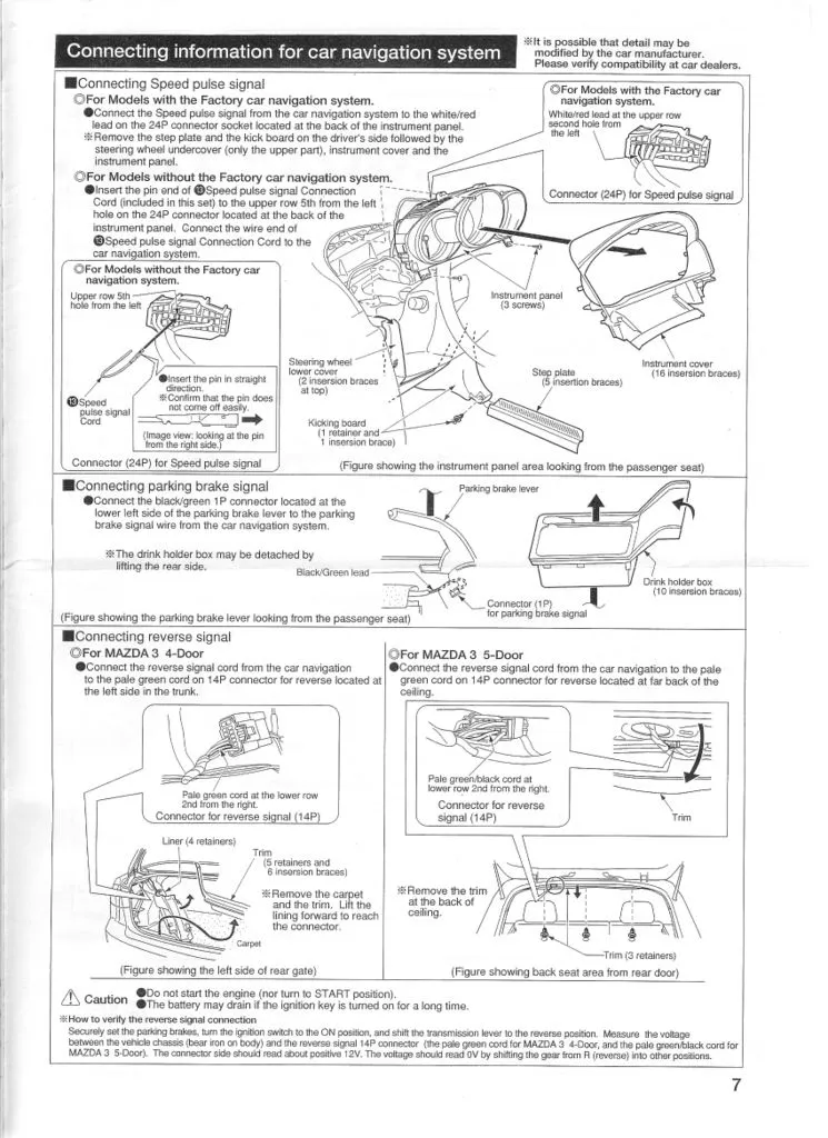

Are you sure you're getting the pin (if you're using one) into the harness fully? I have a pioneer avic-d3 and it gets my speed and rpm from the harness in the instrument cluster just fine.
Here's a picture of where the VSS wire is located. People keep asking for this, this picture should really get stickied so people don't have to constantly ask where it is.

I already have that diagram and I've already tried that slot. I have a '07 Mazda Speed 3 GT without NAVI. I tried plugging in the speed signal wire into there and got no reading. But thanks for your help anyways.
