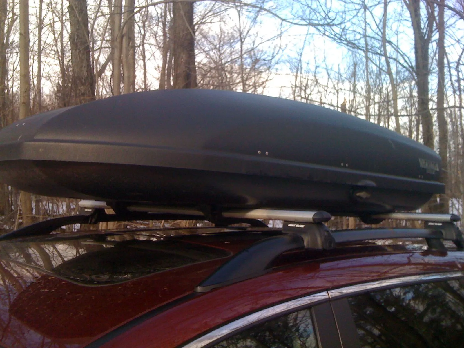

I suspect it is more that you can move the front bar further forward as that is what caused the problem with the factory crossbars. The adjustments on the factory rack and factory crossbars does not allow you to get within 6-8 inches of the front pillar due to the way the slotted assembly of the side rails works. The MB, Thule and Yakima racks either use pillars rather than the Mazda factory side rails and the pillars are mounted further forward than the most forward position possible with the factory set up. If using the factory rack, the MB, Thule and Yakima crossbars mount on top of the rack rather than in the same slot as the factory crossbars. In either case you can get the front crossbar mounted further forward than is possible with the factory rack plus factory crossbar combo.

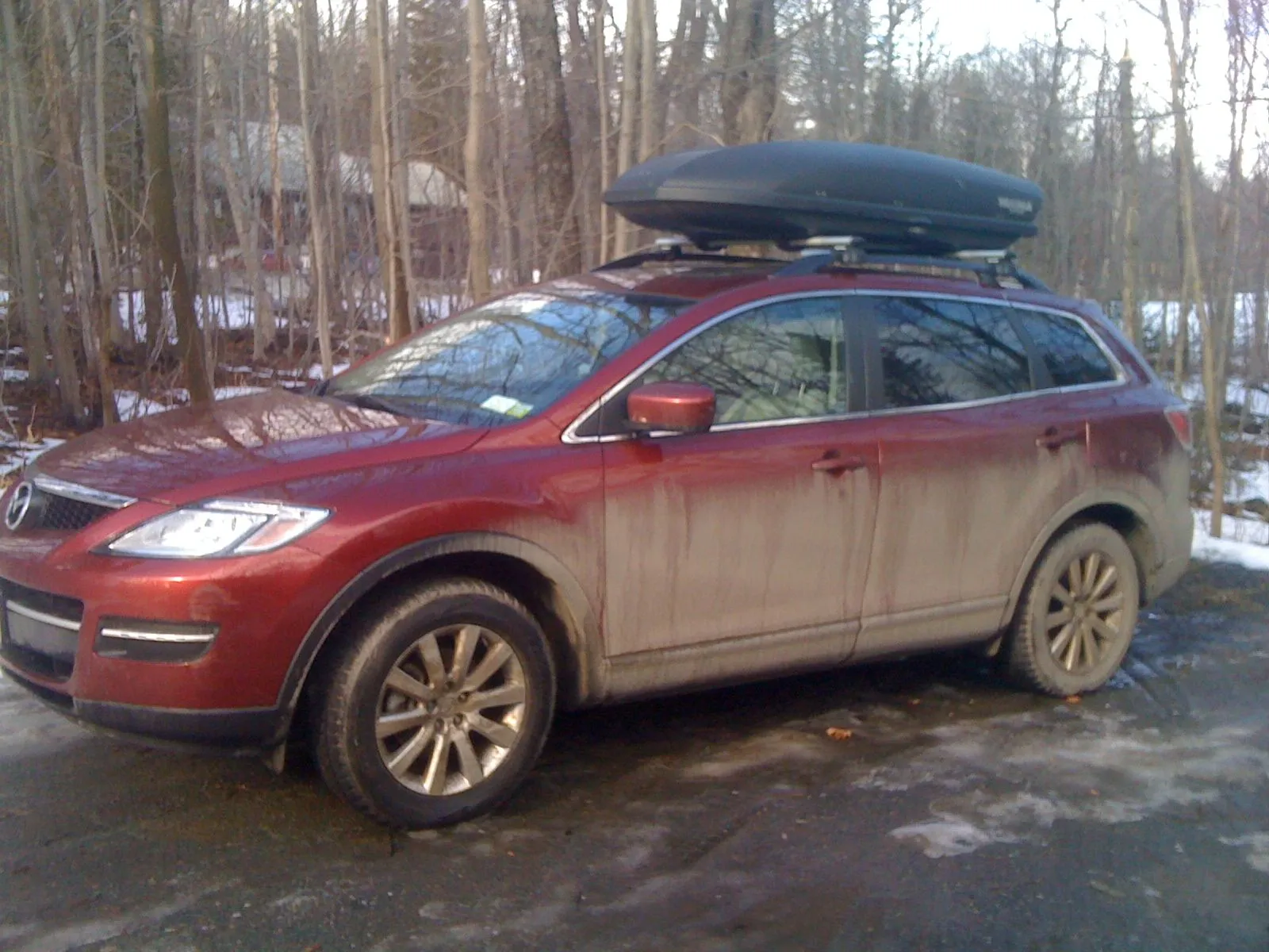

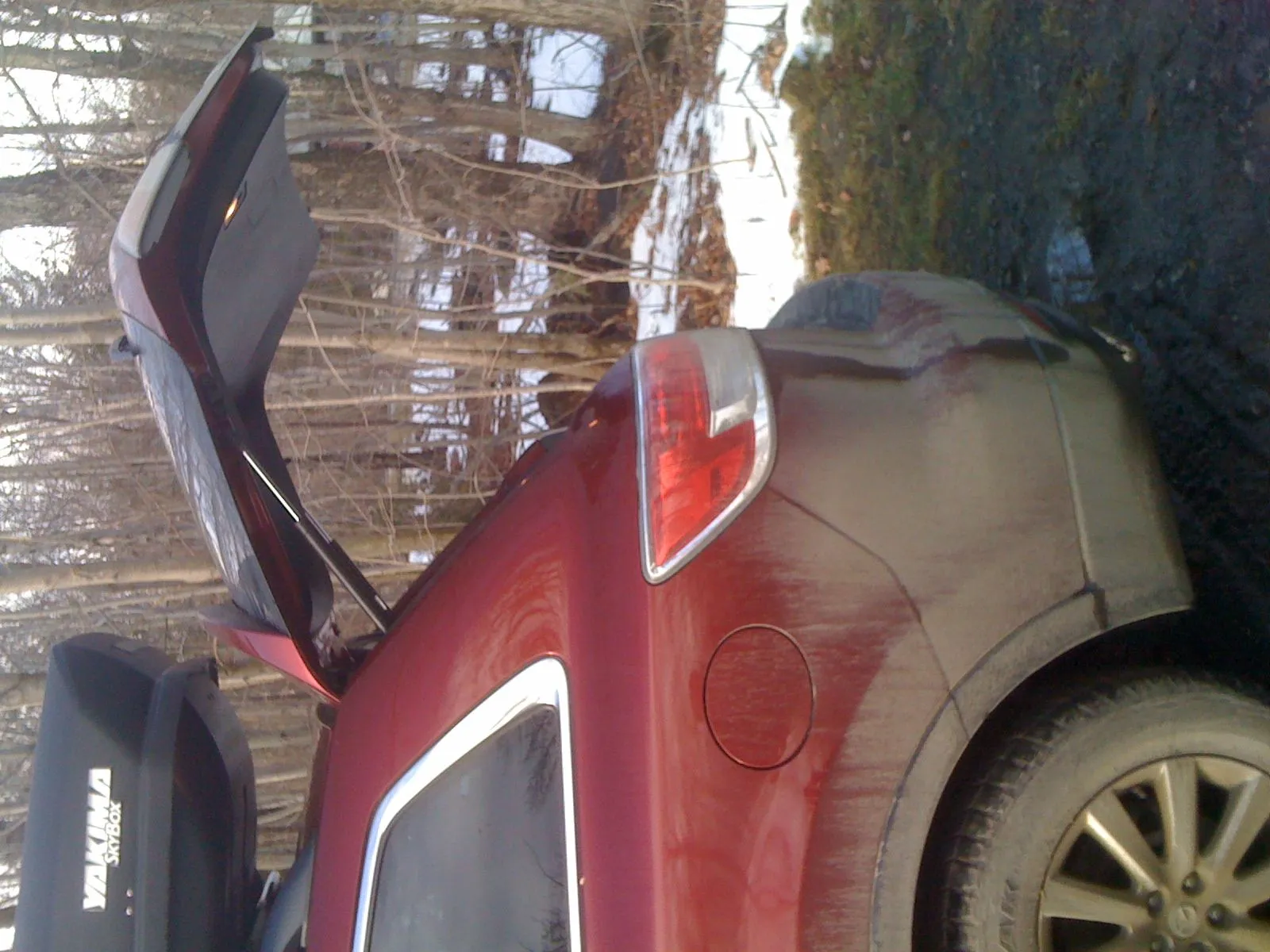

CORRECTION: My box is actually a skybox 16 which is about a foot shorter than the 19 and might explain why I have no problem with the tailgate. I'm attaching some pictures of my setup: factory rails, mont blanc crossbars and yakima skybox 16.
Sorry for the dirty car but it was a messy week in VT.
