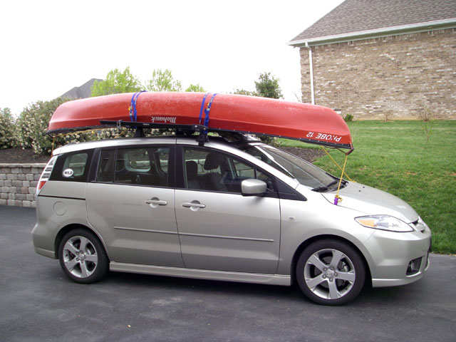

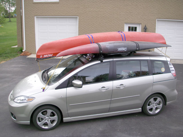

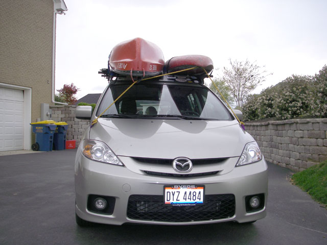

Just wanted to post some first hand experience with Yakima racks on a Mazda5, since I had a hard time finding such info myself.
The clip/tower combination works just fine. You need to tighten them very slowly, alternating from side to side, to avoid interference with the sliding door - what Yakima calls 'fine tuning'. This slows down installation by about 10 minutes but is very straightforward. If you like to remove your racks regularly, this could get old. In our case, we use the racks enough that they stay on all the time. Once on, the towers are plenty secure. I mounted an old Thule fairing on mine - the current crop of fairings will interfere with the sunroof. Wind noise is noticeable but not terrible. The car gets between 22 and 25 mpg on the highway with gear up top, depending on other conditions like wind, what kind of gear, etc.
Here are a few pics of the rack in use:
