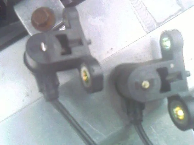

* If I give it gas, the car will move like there is no issue, but when I come to a stop, or idle it stalls out. I had a lightwieght crank pulley on the car and the screws on the timing tooth wheel backed out and started smacking against the crank sensor(which is what the loud chattering noise was)
* As I mentioned be4 the car drives like there is no issue, but i wont hit full boost(7psi) till about 5500rpms....keep in mind it is running a gt28rs with an upgraded compressor wheel....
Diagnosed so far:
* After inspecting the crank sensor I figured the timing tooth wheel that kept chattering against the crank sensor, I figured the crank sensor was ******. So I removed it to compare with a working crank sensor(Thanks mryellerp5).....and visually you can see it was messed up(See pic). I replaced the stock crank pulley, and am using the other crank sensor. After replacing car will start up a bit quicker, but eventually slowly stall out. It will start up and idle fine, but when I turnoff the A/C the slow stall is almost instant. With the A/C off the car struggles to turn over.

Try putting another crank sensor in there. You said you replaced it and noticed a little change. Was it shipped to you or did yeller hand deliver it to you? If it was shipped maybe it was damaged but is still better than the one you pulled but not good enough.
Is there maybe a damaged fuel line or sensor or something back around the endlink that was replaced. It might be a dumb suggestion, I don't look back there very often.
I went to Yeller's house to pick it up. He is quite meticulous about the way he takes care of items. I wouldnt think twice about something happening with the sensor while in his care.
